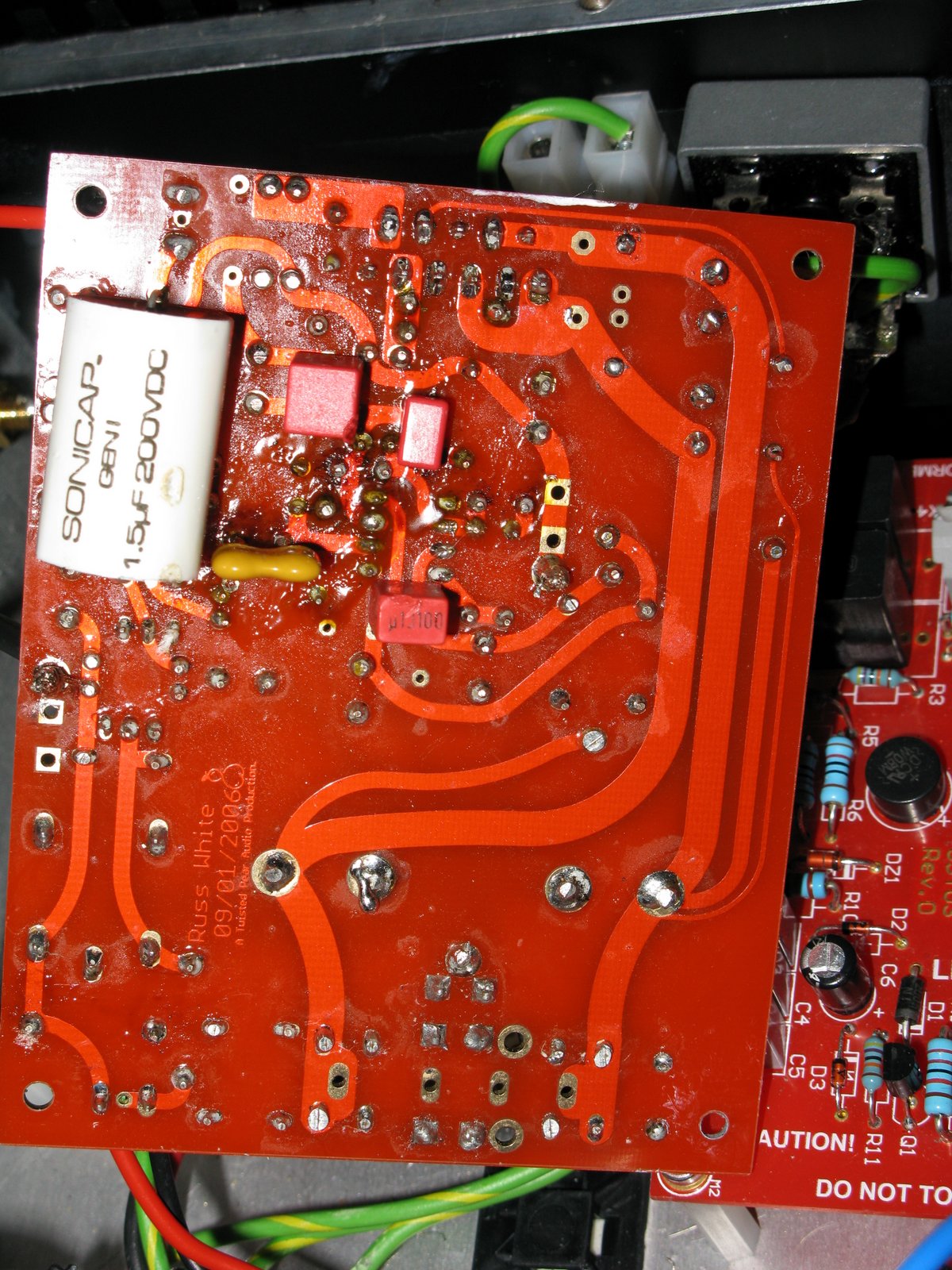

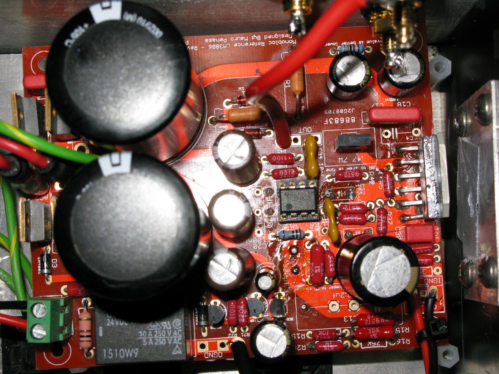

Attached are some pictures of the board - there are a few components on the underside, mainly due to the ease of fitting the oversized items. I haven't cleaned up the flux from when I was desoldering components, hence some of the gunge underneath.
...what exactly is the small signal area that you mention in your post. Is it the LM318?
Yup, the area on the board that is shielded by the ground plane, including the input connector block, input cap, input filter, feedback network, compensation networks, Howland resistor networks, and LM318 opamp.
Some of these nodes have large voltage swings, so 'small signal' is a bit of a misnomer.

I did follow the build instructions to the letter, however I have gone back (yet again) to verify all the components, and they are fine. However, as a result of doing that, the board is now broken; I had to lift some resistors to double check the values, and as a result of doing that I have lifted the pads on one of them.

Yes, it's on the top of the board under R23, but hidden by R23 when that is installed.
However, what is more interesting is the behaviour of my soft start when the "faulty" board is not connected to the power.
When the "faulty" board was connected to the power, I could see the operation of the two relays in the soft start circuit. What I noticed was the delay relay didn't pull open all the way - it only moved a little, but obviously enough to power on one of the boards.
With the "faulty" board removed from the power, the delay relay in the soft start now opens fully, and with a much louder click.
However, power is getting through to the "faulty" board (when I connect it all back up), as I've measured the correct rail voltage for both V+ and V-, as well as the 12V for the LM318.
