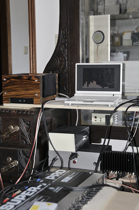

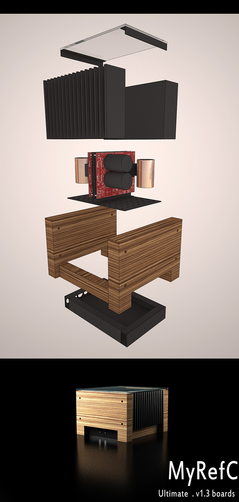

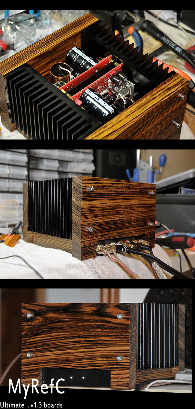

(2 years later) I've finally managed to finish my 1.3 Ultimate , here's the concept and the result (hope you don't mind posting here) :D:D:D
All the best,
Bruno Henriques
well thank you Bob, yes it's zebrawood, I had some pieces lying here for a long time awaiting for a project like this, it was all done without special tools, but with lot's of elbow grease, only treatment I gave it was several layers of teak oil (in between steel wool passes).
Sadly, the PS is just a grey/black dull box (for the time being) with a 225Va, some protection circuit (to check the mains Load, as here with the schuco plugs one can have it both on the left or the right side of the plug), fuse and a filter... I've used 2 CL-60 directly on the PGND connections to Earth on the amp side
You can see it on top of my other PS (the big box) for a P2P minimal gainclone (which I still have to finish casing) :)
and the small GC will eventually turn into this (for appearance's sake) :)
ps sorry for the mess, as we are entering my "workshop" reign!!!

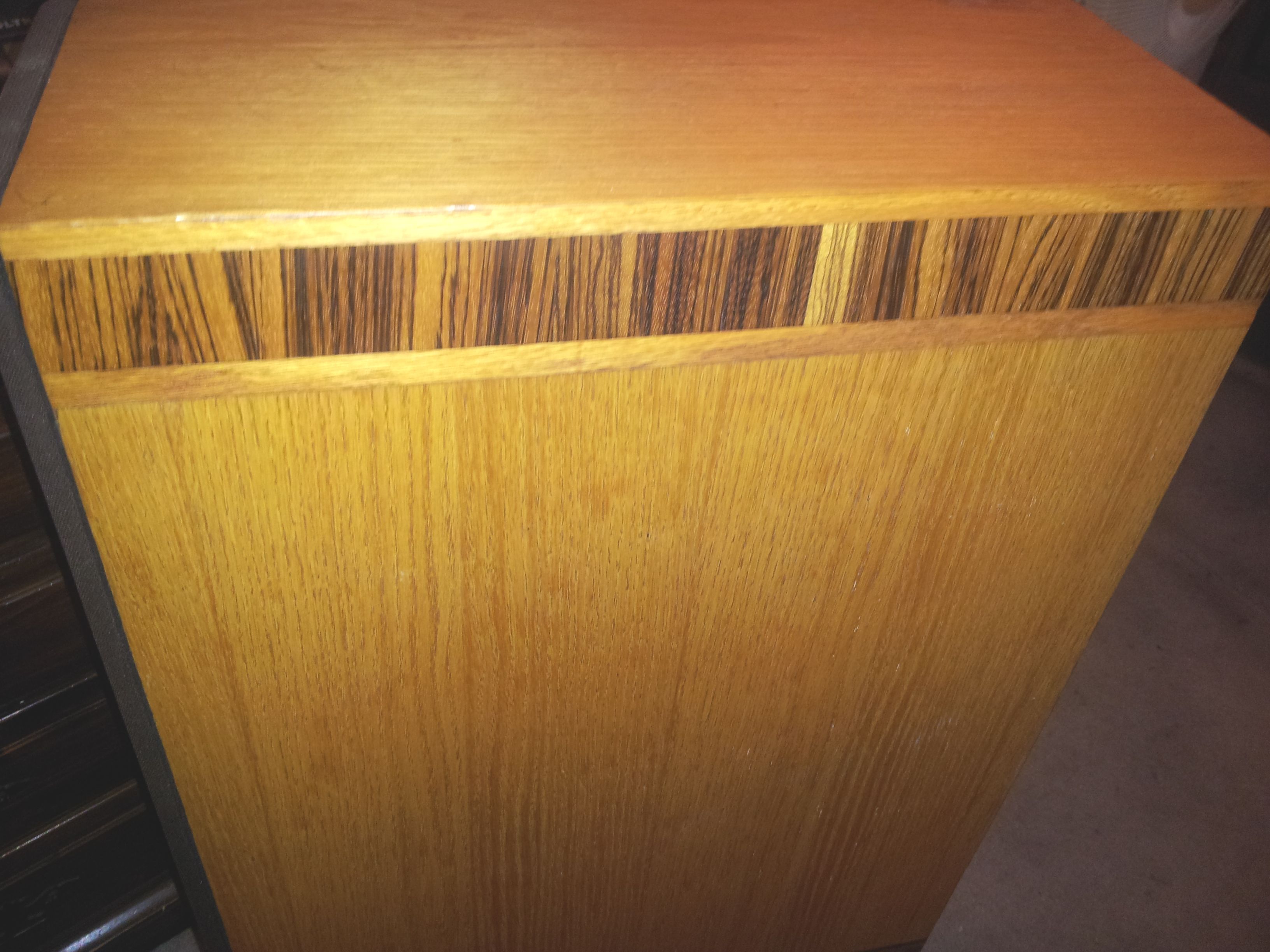

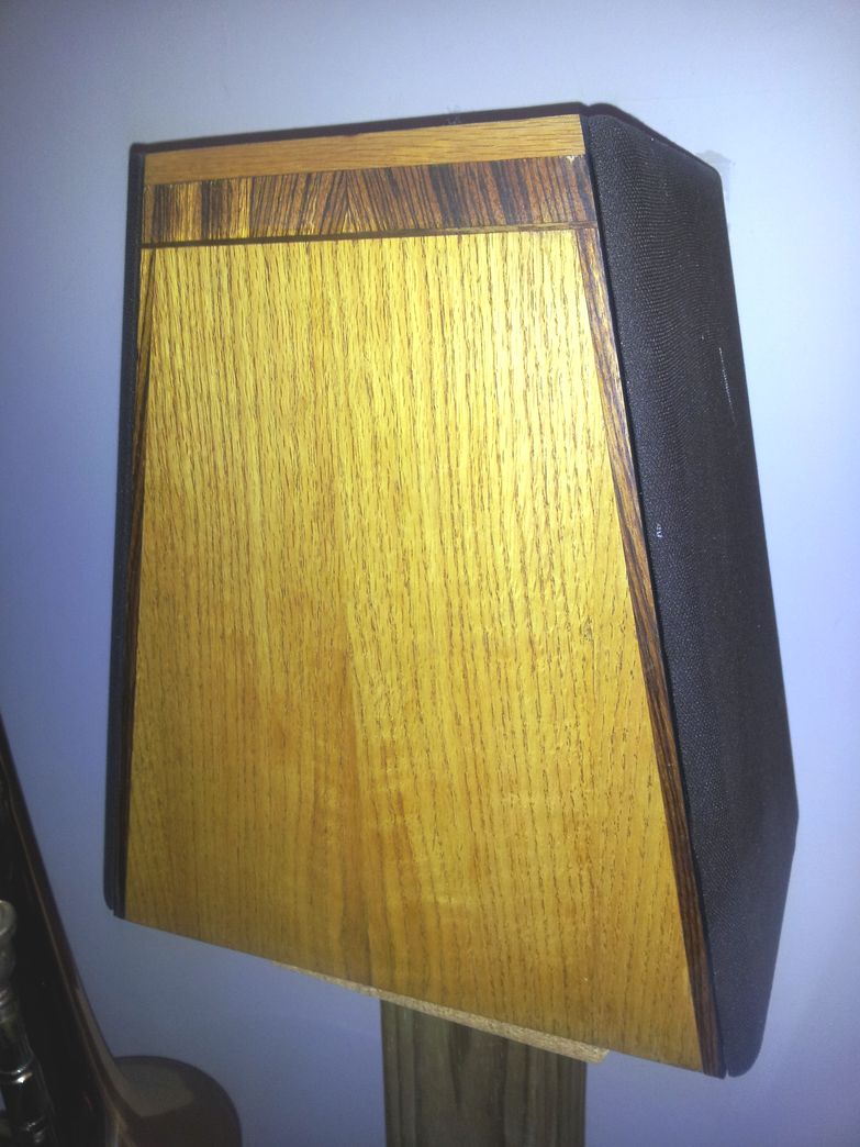

The pics were working great last night. Some sort of glitch has appeared today. Admin help may be needed.
Z is my favorite wood and have planned a similar application for the BLAT. I used it as accent wood on the HT system used prior to the new Sunflowers. The first pic is a di-pole surround. Two matching subs are in storage. Last pic shows different design for inside of front mains.

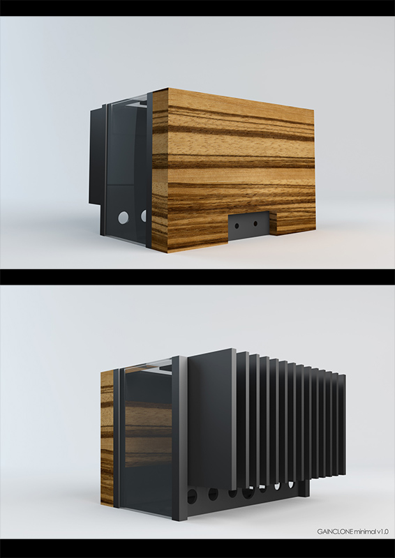

here, I've attached them (I'll ask here a mod to remove them from my last 2 posts, as I cannot edit them )
from left to right:
my concept for the revc casing, the "almost" finished box (minus the top glass), workshop mess (rev c and p2p gainclone in tests), the proposed casing for that minimal gc :D
I find that a simple finish (like teak oil) gives this sort of hard wood a beautiful grain, even if one has to apply it from time to time...
