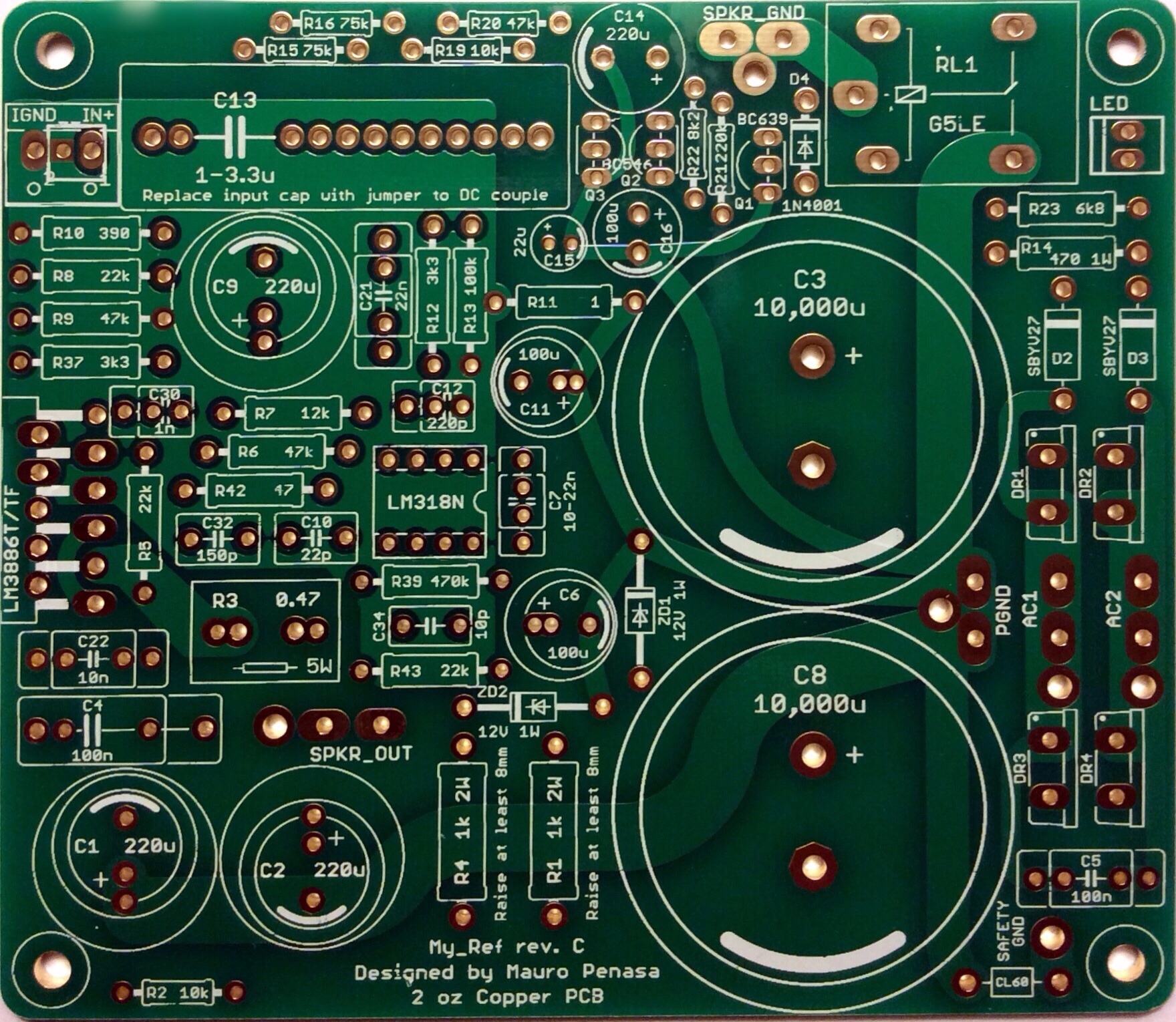

Alternate transistor?
I just obtained a MyRef RevC board and am sourcing parts from mouser and digikey in the US.
The schematic included with my board and several BoM here call for BC546 or BC546CTA specifically for Q2 and Q3. I cannot find this in stock at mouser or digikey. Can someone point me toward a suitable in stock replacement?
Any BC546 hFE grade should work - I've used BC546B there for ages without problems. In a pinch, BC547A or B should also work. It has sufficient Vceo (45 V, IIRC) for that application - the protection relay rail doesn't exceed +24..28V maximum.
Mouser has plenty of these BC546B in stock - 512-BC546BTF
