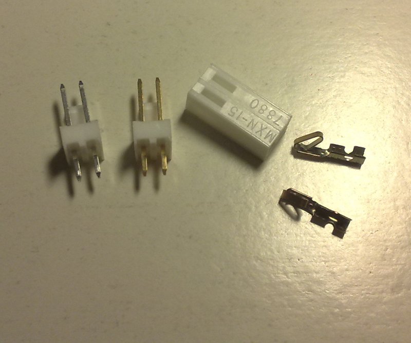

If someone is interested in Molex connnectors for their build (Mouser codes):
538-10-11-2023 Receptacle Housings
538-08-65-0816 Phosphor Bronze/gold plated Contacts
538-22-11-2022 Pin Strip Headers (gold plated)
538-22-23-2021 Pin Strip Headers (tin)
They will be part of the final BOM for those that buyed boards only.

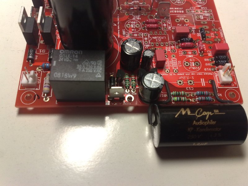

I have both the original RevC and the latest version with your improvements, and I can say for a fact that your version is a big improvement and takes this amp to another level.
Hi PJN,
just a quick note.
It's not my version but an optimized and fine tuned BOM using recommendations from me and Tom (Madisonears)
