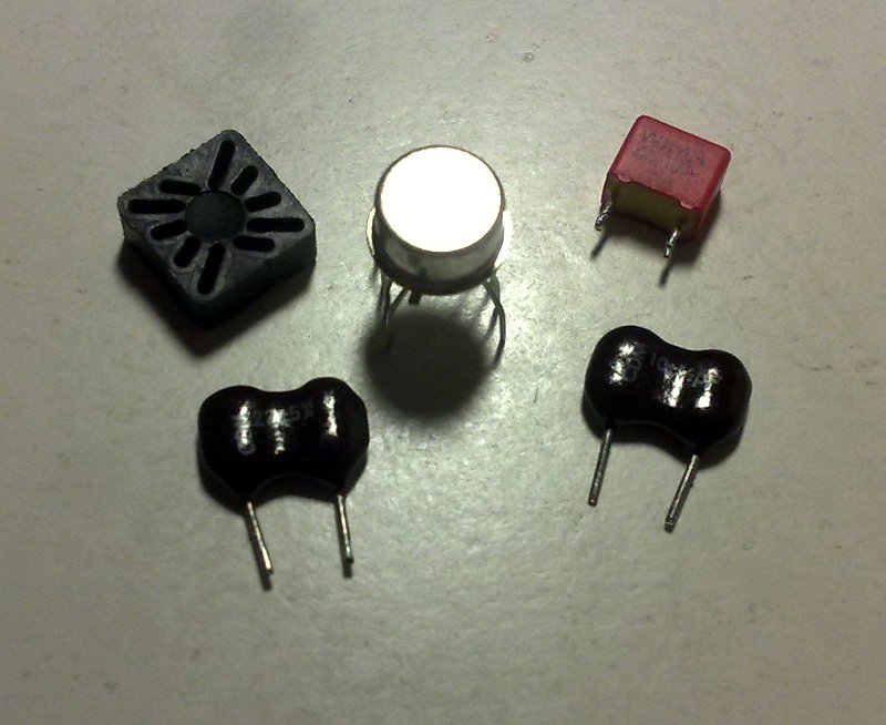

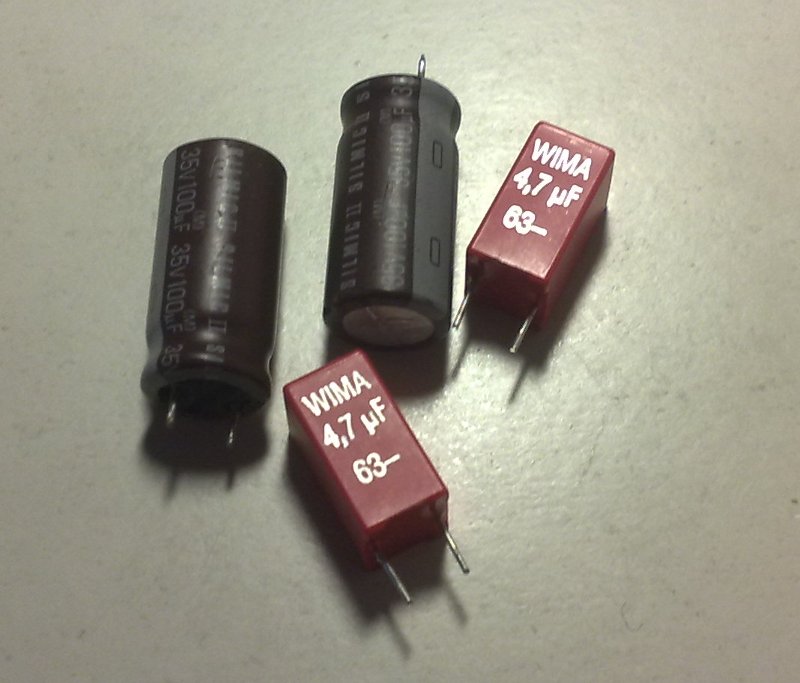

Report from the field...
Hello everyone,
among the caps that I've tried some are going to be definitive.
The Silver Micas in C10 and C34, after burn-in, are nice improvements:
more air, soundstage, refined high range and tighter bass
For 1,5$ each they're not cheap but...:D
Russ White was right... for its own MyRef he used SMs in place of ceramics...
The 4.7uF MKS2XL in place of the 100uF Silmics are a big improvement, tighter bass, more air and refined high range when you put Silmics back you ear an immediate sense of confusion...:eek:
I'm waiting some 10uF MKS2XL to try in C1-C2.. ;)
The metal can version of the LM318 is also an improvement, more subtle, is somewhat more 'natural' and less harsh. Not so important but if you can buy two at a good price...buy them!
And remember:
C12 Wima FKP2 220pF

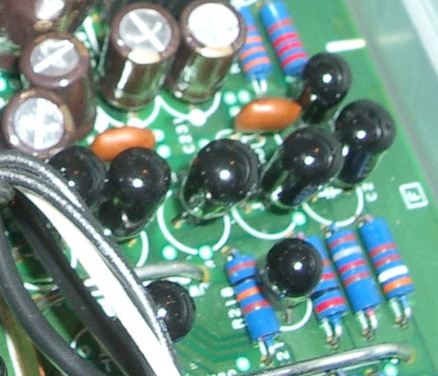

Dario, have you experimented with C30 or C32 at all? I'm not sure they're important to signal quality.
Not with C30, here I've used directly an FKP2 because I think this position needs one.
But with C32, sure I did!
I've tried both a Silver Mica and an FKP2 and preferred the latter by a slight margin... and the improvement versus a ceramic is BIG.
It was one of the most rewarding mods...:rolleyes:
Ah, I see you've taken a leaf out of my BoM :)
So those square box-type WIMAs with silver lettering are MKS2XL? I've only seen 1 uF/63V locally, but let me see if I can get higher values.
BTW, I tried 33uF/35V Black Gate PK at C6/C11 and they're fine even without burn-in. My guess is that 4.7uF/35V Black Gate will work just as well - that LM318 is not driving any heavy loads. It's just 47K and some high-Z compensation networks that it has to drive.
