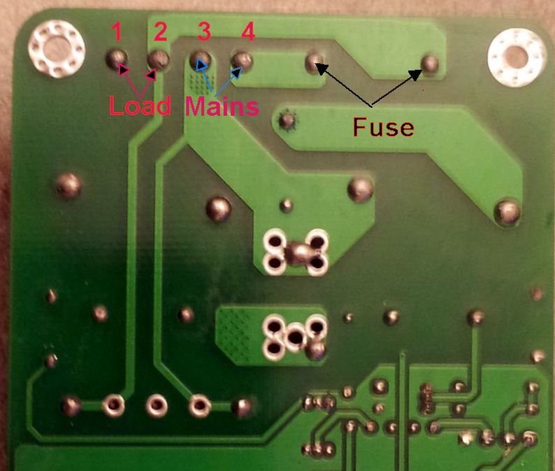

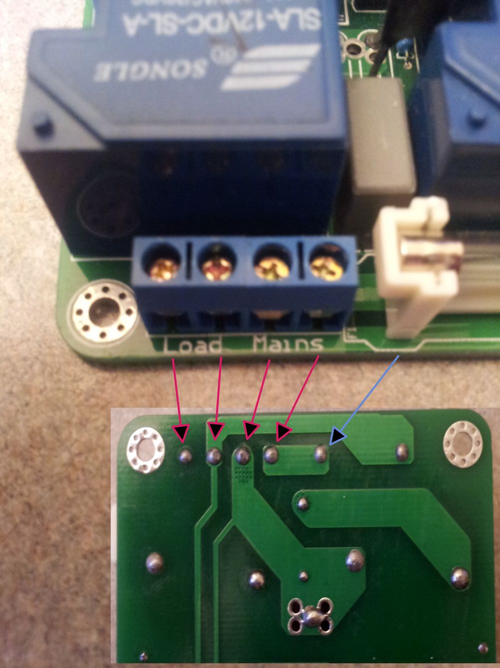

There is no designation on the unit for hot/neutral. I cant see where the traces on the top side go without taking it apart.

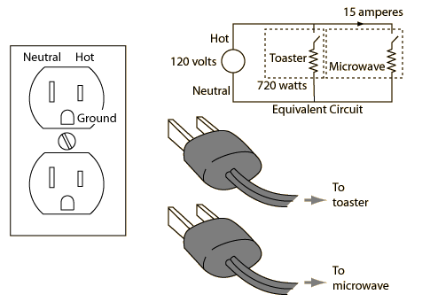

Coming into your house (at least, most U.S. domestic residences), you have three main power leads. One "hot lead", a neutral lead and ANOTHER "hot lead" that is 180 degrees out of phase with the first hot lead--120 volt appliances make use of one (of the two hot leads)and the neutral terminal (there is 120 volts across each hot lead and neutral). Appliances running on 240 volt AC in the U.S. take their voltage across the TWO hot leads (remember that they are out of phase, and deliver 120+120 voltages AC.
Unless you're dealing with very high current loads (electric ranges, large AC motors, colthers dryers, welders, etc) you would not be dealing with the 240 hot-neutral-hot circuits. More commonly, you will be dealing with 120 VAC (such as, with your amp....) and therefore are dealing with one "hot lead" and neutral. And that's where the terminology comes from.......

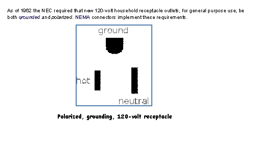

It's because the A/C voltage travels from the "hot" and returns through the neutral.
Look at where you should have a fuse, logically it would go on the wire that actually brings power into your device. If the fuse blows on the "hot" (Black wire in Canada) wire, it will kill the power to the device even though it is still connected to the neutral wire.(White).
If you had say a fuse on the neutral wire were the power exits, you would still have voltage potential on the device when the fuse blows.
So from a safety perspective, switch or fuse power (hot) at the earliest practical point.

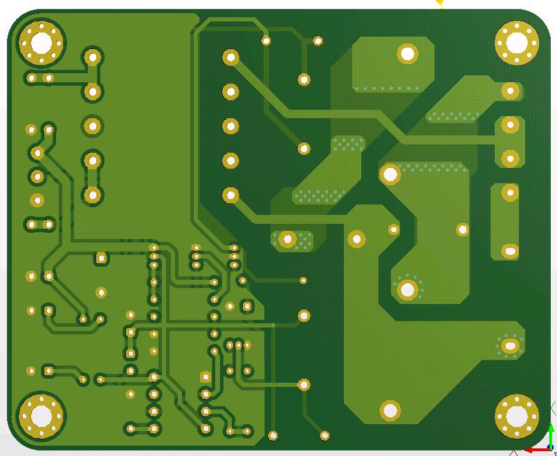

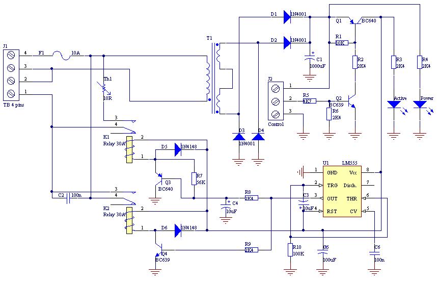

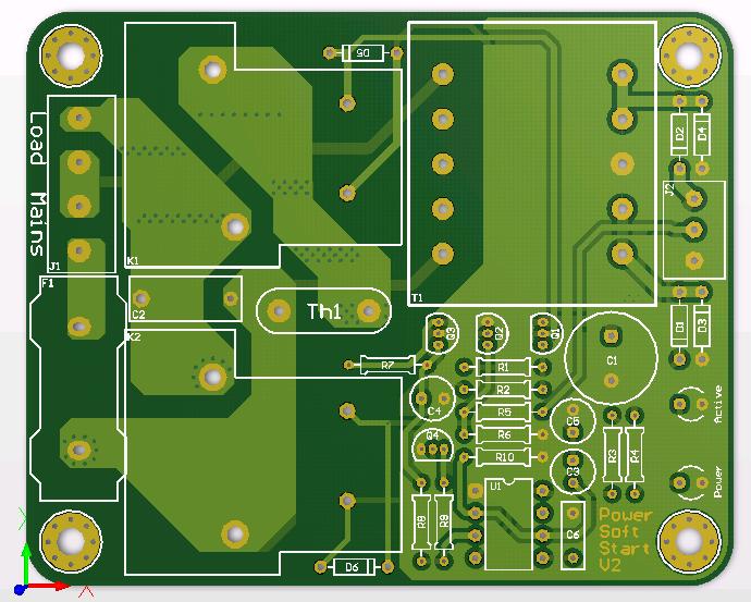

On the current board version seen in the pictures posted by Bob, the Live potential is fused and the neutral is switched by the relays. on the previous versions, both the relays and fuse were connected on Live. I did the change because the previous layout allowed thinner tracks to be routed unless i use copper pour patches with multiple vias, and by increasing the track width, i should decrease the track clearance.
Anyway, a mains switch should be used before the PSS circuit, as the small PSS transformer is permanently connected to mains as long as the board is energized, to allow remote turn-on by simply connecting together the pins 1 and 2 of the small green connector, J2.
i attach for reference the v2 schematic, and layout for reference.
I believe there is nothing wrong with inserting the Soft Start in the Neutral. It works just as well as in the Live.
We had a long discussion on the Pros and Cons of these two options, but never reached a conclusion. Maybe 3 or 4 years ago?
Now that we know that the Fuse is on the Live input then that input should be labelled L and the other input should be labelled N (if in the UK). Would North Americans want to see H & C?
Are K1 & K2 swapped?
I don't understand the time delay on K1 making me think the schematic is not what is on the PCB.
