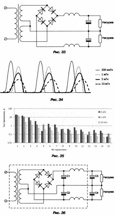

CLC PS Preconditioners
VladimirK said: I would like to attract attention once again to chokes in power supplies of AB amps. Maybe some substractions from a textbook (its in russian) could help me to explain the point: chokes (10mH and more) help a bit to have more favorable spectrum of charging pulses, but they do increase voltage drops at filter capacitors during current consumption peaks and affect negatively sound dynamics.
As a conclusion, chokes are not recommended for AB amps, except for maybe configuration shown in fig.36, with external or well screened part of PS, and with abnormally big C3 and C4 (in order to compensate negative effects of chokes)

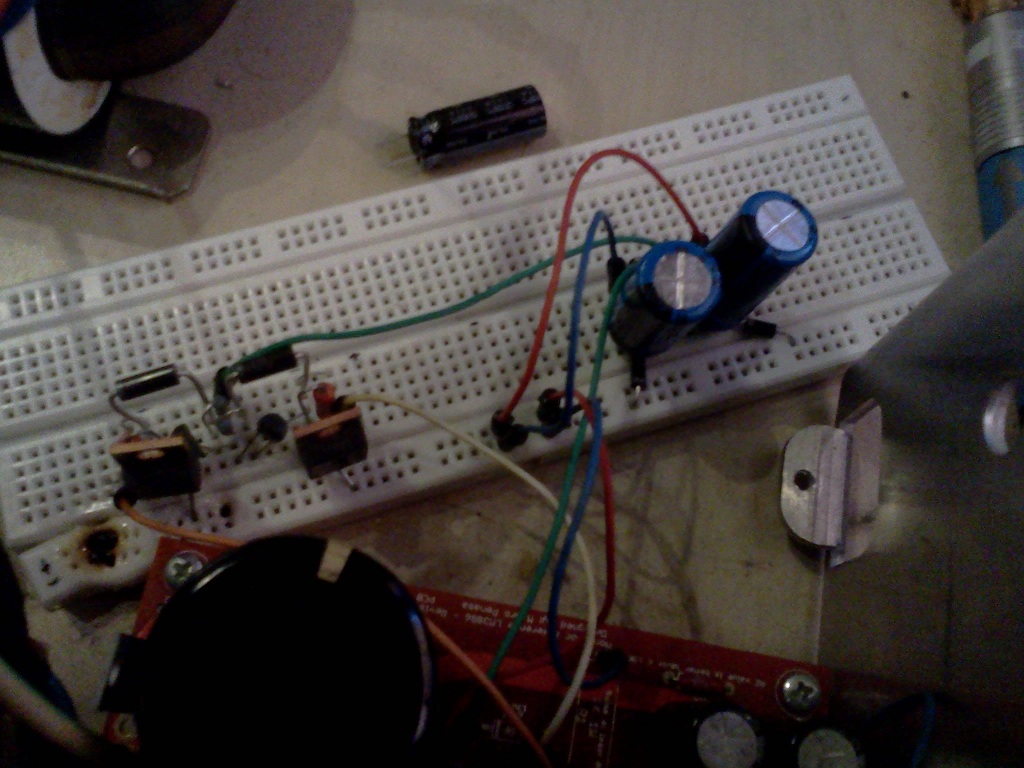

At post 321 I've attached a pic:
It's the LM318 PS with UnixMan Mod
Fine tuning is instructive...
This LM318 PS is a very instructive bench!
I felt that something was wrong with latest incarnation of the FE PS so I've tried to go back to BZX85 zeners, much better, more dynamic and entertaining.
The 1N53xx sounds in the FE PS too much warm and not as dynamic as the BZX85.
So, as a check, I've rebuilt the original My_Ref simple shunt.
It sounds good but not as refined and controlled as the FE PS (both with BZX85s)
Then I've tried to swap (in the My_Ref original shunt) the BZX85 with 1N53xx: much, much better!
Not as better as the FE PS but a worthwhile improvement.
So why in the simple shunt sounds better the 1N53xx and in the FE PS the BZX85?
The main difference is the current flowing through the zener...
Now let's analyze the thing (please Andrew, correct me if I'm doing any mistake).
In the FE PS R104/R204 regulates the current that flows in the Zener, so it actually partition the current between it and the shunt transistor.
The Zener current is calculated:
Vbe/R104
So for 270 and BC639/DB139 it meas 1V/270R = 3.7mA
The LM317 CCS current is calculated dividing LM317 VRef by R101/R201:
1.25V/51R = 24.5mA
So, if LM318 draw 5mA in the transistor flows 24.5-5-3.7 = 15.8mA.
In the original shunt the generated current is the voltage on R1/R4 (35V- Zener voltage = 23V) divided by its value (1K):
(35V-12V)/1K = 23mA
So in the zener flows 23ma-5ma = 18mA
Thus it seems that the 1N53xx needs more current to work at its best...
Now I've to decide if it's better to increase the Zener current (and thus the LM317 CCS current) increasing also heat generation or simply use the BZX85s
Any opinion on it?

Hope you have good luck with it. CLC is a good filter, but it is used to decouple the the load from the source. Sure, you will see less ripple at the rectifier side of the filter, but that is all. If you know of any great commercially available preamp that uses this concept, I certainly would like to give it a try. Works good as a mains line filter, where this configuration is very common. But think about a 10Hz signal draws power and how the charge changes in the cap. Certainly does not make sense to me.VladimirK said: I would like to attract attention once again to chokes in power supplies of AB amps. Maybe some substractions from a textbook (its in russian) could help me to explain the point: chokes (10mH and more) help a bit to have more favorable spectrum of charging pulses, but they do increase voltage drops at filter capacitors during current consumption peaks and affect negatively sound dynamics.
John Curl added: http://www.diyaudio.com/forums/analog-line-level/146693-john-curls-blowtorch-preamplifier-part-ii-1916.html#post2818214 Message #19154
In the present case, the supply after the initial takeoff points that feed the LM3886 (V+/V-) then feeds the LM318 (14V+/V-), which is a relatively low current device. The CLC (the "pi filter") is an effective filter in this condition and has over half a century of use in quality audio equipment.
An alternative would be the LM317/337 series regulators, feeding LM317/337 current regulators, feeding a final shunt regulator. I think that's the right order - working from memory here.
It's all in the name of quiet DC for the project.
What would be the effect of less ripple for the active regulators to manage? I don't know for sure, but maybe you could give it a listen and tell us. It's very easy to do.
Ahem. Since when is "commercially available" an indication of quality? At one time, all commercially available preamps and most amps used this circuit.

Let's say, it takes in the magnitude of 0.3mH, 1uF to filter 1MHz, to filter anything like 100Hz and below, what would it take? I think you are doing something that seems to work but do not know why it works. Or maybe you could elaborate on this concept by some example numbers and the related filtering frequency? I am talking about getting at least 10db better in ripple performance.
Since you know the math, what's the result for two 5,000uf caps (just to save a little money and PCB space) and a 20 mH inductor. Or point me to a usable pi filter calculator on the web; one that uses milliHenries and uF.
I'm pretty clear on how chokes and caps work, and why they start to misbehave beyond certain limits. Ever see an electrolytic cap pop due to inductive heating? I have.
Again, I don't know the formulas w/o looking them up, and it's not all that necessary. Give it a try, give an opinion. Quit playing with numbers and listen to the result.
I don't see any benefit considering the PCB space and total volume it takes. I think you can get a MyRef and try it out for yourself. I am not even convinced how good the CCS in this thread is going to work, but since Dario was committed enough to put out a PCB, plus there are other things I wanted to compare, so I am willing to try it. Maybe that is what you should do to try your idea first with this circuit.
Basically, I put high trust in listening tests and measurements combined. For pure listening, if I cannot see good description on the changes claimed to be improvements, type of music variation enough to be convincing, then I would have to have listened with the person in some sessions to really understand what one calls an improvement. Otherwise, the theoretical aspects need to be convincing enough for me to try, which in this case, it is not.
Let's not forget that large inductors also have large series resistance, when you put these in series with the power taking source impedance into consideration, no matter what the current is, you are going to have a voltage drop that interacts with currents. Not a good idea. Calculators do not take these reality issues into factor.
