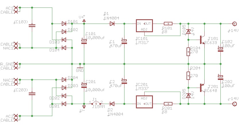

forget about the PSU own ripple. That's just uncorrelated noise. What matters most is the audio freq modulation imposed by the 3886 on the raw PSU rails. That will go all the way up to 40KHz and more. And what's worse is that it is correlated noise. Which is much worse WRT our perception (low level uncorrelated noise is easily ignored by our earing system, while even the smallest levels of correlated noise will affect sound perception somehow).The regulator does best on the 20 kHz ripple, but worst on the harmonics. OTOH, the plain zener does worst on the 20 kHz ripple, but best on the harmonics.
BTW: if you try the cascoded (dual FET) CCS, things will be much better.
P.S.: don't forget to add the Diode-Cap trick *before* the CCS. Even that alone will do wonders.

you only need 2 FETs and 3 Rs for each CCS. For this application heatsinks are probably not required (and perhaps not even TO220 FETs).
Exactly and since the PS includes two CCSs (one per rail) it makes 4 FETs and 6 resistors...
Please remember me, how much current is drawn by the 318? how much by the shunt reg?
The LM318 needs circa 5 mA and at least 10-12 mA for the shunt.
To maintain Rev C original current 23mA are needed.

See the attached schematic, is it what you mean?
Is so I can try it this evening.
Just tried it with 1N4007 diodes and 220uF 50V Elna RJH (what I've on hand) and something must be wrong...
Can you check again the schematic I've attached earlier?
Sound stage is smaller, sound seems somewhat more 'live' but bass loose precision and distortion is clearly increased...
maybe I've found the problem... possibly the low-esr Elnas upset something in the regulator.
Tried again with 220uF 100V BC 038 and the 'distorsion' is gone...
Also soundstage and bass definition are back, it remains the more 'live' sound.
I must listen carefully to the difference with more different music but at first glance I prefer without this D-C net, with it it sounds somewhat more confused... I don't know....
really strange. The schematic is correct. Are you sure that you have actually connected everything according to the schematic? (make sure the 3886 is actually connected before the diodes!).I must listen carefully to the difference with more different music but at first glance I prefer without this D-C net, with it it sounds somewhat more confused... I don't know....
Perhaps the 220u are a bit too small? Don't you have any larger ones?
You may also want to try a rail-to-rail cap after the diodes (with or without the two C to gnd as well; use large values, specially when you have only the rail-to-rail cap).
The problem may also be the new circuit layout. Where is the cap common ground point connected? consider that with the cell the currents on the 318 closes on that point rather than on the general star ground as they did before (using only a rail-to rail cap after the diodes should restore the previous situation WRT ground currents layout).
Just in case, you may also want to try some different diodes types if you have some at hand.
BTW: do you have a scope? can you check the differential voltage across the diodes while driving a real (or real-like) load at normal listening levels?
