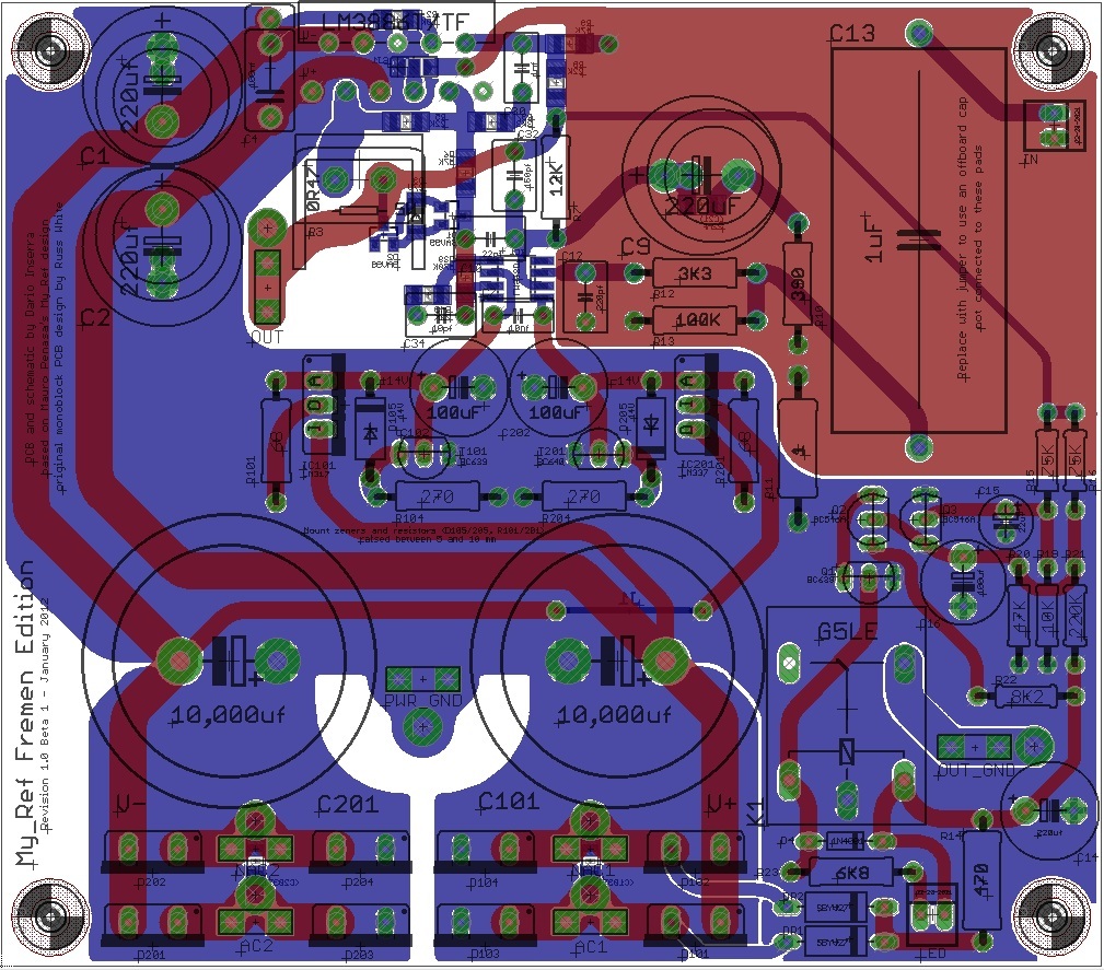

My_Ref Fremen Edition - need help on PCB evaluation
Just ordered the PCBs
After a due global check I've just ordered the PCBs from makepcb.com.
Attached is the final design gone to production.
Apart some minor cosmetic changes I've had to reverse BC640 orientation since I've discovered that Eagle default libraries have two instance of BC640, one right and one reversed... :eek:

Dario, can you give a final dimension of the boards ?

1cm of 70mils 2oz PCB trace should measure 0.00137 Ohm...
The 0.01% of the smaller resistor (22K) is 220 Ohm
Am I right?
I don't understand...how much precision are you trying to reach?

0.1% precision is not the issue.
Look up the original threads and the Howland current pump and you will find it is the ratio being very close to 1:1 that is important.
The length of the exposed lead affects the resistance substantially when working at the 0.1% or 0.05% matching level.
If you look back you will find that I advised doing the on board matching before adding in other components. I remember asking whether we could partially populate the PCB and still get effective matching on board.
The subtlety behind my question appears to have gone straight past most readers.
This was intended to find if it was possible for others with assembled PCB to revisit the matched tolerance simply by removing the 318 from the socket.

I'm not sure I understand what it means a +ve matching...maybe that the voltage difference is positive?
Shouldn't the use of smd components address, at least in part, this problem?
Perhaps the board can be designed so that on board matching is not required?

SMD may help since it potentially offers shorter trace lengths. But adopting SMD alone does nothing to improve on board tolerances of matching.
