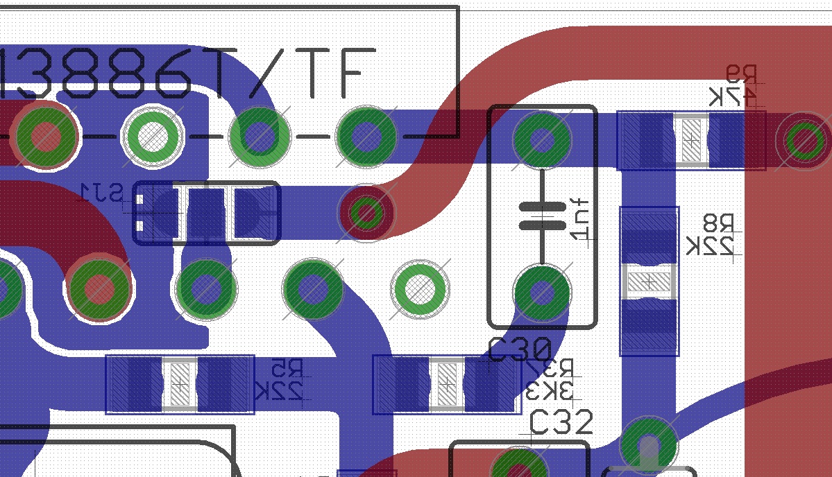

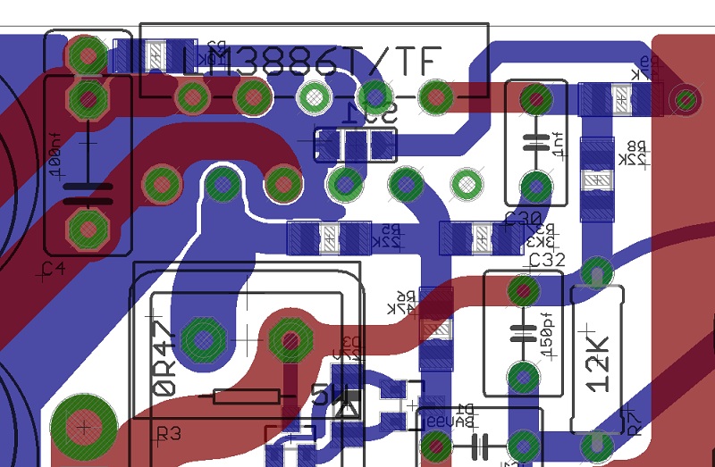

I am also having some second thoughts on the LM3886 ground. If the board comes connecting pin 7 to power ground, it becomes difficult to change it back to the original MyRef.
It's possible to make a solder jumper (see attachment) that makes possible grounding choice, I'll give it a try but all that I've read, the Evolution Rev A, listened and my instinct brings me to PGND... can you elaborate?

In fact it's also possible to use both grounding schemes in the same way we do it with TP boards... lifting pin 7 and connecting it to PGND or 0V...
I'm not sure including a solder jumper it's the best option, it would be nice if other partecipants give feedback about it...

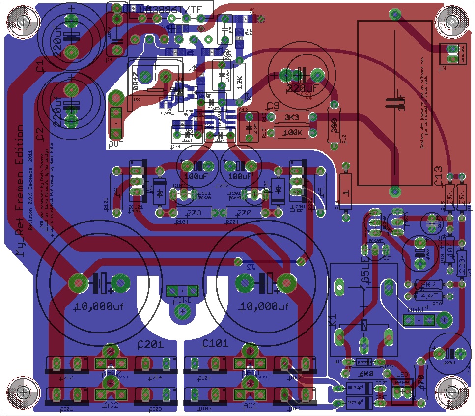

In the meanwhile I've mananged to find, reverting to G5LE, a layout with a good distance between input cap and output ground connector.
Since no one wrote nothing about it I've also inserted the solder jumper but I'm still doubtful about it.
I fear that in this way the separation between 0V and GND could suffer... any opinion on it?

I don't know if doing much better is possible but I'm confident we have a good layout now. ;)

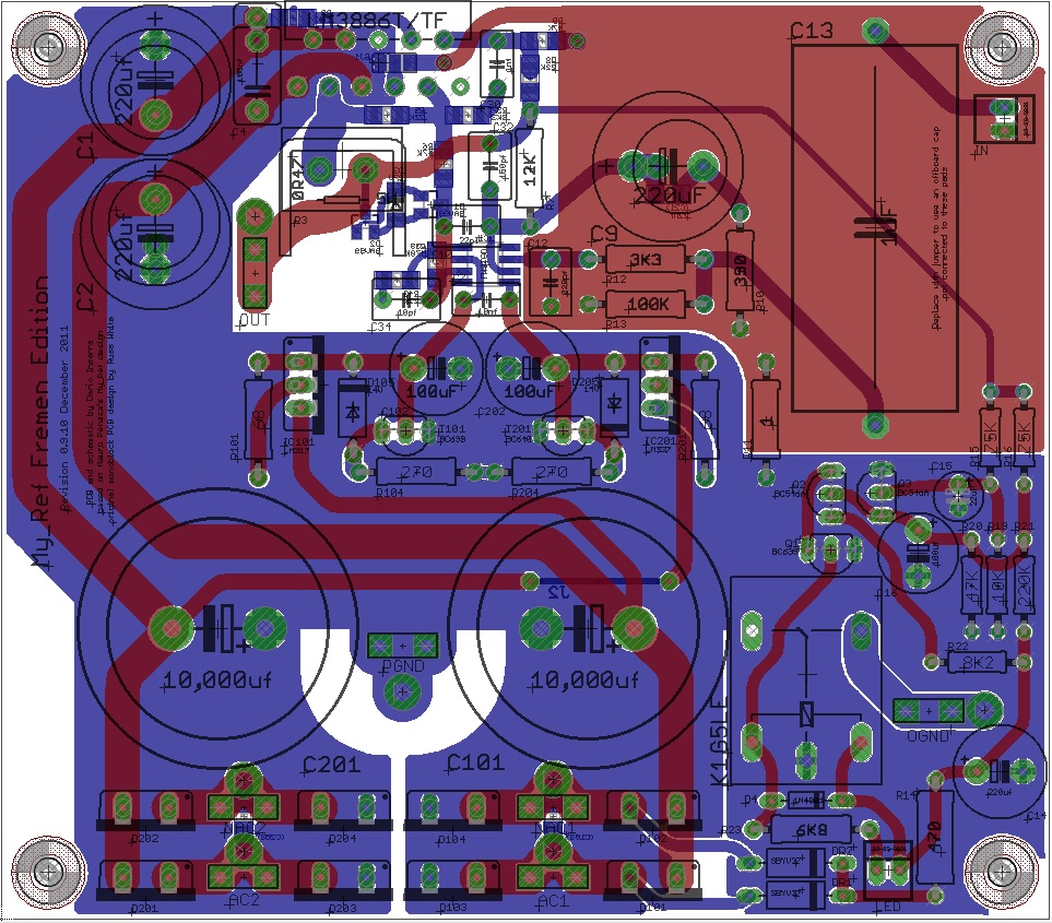

I've done some further mods:
  • 12mm lead spacing for through-hole resistors
  • modified a bit more the DC protection layout.
When you'll have the possibility to check it on a bigger screen let me know what you think about it.

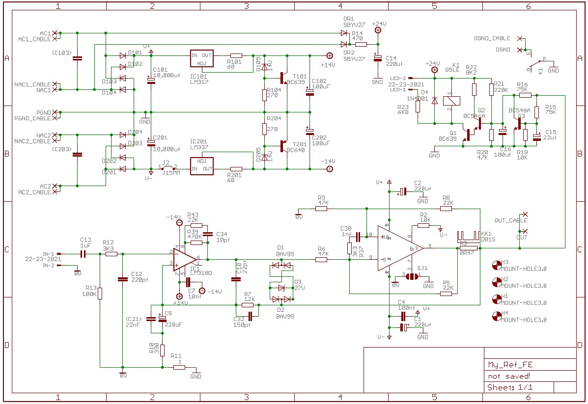

I've used a library which is specific for Mundorf Zns and I can confirm that the hole is bigger (50mils Vs 40mils).
are you specifying Plated Through Holes (PTH)?
Check with the manufacturer on the tolerance of plating thickness to determine the finished minimum diameter of PTH holes.
Check also the tolerance of plating and roundness of leadout wire for the through hole devices. You as PCB designer must check the maximum diameter of the lead out and the minimum diameter of the hole.
50mil PTH may not allow a 40mil plated wire to pass through.

I've checked on PCB manifacturers web sites and found nothing about plating tolerances, sadly.
But I can say for sure that in TP boards in C13 1.0 mm Mundorf Zns wires fits, tightly, but fits in 1.0mm holes.
The holes in Zns library I'm using are 1.27mm so they would accomodate easily 1.0mm wires but not 1.4mm of Mundorf Silver/Gold.
Is this a problem?
Mundorf SG wires could be slightly filed and they'll fit, anyway.

Not my TP boards. Most of the caps of mine won't go through, and if we are going to try out different caps, we need to be able to remove multiple times where residual solder is going to fill the hole a bit. I've already had the throughholes come out on my R3's. Maybe the 1.27mm is okay to try since these are prototypes.
I am using lead free solder. Probably the normal lead solder works better.
I think you're right pointing out the lead free solder...
When TP boards were new the Zns leads mounted quite easily, after desoldering they don't fit unless you put some new solder in the empty hole and suck it with a vacuum pump.
Only after I've buyed a desoldering station I've managed to have those pads really clear... ;)
Obviously I've always used leaded solder.
On the MINI2496 I've used lead-free solder and the only way to have a clean pad after desoldering is to wet the void hole with leaded solder...
I'm confident that the 1.27mm holes will help us with 1.0mm leads. :)
