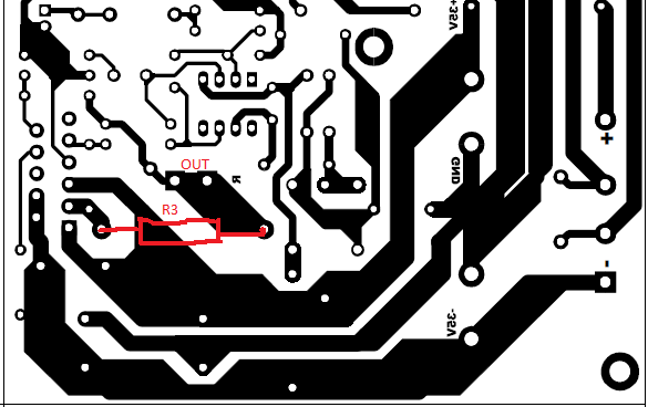

Whatever you decide, I'll just get a set and figure out what to do with it when I get it. Still need to run some additional tests anyway. This design seems really sensitive to layout. With the last layout, I still think the OUT trace is too close to the limiters. Have not checked the two ground currents yet.
Yes, the design is sensitive to layout, in fact Mauro always stated that his PCB was integral part of it...
Regarding the OUT trace is probably hard to do much better...
See the attached magnification of Mauro's design.

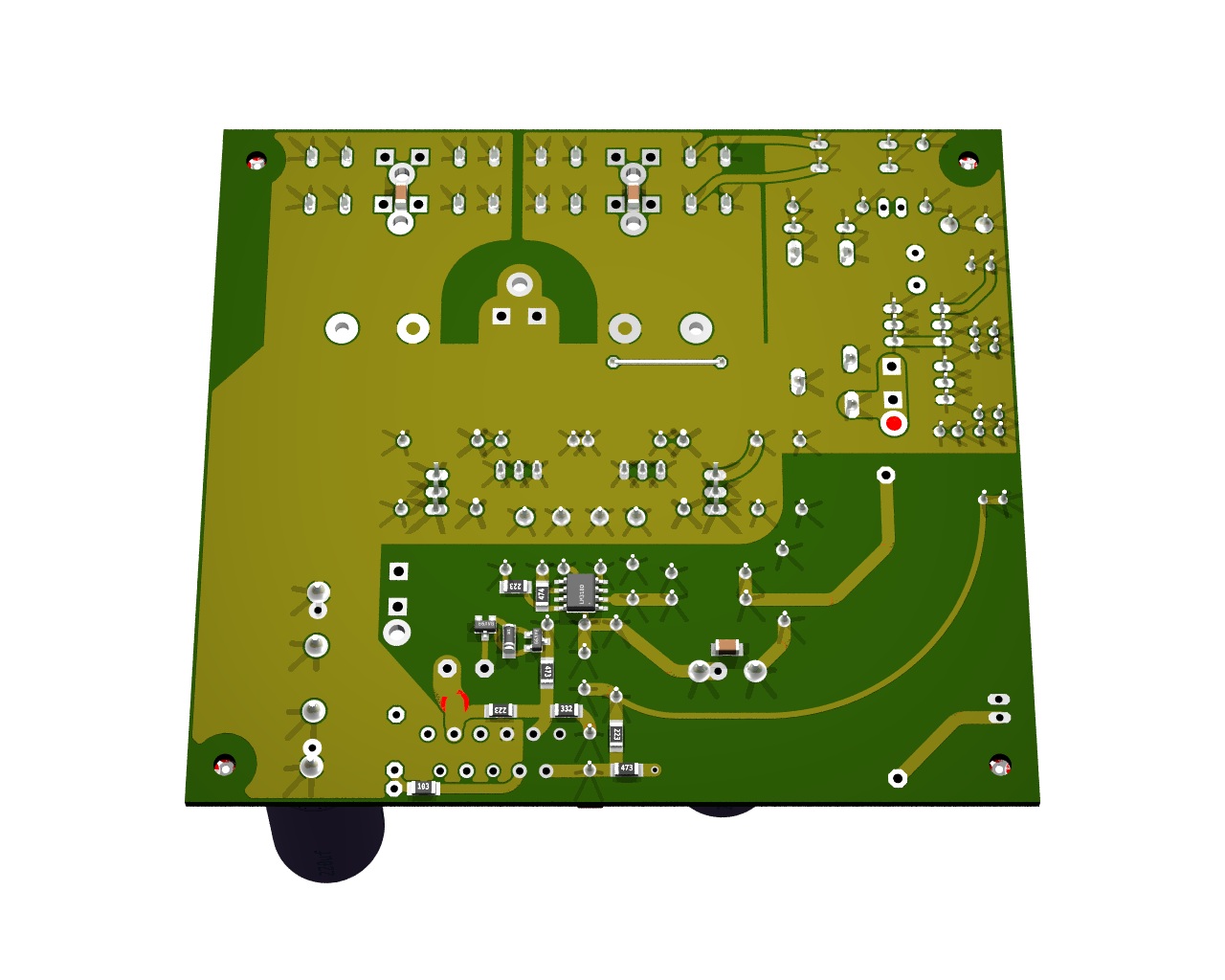

Final (?) PCB
I've managed to redesign the PCB for Eagle 5 and while doing it I've made some changes:
  • the only SMD components are in the amp section
  • changed output relay to Omron G2R
  • looks great... ;)
I've attached some pictures and I hope to post tomorrow a very preliminary BOM (just to make an idea of costs).
Are you sure you want the speaker ground so close to the input?
I've rearreanged things a bit, now distance is bigger, see attachment.
Thanks ;)

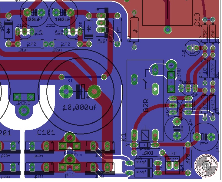

The distance still seems smaller than the original MyRef though.
You're right. Distance if half Vs TP boards.
This night I'll try to get some more distance but I'm not sure how much more is possibile to gain.
BTW, PCB wise, the output ground is still PGND, so the entire ground-plane can, potentially, irradiate.
Even if the connector was near the two SBY27 current return toward the 'starground' between the two smoothing capacitors, so passes near the actual position of OGND, isn't it?
Can you explain why the position of the OGND connector is so important and why it differs from the same potential PGND ground-plane?

I know, what I'm missing is why the connector should be treated differently from the ground plane.
They're at the same potential and the connector goes, via the relay, to ground-plane.
See the attachment for a comparison between TP and FE return current paths

We are not considering the connector only, we are considering the current path and it's distance/orientation.
I've tried a different arrangement but I'm not satisfied, too much obstacles to the return current... see the attachment... any idea?
