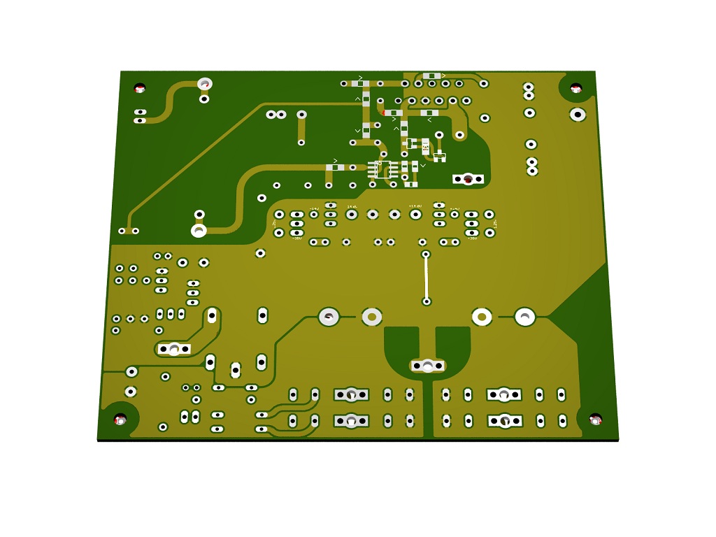

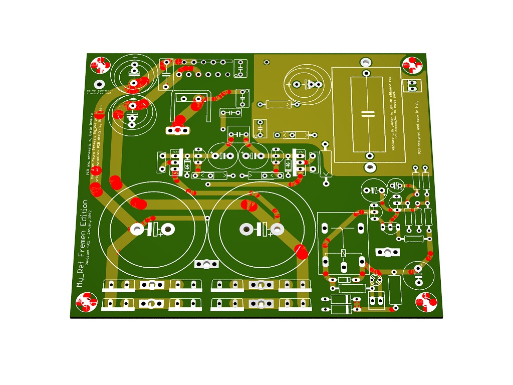

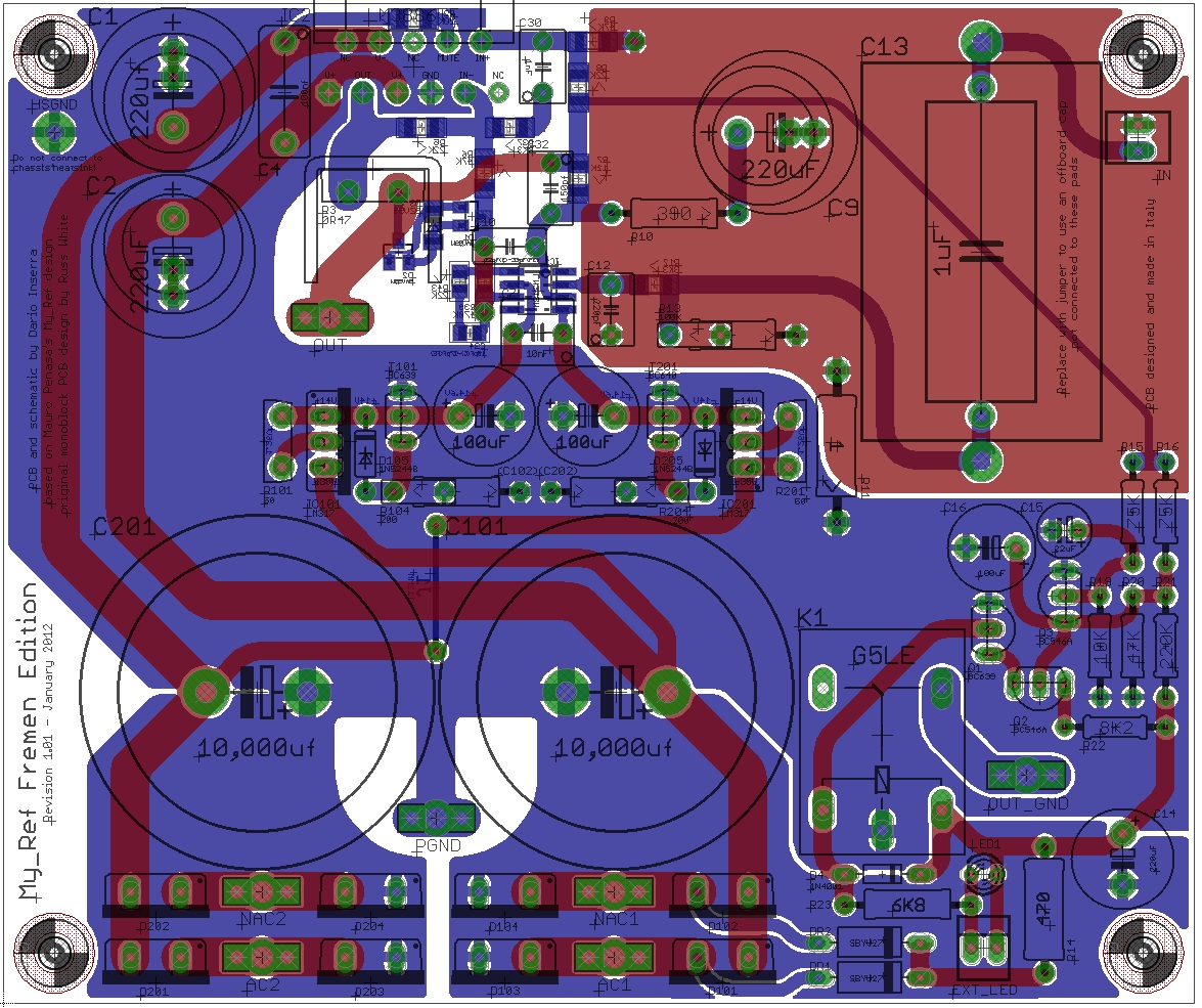

Render of PCBs
I've just figured out that I didn't posted any image of the final boards...
You'll find attached a render of the PCBs.
The main difference from Release Candidate boards is the fixed cofiguration for C9/R10 (different from My_Ref original one, as suggested by KSTR and tested during RC phase).
Other minor differences are some holes diameter and a more refined trace toward R3.
One final note about price... we've reached 35 kits/70 PCBs, price so far dropped to 32€/kit
