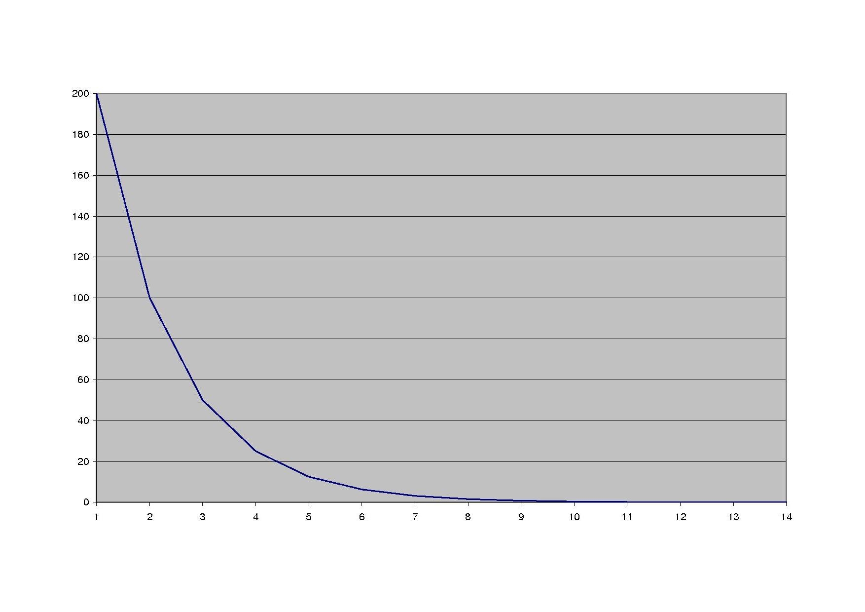

I've read it but not all posts were simple enough for my electronics knowledge level.
A configuration where the offset is reduced by a percentage of the offset per unit of time.
example:
Initial Offset 200 with a 50% reduction per second.
Perhaps something like this:
Add an extra resistor between the servo opamp input and ground leaving only a percentage of the total offset signal at the opamp input. Then slow down the output so it will take a full second to accomplish that partial reduction.
example:
4.5seconds to get a start up offset of 200mV (output?) down to 20mV.
I would interpret that as slow enough to need a 5second delay on the speaker protection relay.
I suggested a different servo set up.
The output offset should be set for zero mVdc when cold and just starting.
Any drift from that starting value as the amplifier warms up is then corrected by the DC servo. That way the initial offset is low and the variation can be controlled by a slowish servo.
If there is a start up pulse on the output that is independant of output offset, then the speaker protection relay should delay connection until after that pulse is passed. i.e a 100ms pulse, then a 150ms delay for speaker connect.
