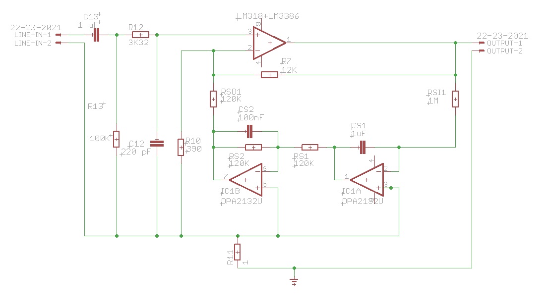

But we don't have matched input resistances, one leg is 103k (R12+R13) while the other is 12k (R7). That alone could give a lot of current offset.
Input voltage at the 12k leg is 12k*500nA=6mV and input voltage at the 103k leg is 103k*500nA=51.5mV(!!) which results in an additional voltage offset of 45.5mV. And that is with zero offset current spec.
We could reduce R13 to 10k and that would match and lower source resistances as seen by the chip, any remaining offset would be convenient to trim out then. Any preamp (except exotic "passive" pre's with larger than 10k pots) should be happy to drive a 10k load.
If it was decided to try to balance input impedance, you could also increase the other leg (R7 + R10), for example, we could use a 100k for R7 and 3.3k for R10 and that would balance impedances. It would also bring C9, if needed, down to 26 uF with the same corner frequency, almost film territory.
Likely, this would be easiest somewhere in between for both legs, as long as they were balanced.

Andrew, one nice thing about the double opamp Cordell's approach is that we can do active post filtering:
attachment.php
...Do not "add" an inverting opamp to either the non-inverting or the inverting servo. Just feed into the appropriate feed in node.
It can be fitted with an output filter. I consider this last mandatory...
I concur with both of these - it's simple and elegant, minimizes active parts, and can be optimized without too much difficulty.
Of course, the offset trim of the LM318 is even simpler, if there's not much ripple feedthrough from the opamp supply rail to the trim terminals (which are internally connected to the collectors of the LM318 LTP, and very much in the audio path, IIRC).

the removal of the DC blocking capacitor then presents the input transistors with unbalanced source "resistance".
This unbalanced source resistance leads to increased sensitivity to temperatures effects and thus drifting with temperature.
Fortunately the input transistors inside the opamp will have a slow temperature error.
A slow acting DC servo will apply adequately fast correction to maintain a lowish to very low output offset.

Daniele,
I agree that Mauro is extremely expert and creative in his solutions and that the "unbalance" may be a design decision. I also think that we shouldn't treat his design as untouchable. If nothing else, I can learn something about the difference between theory and reality by trying some new ideas, and learning from my mistakes. If we play with these ideas as a design exercise, we may even understand some of the reasons why Mauro chose what he chose, since he is not here to answer questions.
With that in mind, I plan to build a pair of FE RC boards with balanced input impedance. I can't say when I will do this, but it is now on the project list. My idea is to balance impedance by changing R7 and R10 and that will drive changes to C9, C10, and C32. Theory suggests that I should be able to do this without changing stability or audio quality, but I am not at all sure of the result. I have more simulation and more study on how the compensation works before I select values and components. In the end, I hope to discover if the balance reduces/eliminates the need for C9.
I see this as a parallel approach to the DC servo investigation based on learning from Klaus' comments. I will let you know if I learn something.
Jac
