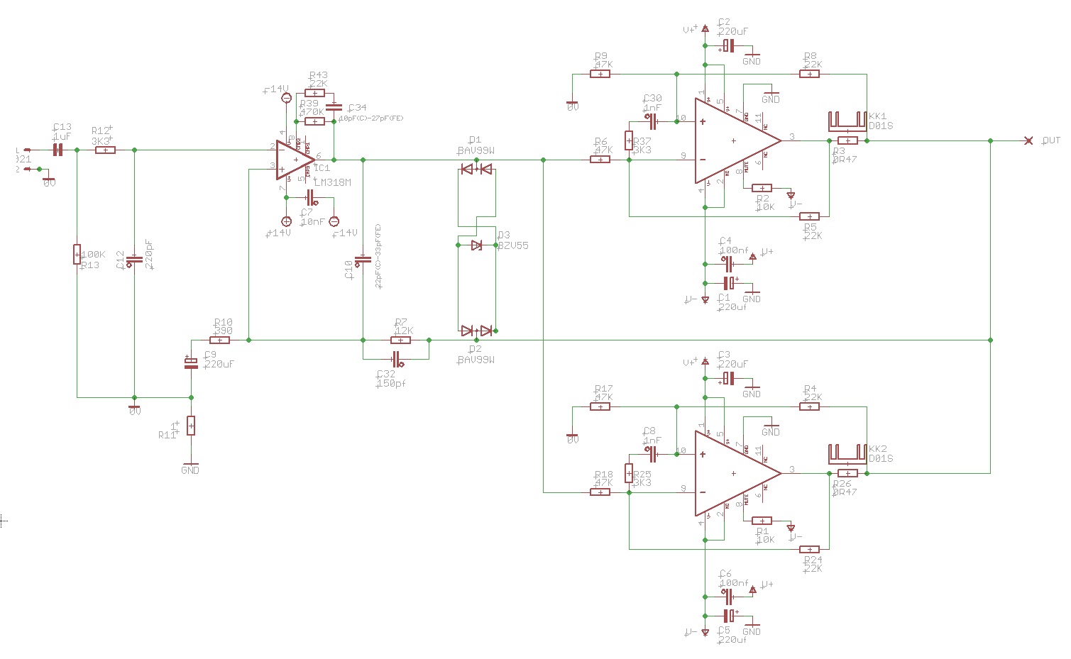

An idea for beefing up output power of the myRef just occured to me : it looks quite feasible to paralles a second LM3886 current pump and use slightly higher supplies. With the V to I transfer reduced to 1/2 of the original value for each section the overall conditions for the LM318 would be the same. One would need to alter the Zener overdrive clamp. That is one the secrets of the myRef topology with the frontend running inverted (not: inverting). Some care would needed to check for / avoid cross currents, actually one could even establish some cross-current on purpose to bias the output stages to more of class-A operation at low output current levels, de-symmetrizing the crossover to below and above zero current for each half.
What questions, what notes?

What I find most interesting (difficult to understand) is the placing of a current pump within a voltage gain loop. The NFB loop must be compensating (removing) the V to I transfer. It does give the LM3886 a nice balanced input though.

Paralleled My_ref.
http://www.diyaudio.com/forums/attachments/chip-amps/54486d1133860004-x-calibre-hot-rodding-mauro-penasas-lm3886-design-x-comp.pdf
Paralleled My_ref.
The whole idea behind the myRef is to have the frontend see the speaker current, the output of the LM318 is a replica of it and the feedback servos this output -- the control voltage for the LM3886 -- to what's needed to establish the proper output voltage.
There is good reason to assume this is more benign sounding than if the LM3886 were just a power buffer with gain.
Hm, I cannot see a second power stage on the board you linked to.

Parallel current pump
On the original My_Ref thread it was already proposed a double pump approach:
http://www.diyaudio.com/forums/chip-amps/54571-my-audiophile-lm3886-approach-54.html#post1139692
You'll find Lukio's schematic there; his use of the current pumps is identical to My_Evo (Evolution) one.
This is the version I've did some time ago while exploring the concept, probably identical to Siva's one:
there's no a version I'm aware of where the voltage rails are higher than My_Ref's ones.
