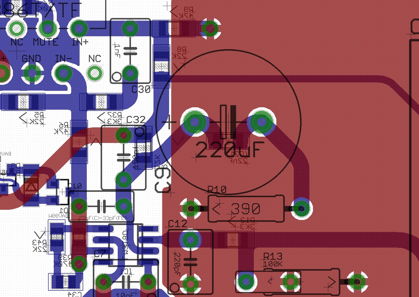

Put C9 with one end on the GND plane, the other end to R10. So, put R10 were C9 was and vice versa.What you mean exactly by 'exchange positions of R10 and C9'?
I can't see how...
Make the total copper area as small as possible by moving R10 and R7//C32 as close to the -IN pin as possible.Minimize trace lenght on -IN... you mean between -IN and C12 or the entire trace?
Yep, keep it, then we can use either a jumper or the resistor.Well, I imagine that it can be shorted with a piece of wire if needed but I would leave the position to be compliant with Mauro's design.
Well, length itself is not a problem, just keep loop area small. In fact moving R3 about 1..2mm to the left will do. Note that all this is inside of the feedback loop of the LM318 so any possible ill effects are not shining through directly.Doing this would lengthen the feedback loop, do you think it's mandatory?
Connect R10 to the LM318 pin 3 with a very short trace. Then connect C9 to R10. The negative lead of C9 connects to C12 and R13 (input ground).
This is a sort of a puzzle... but I'm pretty tired now 1.00AM here.
Maybe something like this?
Fine
Something like this?
But in this way the output seems to me too near to the PS lines.

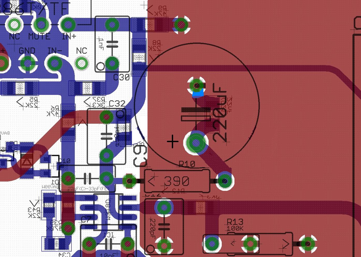

I was thinking more like this:
Dario, if you are going to swap C9 and R10, I would STRONGLY recommend you listen to it on the beta board or old MyRef first.
Thanks, more clear.
Now I understand why I couldn't imagine that... you were suggesting to swap C9 and R10 in circuit, not in layout...Klaus, do you meant the same thing?
I think this thing has to be tested and it's a bit more radical than what I would like to change...

Yes, swap C9 and R10 in the circuit, this was suboptimal from the very beginning (no disrespect for Mauro -- his original idea was and and remains to be one of the best ideas in chip amp history --, but any designer may make some decisions that are questionable). I would consider it a minor but very necessary change (I mean, you swap to components wired in series). It does not, and can not, change the sound (you guys certainly are overreacting here, IMHO) but it will increase noise immunity by a significant marging when done right... so it may be said "to change the sound" in a certain way.Now I understand why I couldn't imagine that... you were suggesting to swap C9 and R10 in circuit, not in layout...Klaus, do you meant the same thing?
Of course I leave it up to you if you want to change it or not. That applies in general to any suggestion that I will make (and there is no guarantee that I won't make even the slightest error as well, but I have a full blown audio lab at hand where I can quantify things pretty well, also of course decent listening and comparison facilities).
In another chip amp, swapping those two components made significant difference. I do not know how significant it is in the MyRef design, so I would recommend trying it in reality to see if it makes a difference before changing it on board.Yes, swap C9 and R10 in the circuit, this was suboptimal from the very beginning (no disrespect for Mauro -- his original idea was and and remains to be one of the best ideas in chip amp history --, but any designer may make some decisions that are questionable). I would consider it a minor but very necessary change (I mean, you swap to components wired in series). It does not, and can not, change the sound (you guys certainly are overreacting here, IMHO) but it will increase noise immunity by a significant marging when done right... so it may be said "to change the sound" in a certain way.
OK, so it's the same thing...
I'm having a look at National datasheets and whitepapers and in fact that capacitor goes directly to ground with the resistor preceding it.
