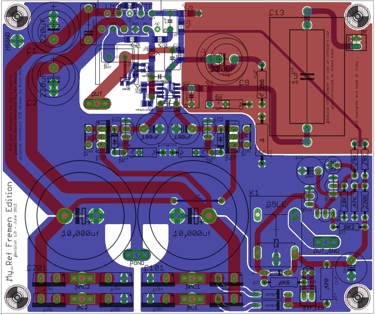

Hi Jac,
I do agree, at the moment the only mods to the initial RC design I'm quite sure of are the cutout to better isolate C14 ground return and the use of a through hole part for C10.
And you are keeping the new heat sink ground pad -correct?
Sure. I Forgot it...
I'm planning to put some text about it on PCB... it shouldn't be used if the heatsink is part of chassis (and thus probably connected to safety ground).
The most recent layout:
It's also larger (0.5 cm) than beta boards.

Due to (temporary) health problems I wasn't able to work on the test build today, maybe tomorrow, we'll see. Since the basic question about C14 was answered I would have no problem if Dario now decides to go ahead as planned with PCB manufacture. The PCB is pretty OK as is.
I wonder why you and I and Bill are the only ones on the thread that use our portrait next to our member name. We should encourage more participants to share.
Fine
But some other small changes are still possible, we'll see.
