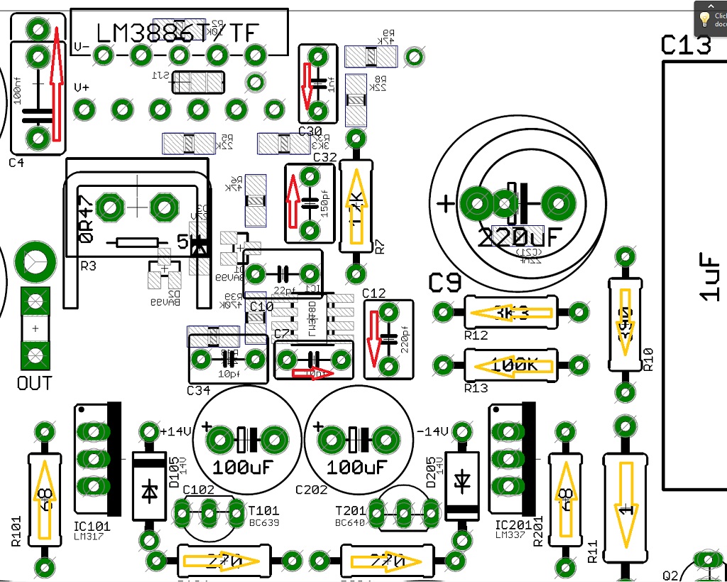

I'm still refining some choices but so far:
C30 became again a FKP2 or possibly a KP1830
C7 will probably be a KP1830
PS and input shunt resistors will stay TH, Caddock MK132.
I've spent a lot of time determining parts best direction (if you don't trust it, simply ignore this part) and, while subject to change, you can find attached what I've found so far.
I've finally managed to try Audyn True Copper input caps... they sound fantastic, as detailed as Zn with added musicality and soundstage depth.
They'll be the recommended cap for top performance, Zn for high performance and I've found a cheap cap that, while inferior, is balanced and good sounding (Vishay/Sprague V-730P/V-735P) for tight budgets.
I've updated the PCB (preview attached) to suit this choices:
Is there any interest?
- SMD input and feedback resistors
- Changed LM318's compensation components to 0805 SMD format
- adapted the input cap to accomodate True Copper/Zn/V-73xP
- created a library with Caddocks resistors (MK132, MP915, MP930)
- Output resistor is now a MP930
- Shunt PS resistors are now all Caddock (MP915, MK132)
- Shunt input resistor is now a Caddock MK132
- increased space between ground planes, pads and traces to ease manifacturing.
- PCB now supports directly Rev A, B, C, alternate compensation.
