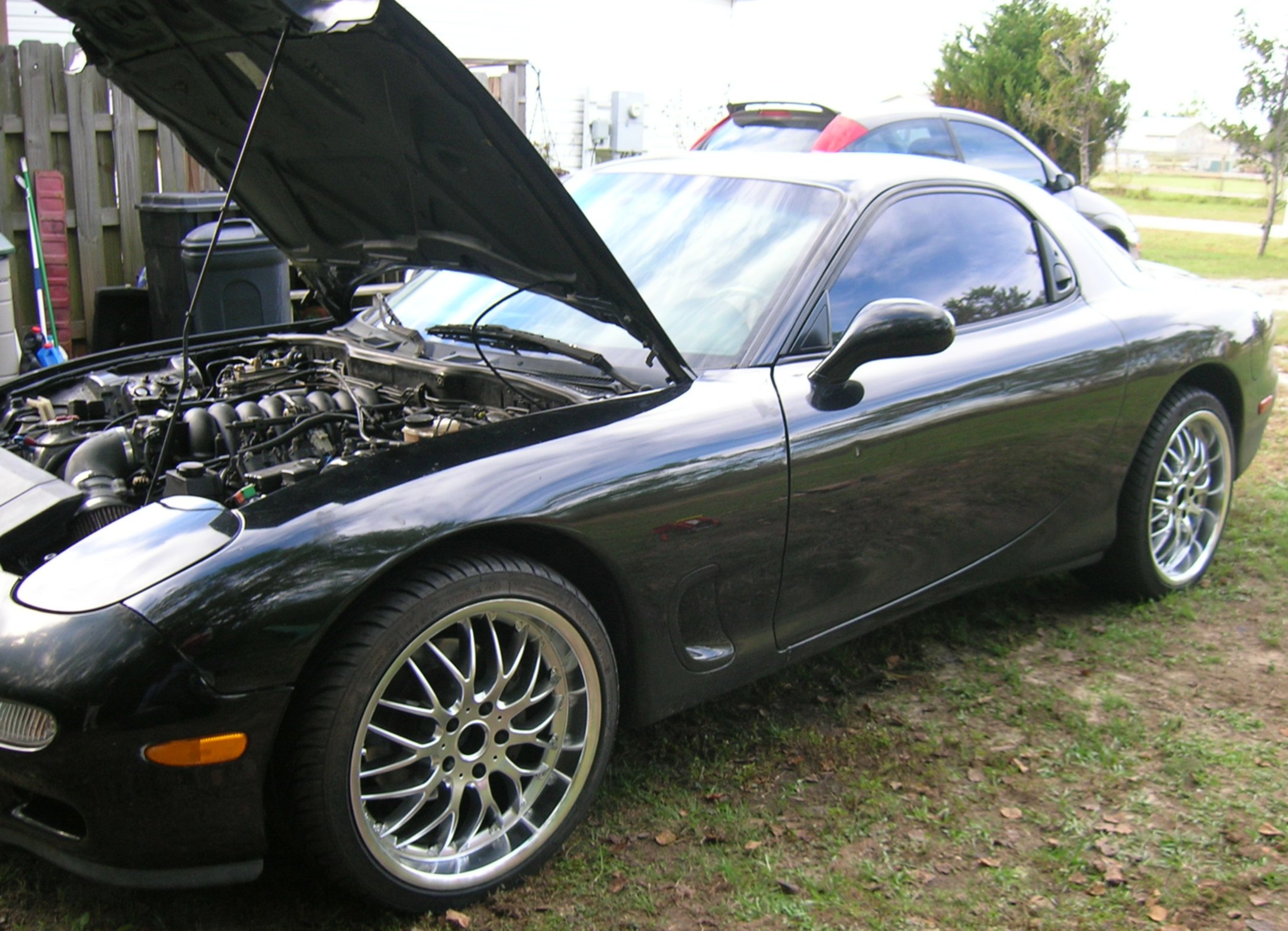

She want's me to sell my LS1 RX7 because my receiver project is over $500 ! Geez, her new flooring was almost $1200 ! BTW, Dario was telling me a way I could use my old My_Ref C in the 7 to power some big soft domes.

What year model is that? If I recall correctly, that style started in 86'?
It's a '93 FD , they made FC from 86 to 92 and then made these from 93 to 01. The car hobby is my first love, and video games. I'm into computers too, case modding and overclocking. That hobby makes me want to do my own amp chassis instead of buying one. Overclocking is what made me ask Andrew about extreem cooling a chip amp.
