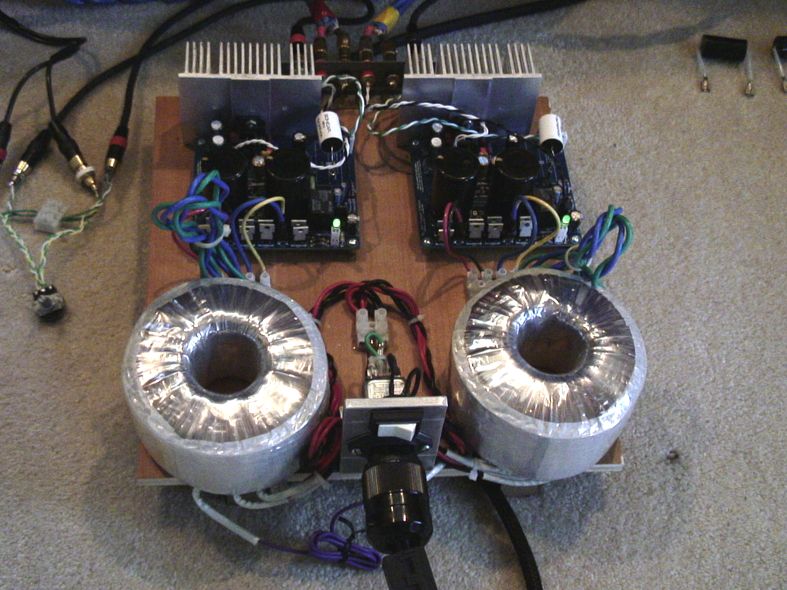

I modified the slip-on heatsinks I bought for IC101 (LM317) to work on R3. My boards are now populated so I just need to attach heatsinks and hook up Trafos.

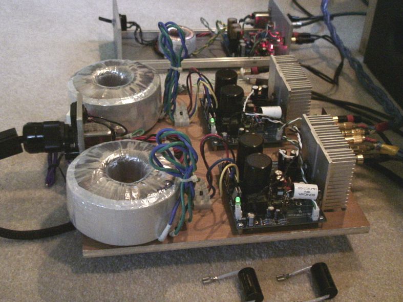

Here are the FEs with the new giant Antek 300VA toroids. Listening now to a live Reno Big Band album and the sound is simply gorgeous, powerful, unrestrained in any way.
Tomorrow hopefully, some more Caddocks and a trial without C102/202 will happen. Still comparing ZNs and Sonicaps with sockets.
That's the Mini2496 DAC with Dario's up bump in the background.
Here are the FEs with the new giant 300VA toroids. Listening now to a live Reno Big Band album and the sound is simply gorgeous, powerful, unrestrained in any way.
So the bigger toroids are a worthwile improvement, right?

If you have at hand some FKP2 swap the FKS2 with FKP2, after last tests I feel those are the best available ones for those positions (best are the out of production ERO KP1834 I've sent you for C7).

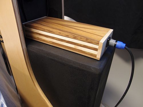

I've had a look at your thread... impressive, you've done a very good work with the case.
Thank you Dario, I plan on using some similar design elements but with a few new tricks. And im thinking mono blocks..........
Yes, the bigger toroids add a tad more power but most remarkable is just the solidity and the feeling / impression of a relaxed effort to produce big dynamic changes. A 200 might well have been enough, but no way am I sorry I got these.

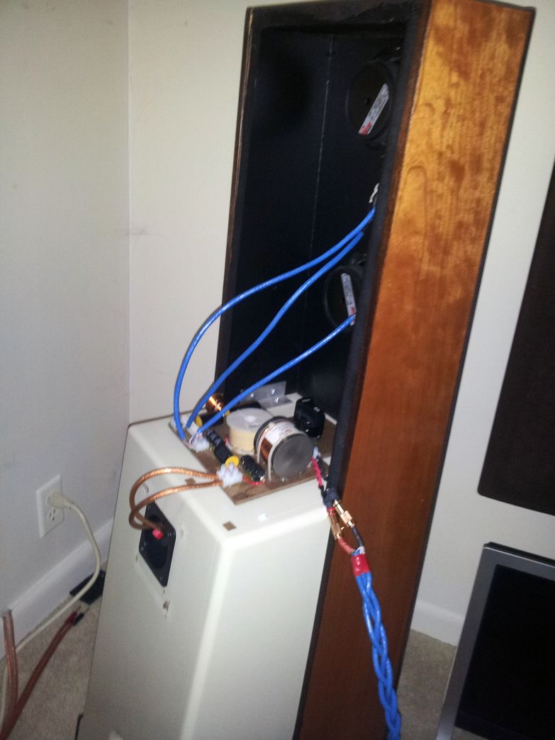

Like SoIL4x4 I'm also considering mono blocks. They could be placed near or on the speakers like Sunflower builder Jason did with his crossovers. My XOs will go back inside after tweaking, leaving a sopt for the FEs.
(speaker wires comming out of the wall on floor are for using the SFs as fronts for the 7.1 HT system.)
