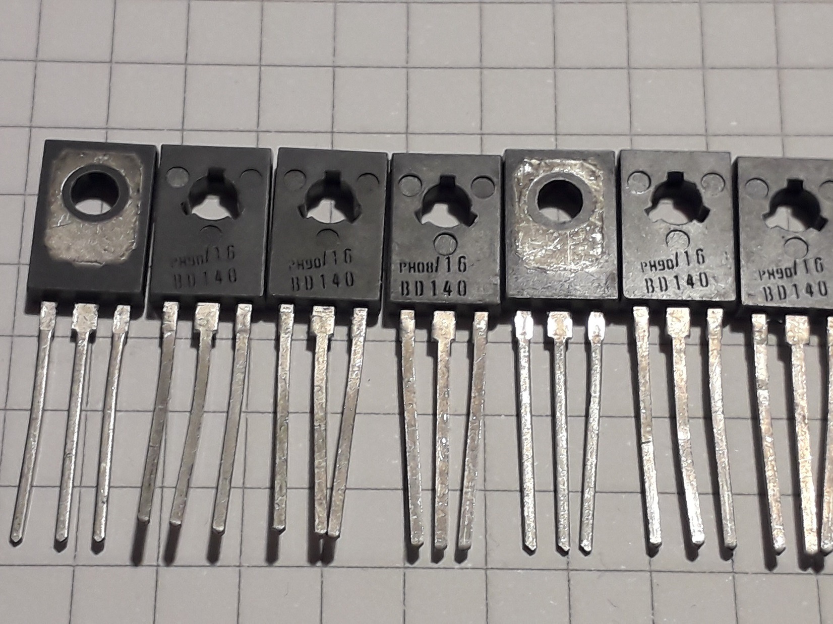

I did tested them they're PNP bd140(hfe 360) and NPN bd139(hfe 260), but there HFE values are very different and not as per datasheet from philips .Would an NPN and a PNP ever have the same production code? Have you actually measured them to see if they at least are N and P devices?
There HFE values indicates that they might be fake or counterfeit
I need to know about original die size, not and marking on the case. It would be helpful if you or someone who have the such information about die area and size of bd140 bd139 in picturesHere is a picture of NXP BD139 sold by US seller.
I correct myself, I did not see the spot into the bigger square which I thought was the die de-soldered.I see the die is not such a very small one, and looks like original.

No,I think the issue raised here is obvious fakes which are marked NXP brand but are obviously not NXP brand. The photos show they are marked NXP and the photos also clearly show they are 100% fake.
The real issue is trying to buy NXP, attaching Philips reputation to that, and then trying to source that specific manufacture device, for its mystical qualities.
In this case, BD139/140 which are still produced by 2 major manufacturers.

Nonsense. Someone posted pictures of devices clearly marked "NXP". Those devices are clearly fake and are not made by NXP or any reputable manufacturer for that case.
That is the issue: https://www.diyaudio.com/community/threads/my-transistors-original-or-copy.82638/post-6934869
The pictured devices are not STM, not Onsemi/Fairchild and most certainly not NXP even though they are marked NXP. They are the typical fakes from the typical fake vendors and contain a tiny/microscopic small signal transistor die with much lower current capability than a BD139/BD140. Hence the abnormally high hFE at the low test current of the meter.
If you want STM go ahead. But it should be marked STM not NXP.
If you want Onsemi/Fairchild go ahead. But it should be marked Onsemi/Fairchild not NXP.
If you want UTC go ahead. But it should be marked UTC not NXP.
If you want another vendor go get what you want. But don't mark it NXP. And don't try to confuse the issue with a claim of mystical properties for one particular vendor.

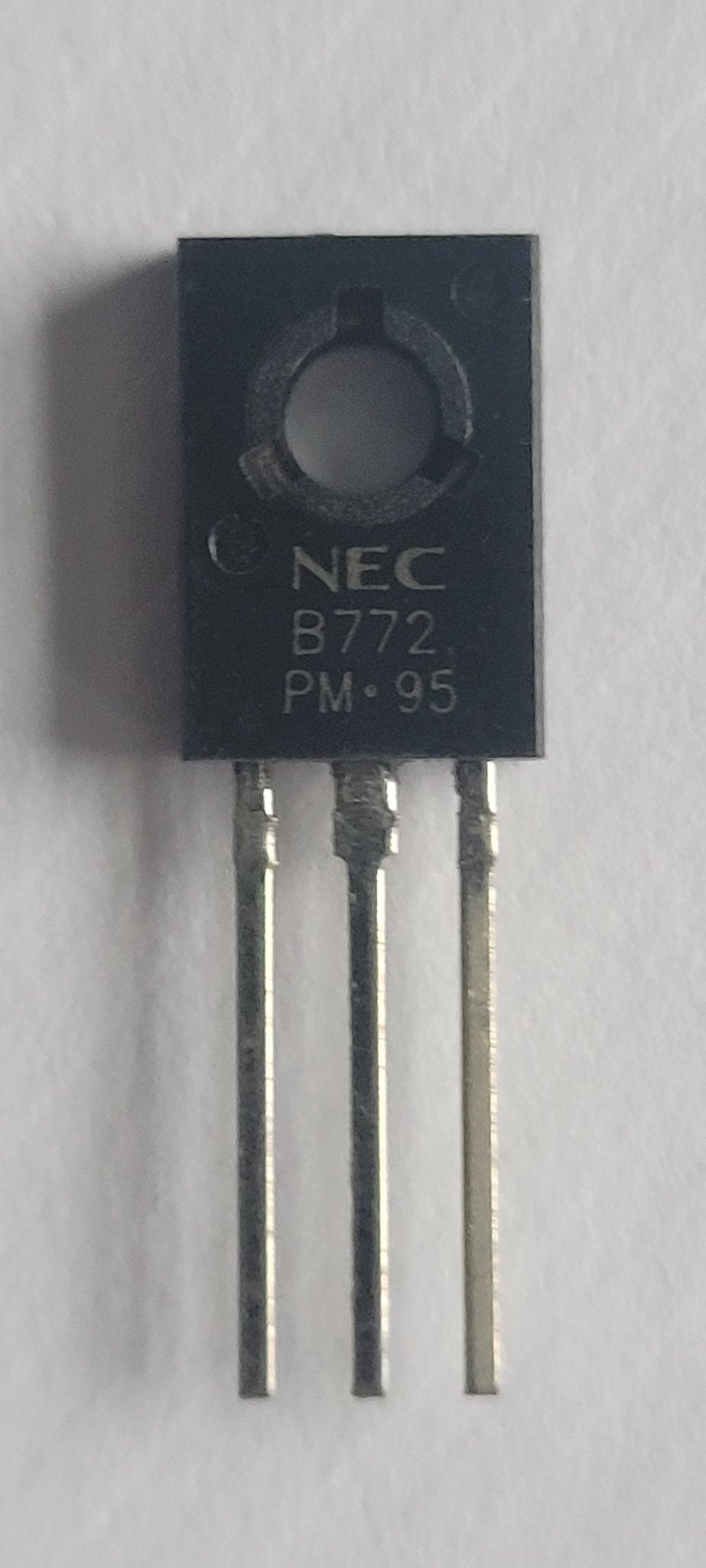

BD139 and 140 can measure high HFe at low collector current and low Vce., and in some cases can appear to exceed Hfe bounds by maybe 10%.
More than that 10% is perhaps suspect
Agreed.
I also have posted about some NEC which look to me to be real, but I doubt.
No response at all lol. Maybe they're real and I'm the only person to have have a lucky buy on eBay 🤣
B772 and D882, gain and capacitance seem to be nominal, and they don't have the "PM 95" batch code, which I have seen everywhere so I assume is one recycled continually on counterfeits.
See below for suspicious "PM 95" date code that seems to be everywhere

Issue being fake and counterfeit.
Their marking and fonts don't match up with original devices from nxp Philips.
I knew the moment I opened the package at home that I got fake or counterfeit transistors, that's why I opened it up and posted it here.
My original and genuine intentions were to get information about the Die size and Die area for the original bd140 bd139 devices, regardless the manufacturer and brand.
But sadly they pointed out only devices being faked, and marking dubious.
Still No one seems to provide information about die size or die area.
It would be helpful if you provide information about die size or die areaThere is only Philips BD139/140, NXP did not produce them.
This is what the originals look like.
