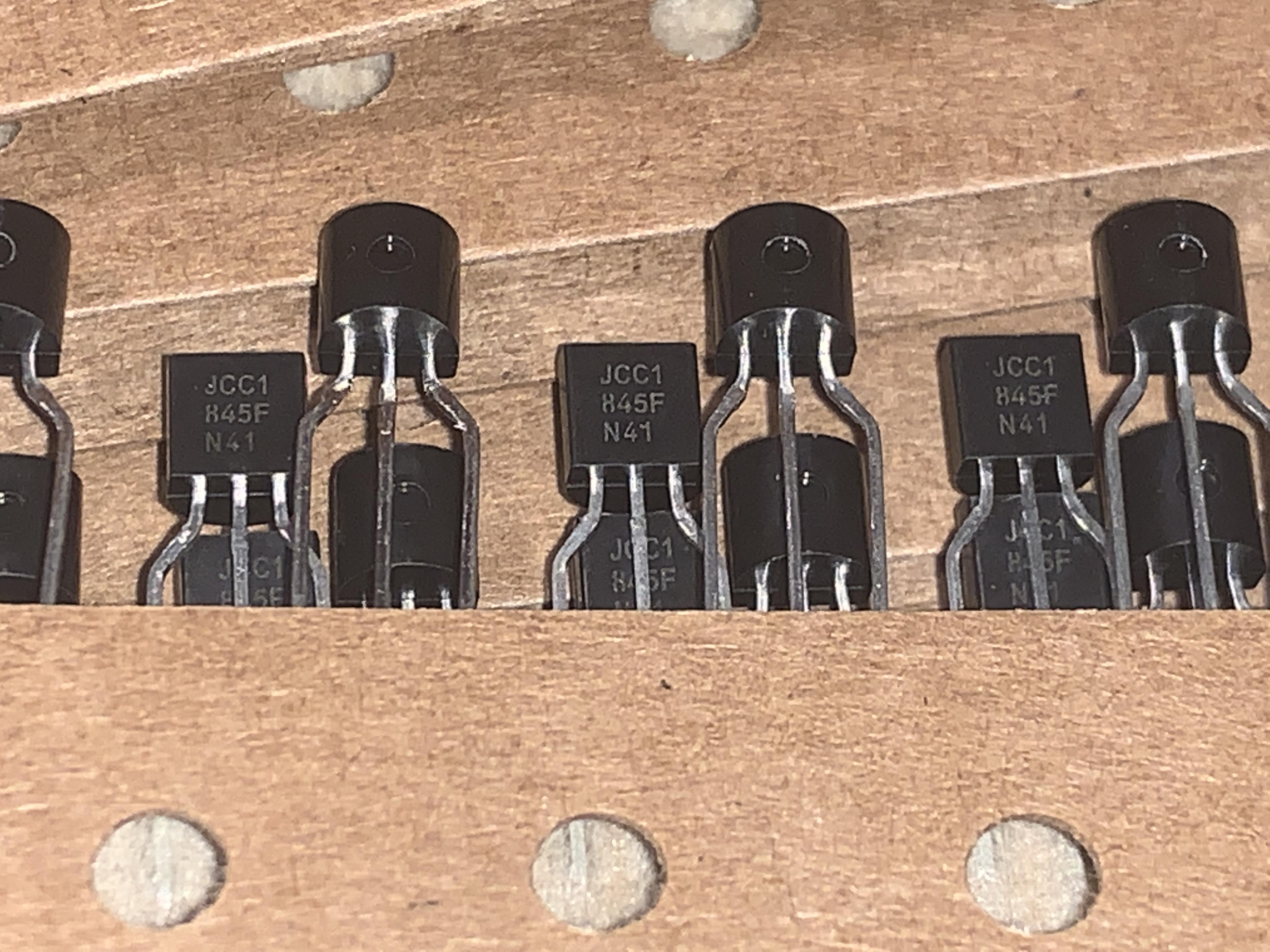

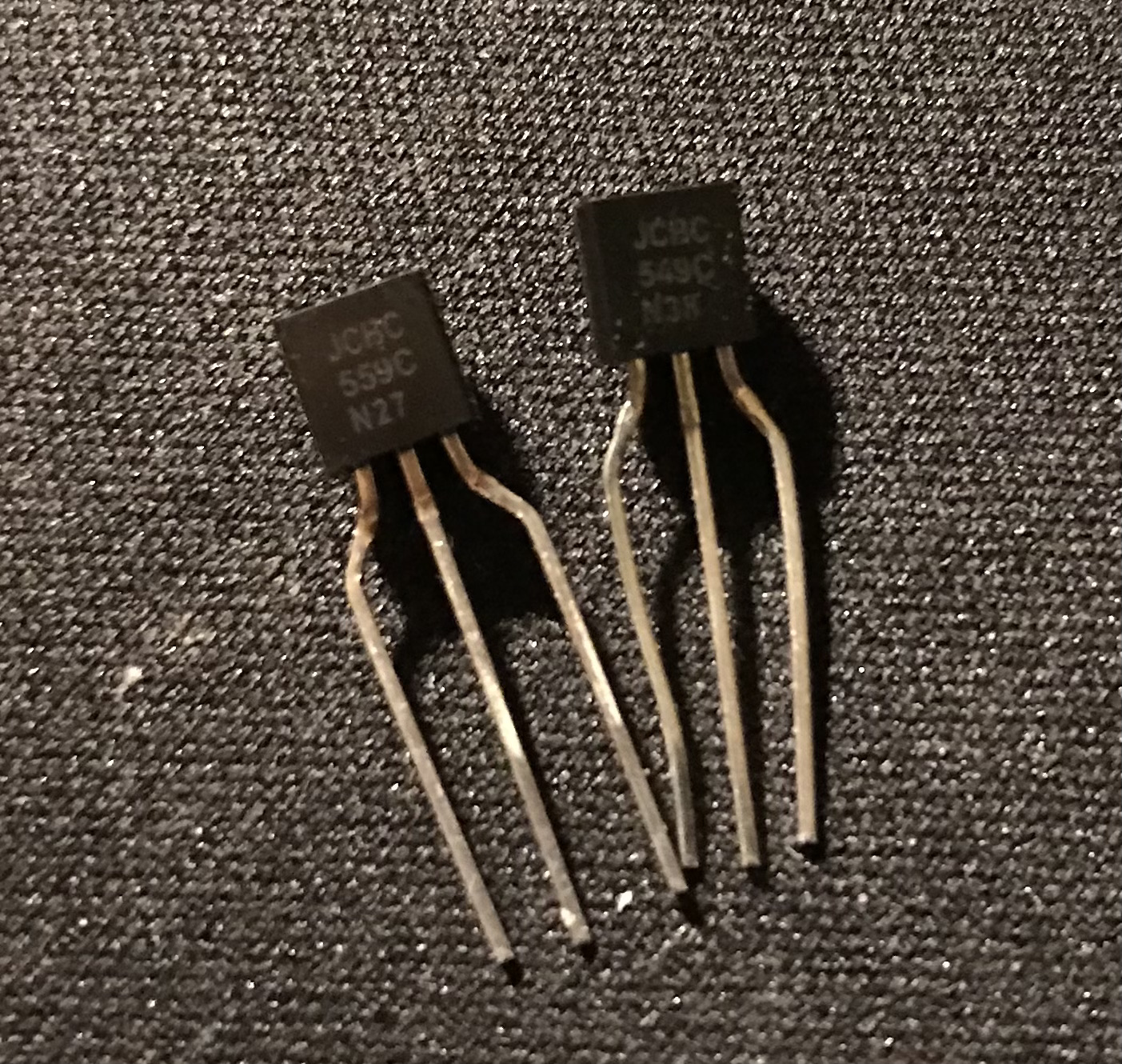

Does anyone else have Onsemi BC549/559Cs that look like this? I have never seen the "JC" before the transistor type, none of my other Onsemi BC549/550Cs look like that. I purchased them from RS-Components, so they should obviously be original. Were these packaged on a different plant / by a different subcontractor than the majority of these parts sold? I am just curious.
These must be a certain batch (Ausulover says they're genuine, but please be aware that RS also sells CDIL generics, I have neither the experience or confidence to contradict what Asus lover says)
My recently purchased On Semi BC559CTA do not have any prefix codes, batch code is a suffix.
I presume that OnSemi and other OEMs are changing batch markings much more often now, to combat fakes

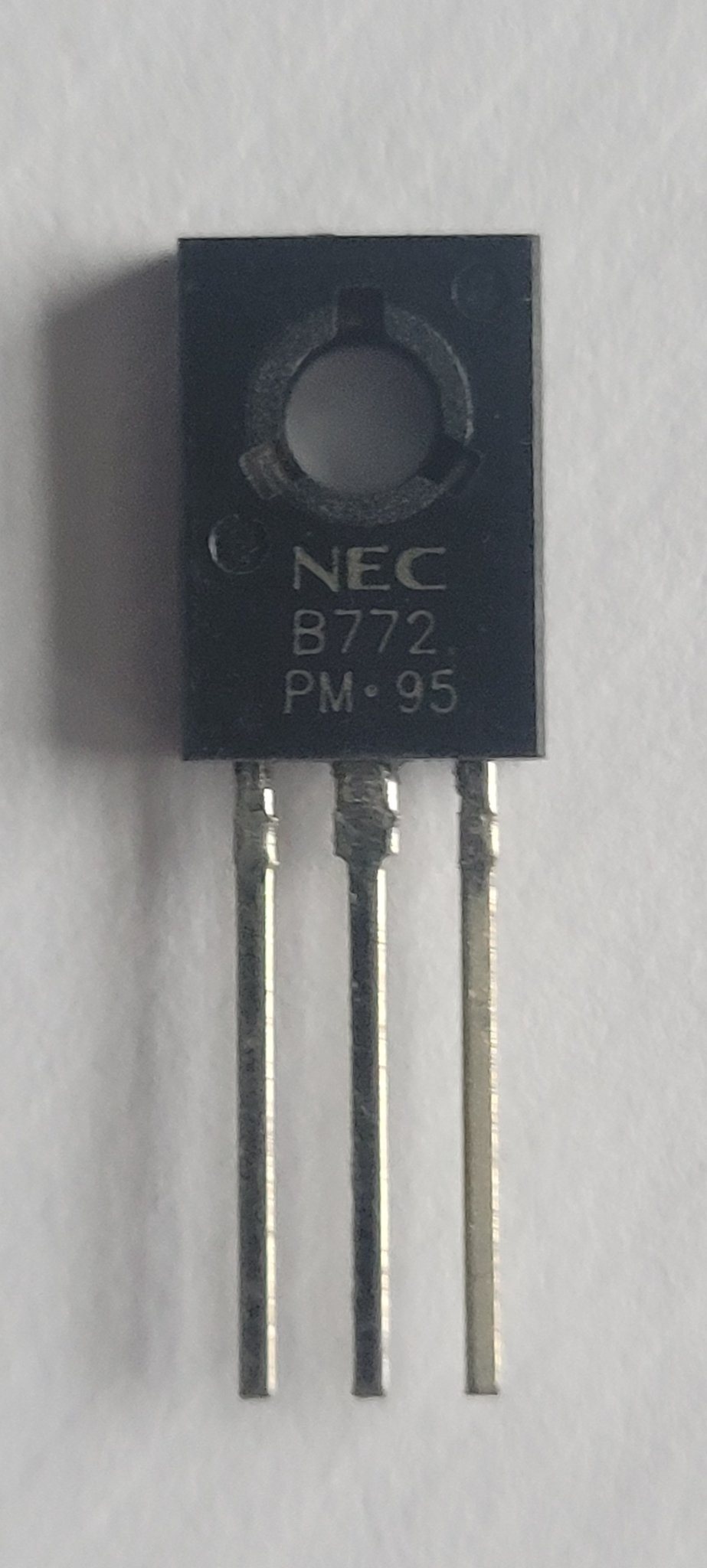

Here's an odd one for discussion if you will.
I ordered some B772 BJTs, judging by the sellers photographs, these were generics.
They were cheap and I wasn't expecting much.
A month later and I start to think they will never arrive.
They arrived today.
They do not match the photos at all, and are actually marked as NEC devices.
Are these genuine? Can it be?
They arrived today.

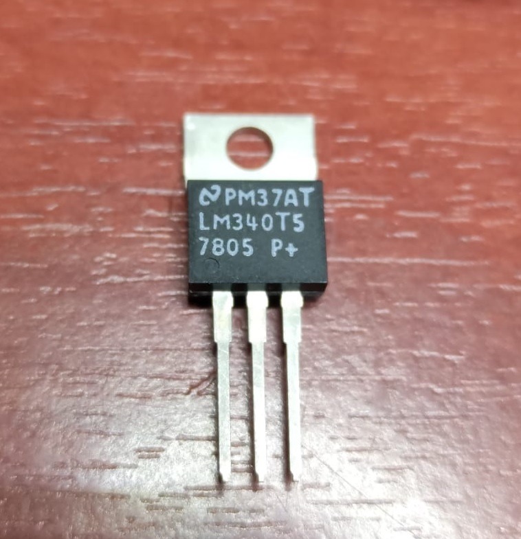

AND put out a full1.5 amp. Fake voltage regulators are usually real ones with the smaller version (78M05 or even L05) in them. Put it on a 12 volt bench supply and measure the short circuit current (when on a heat sink). At 7 volts differential you should get the full max current. Even if undersized you can’t damage these regulators with anything other than overvoltage, so SOA testing is easy.
The LM340 series has tighter regulations specs, so a 340-T5 could legitimately be sold as a 7805.
And linear VRs are inexpensive enough and demand is on its way down rather than up so you do stand a decent chance of receiving a real one.
