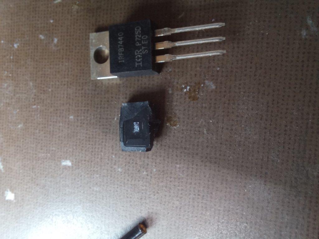

When I have bought IR MOSFETs (a variety of part numbers) on AliExpress I noticed that most of the n-channel part numbers measured the same regardless of the part number. (Capacitances, as one example.) As if they bought one large batch of one part number and then labeled it with many part numbers. In some cases the device was larger than what the part number indicated. In most cases, however, the device behaved as a semiconductor die much smaller than indicated.
The p-channel devices all measured much smaller than they should have given the marked part number.
So if you are playing with an Arduino and want a MOSFET to turn on a relay that is one thing. But I would not buy them for SMPS or for any audio purpose.

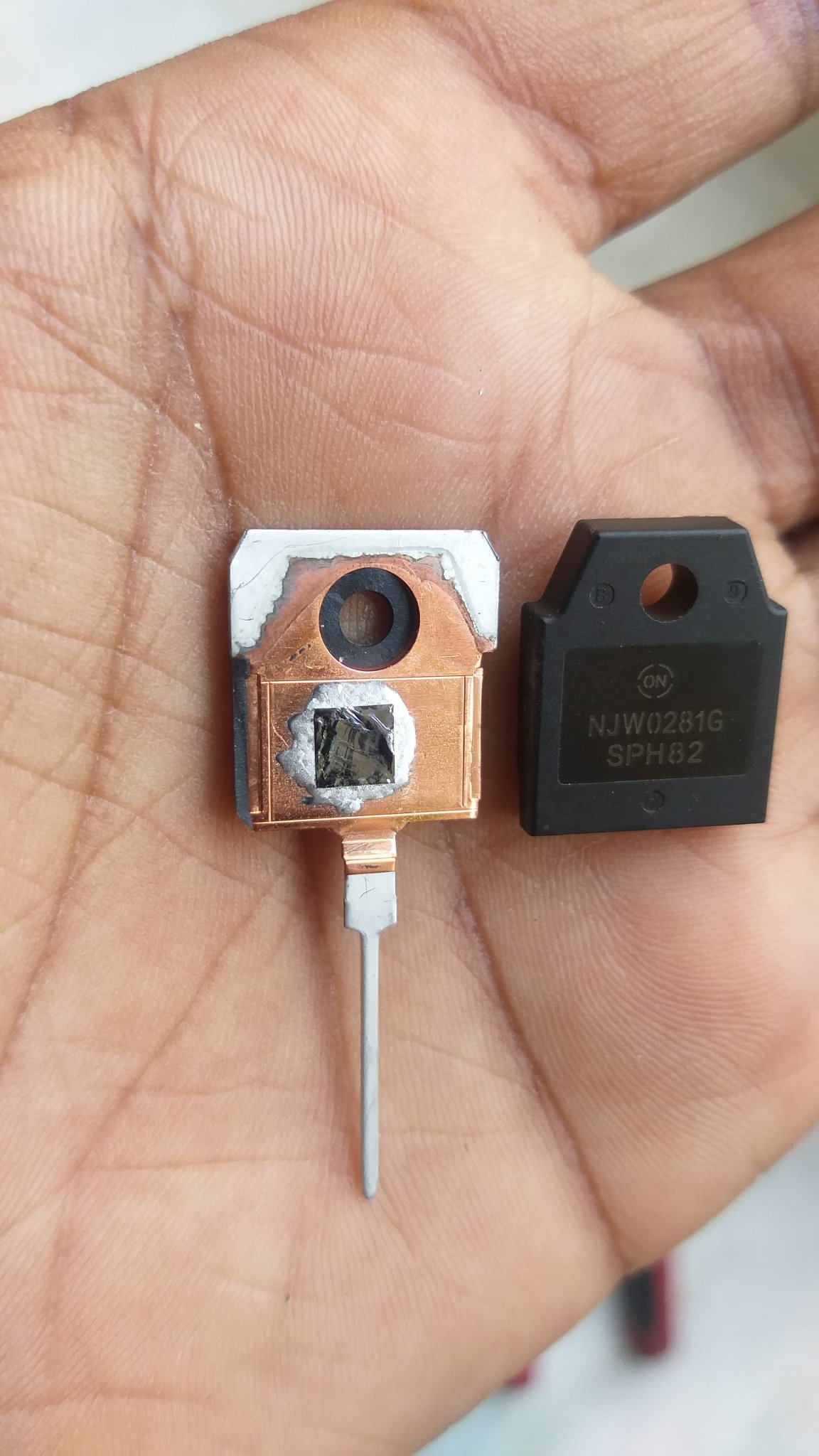

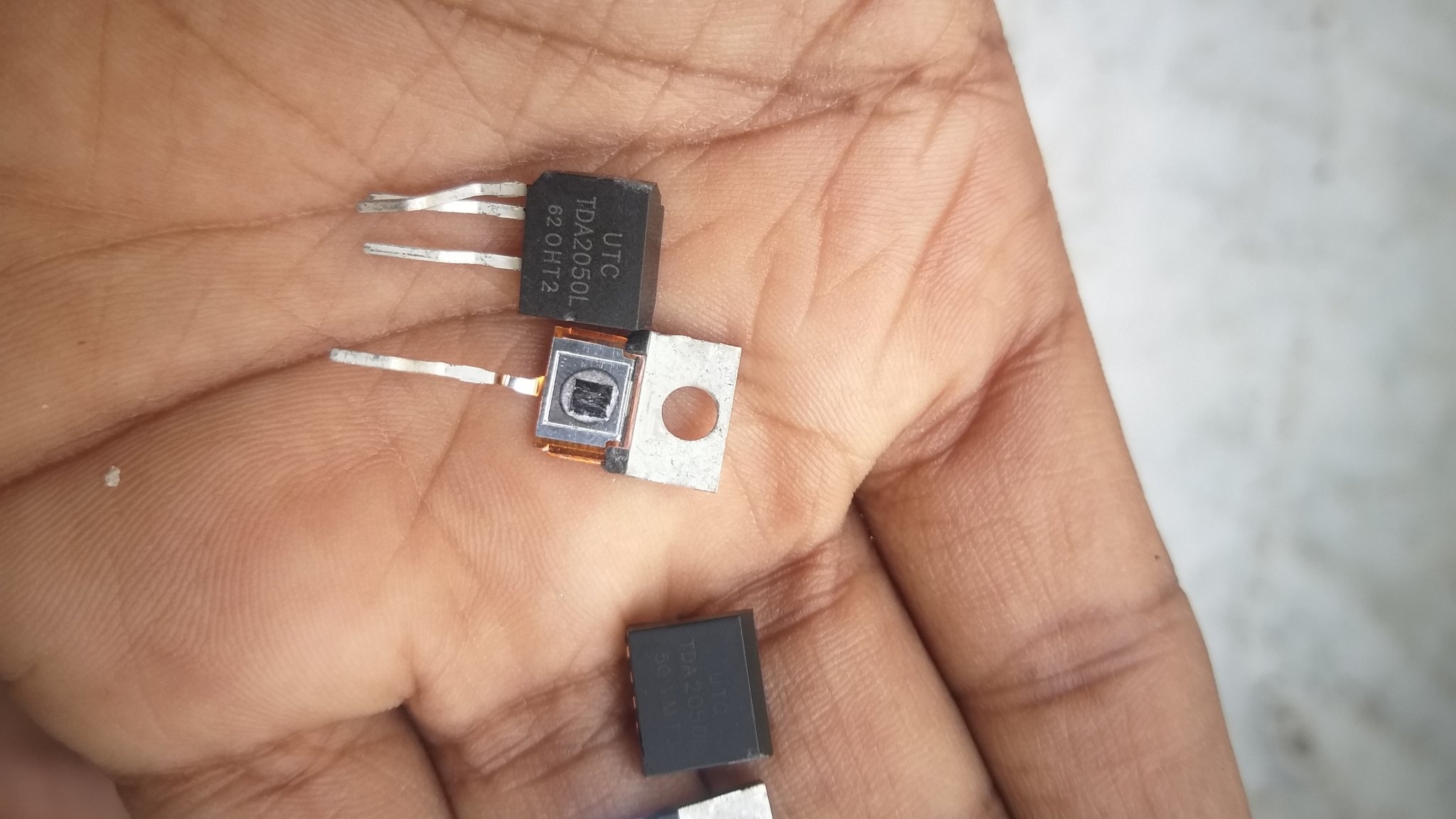

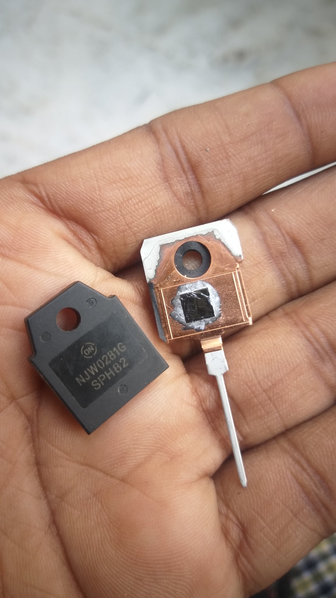

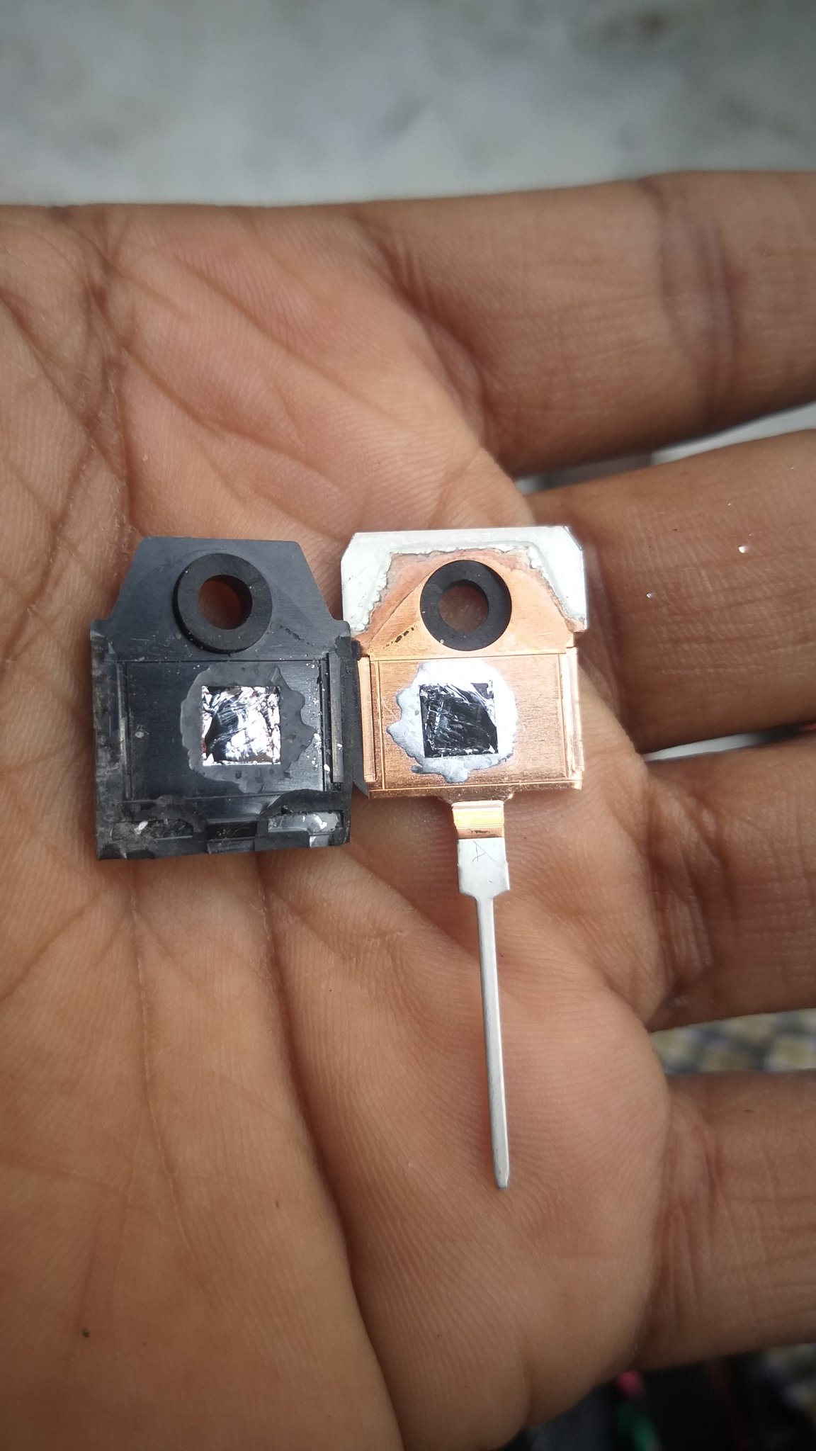

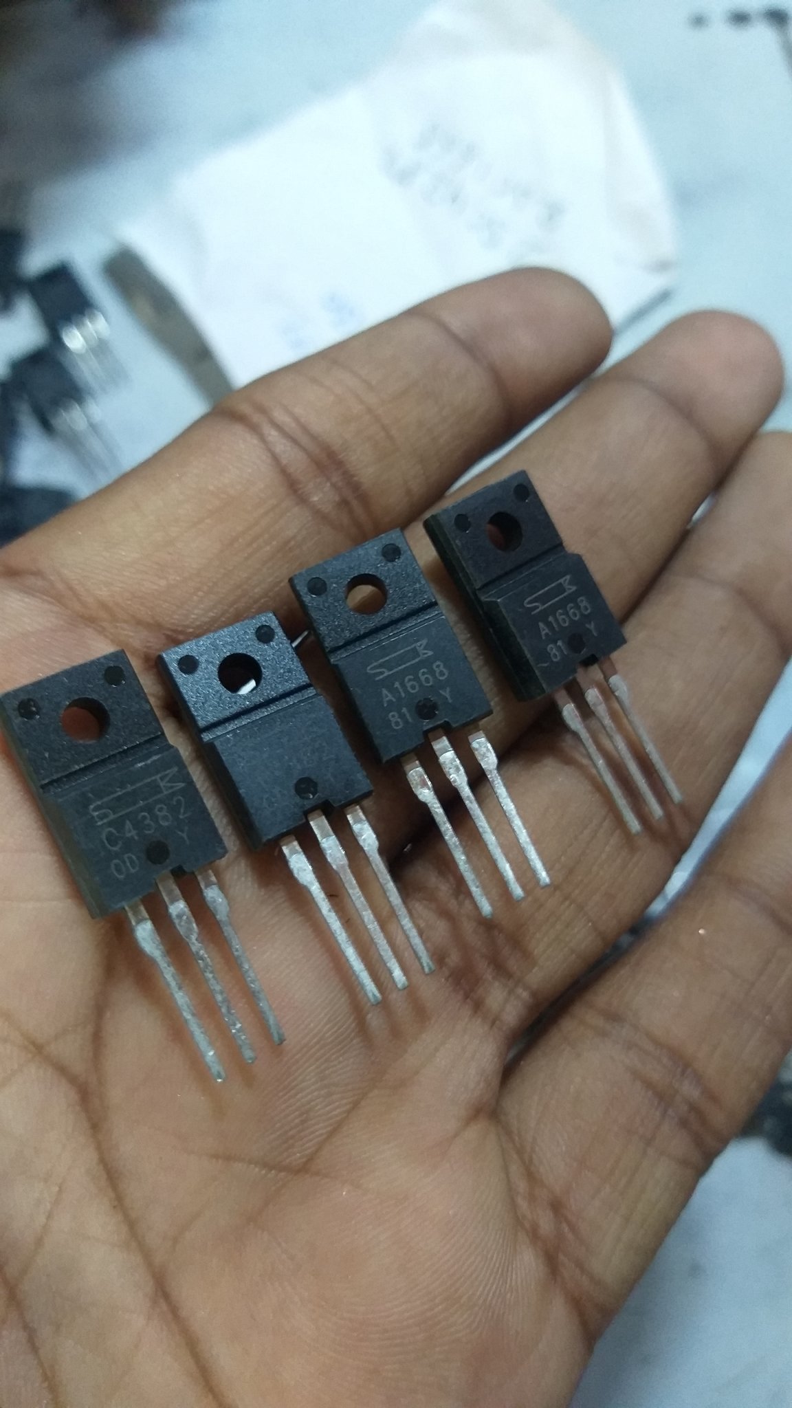

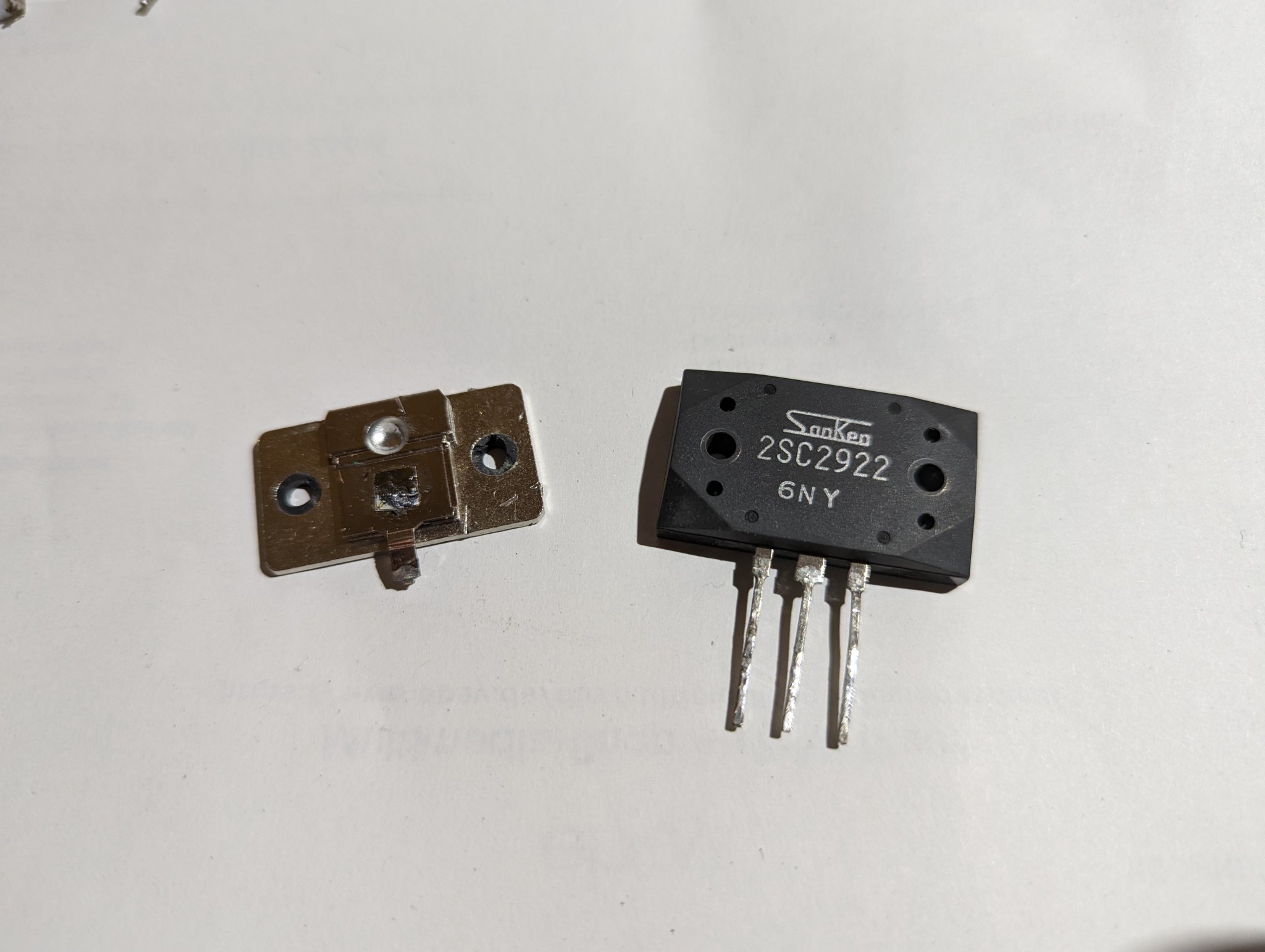

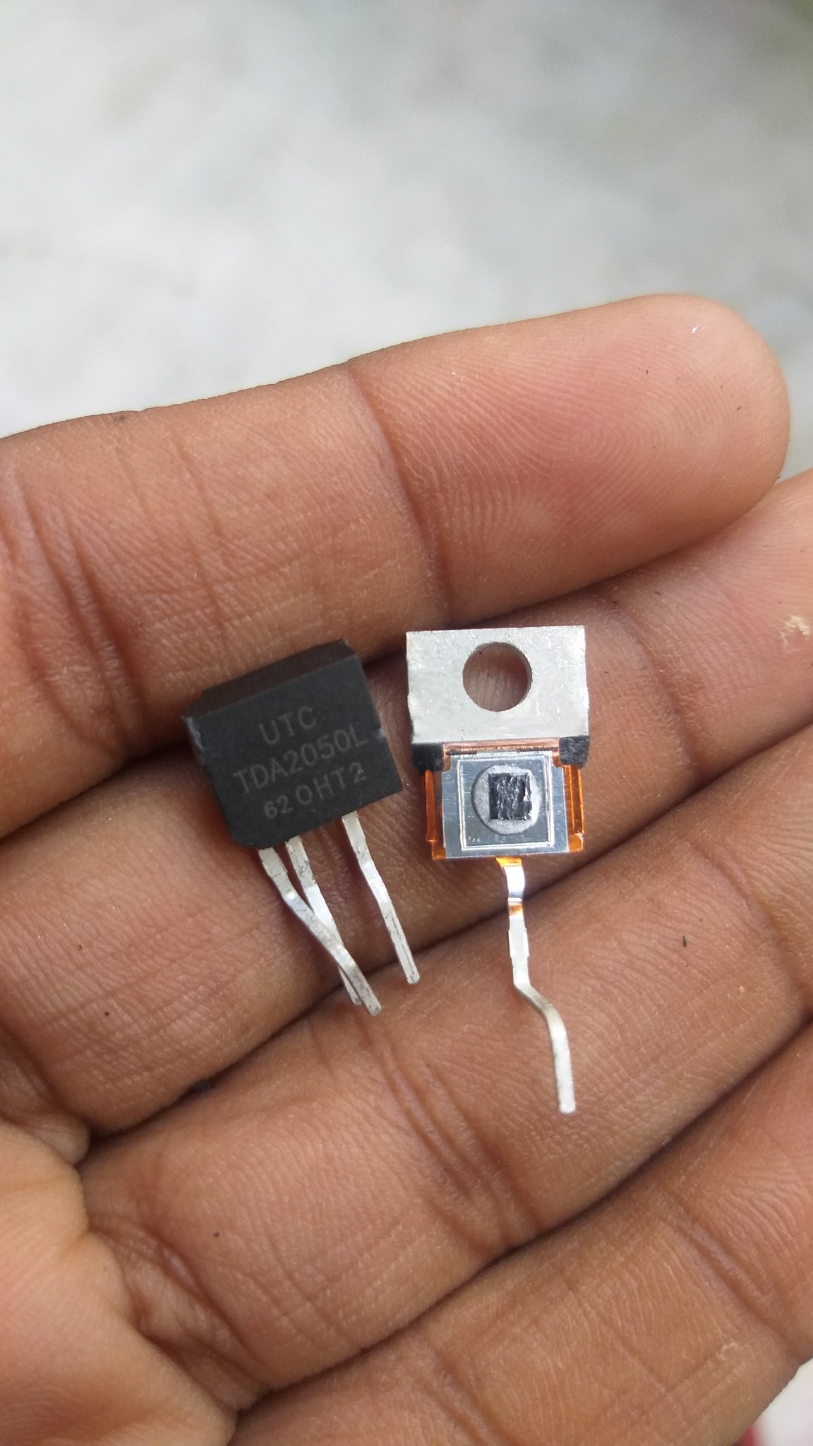

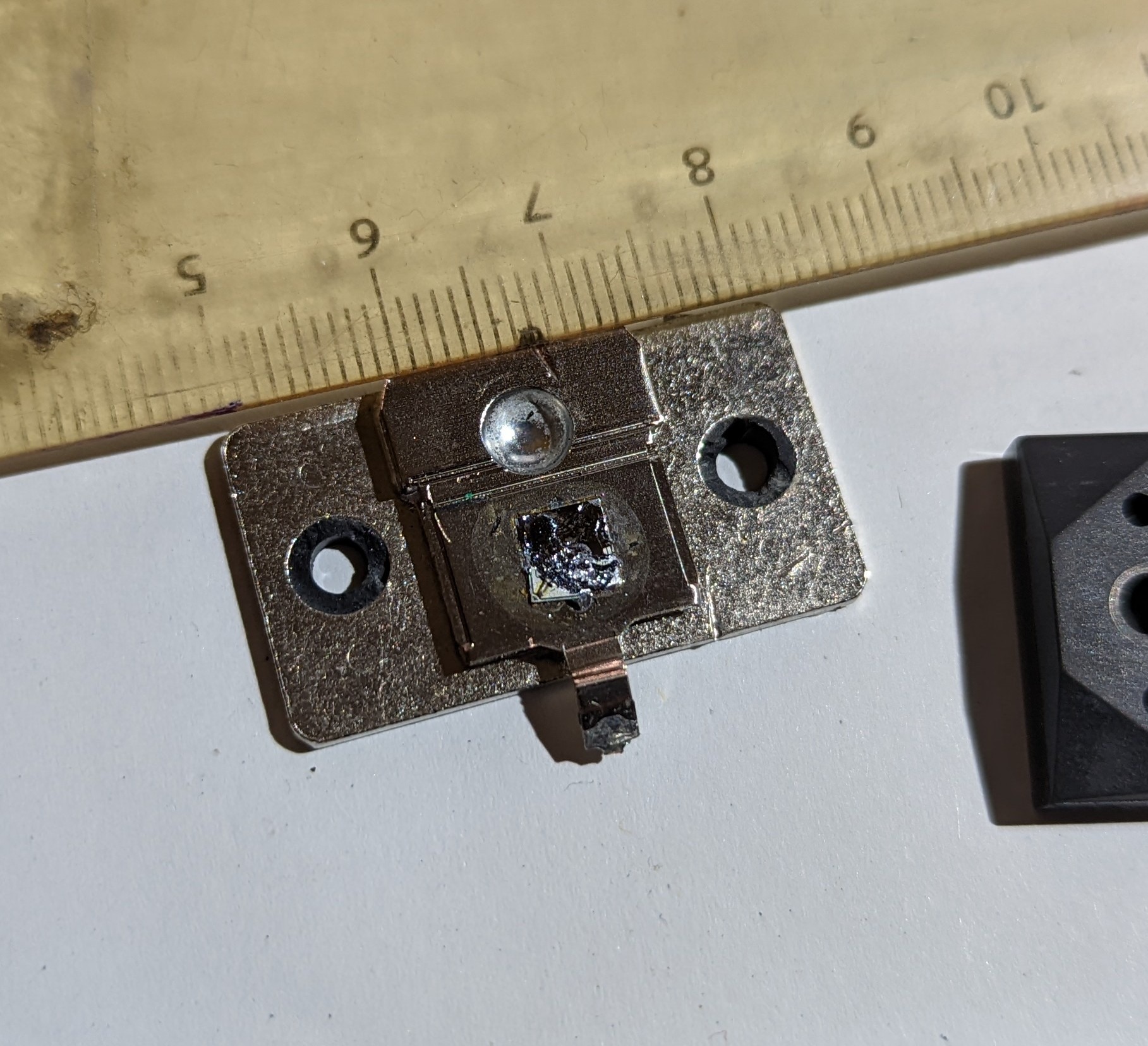

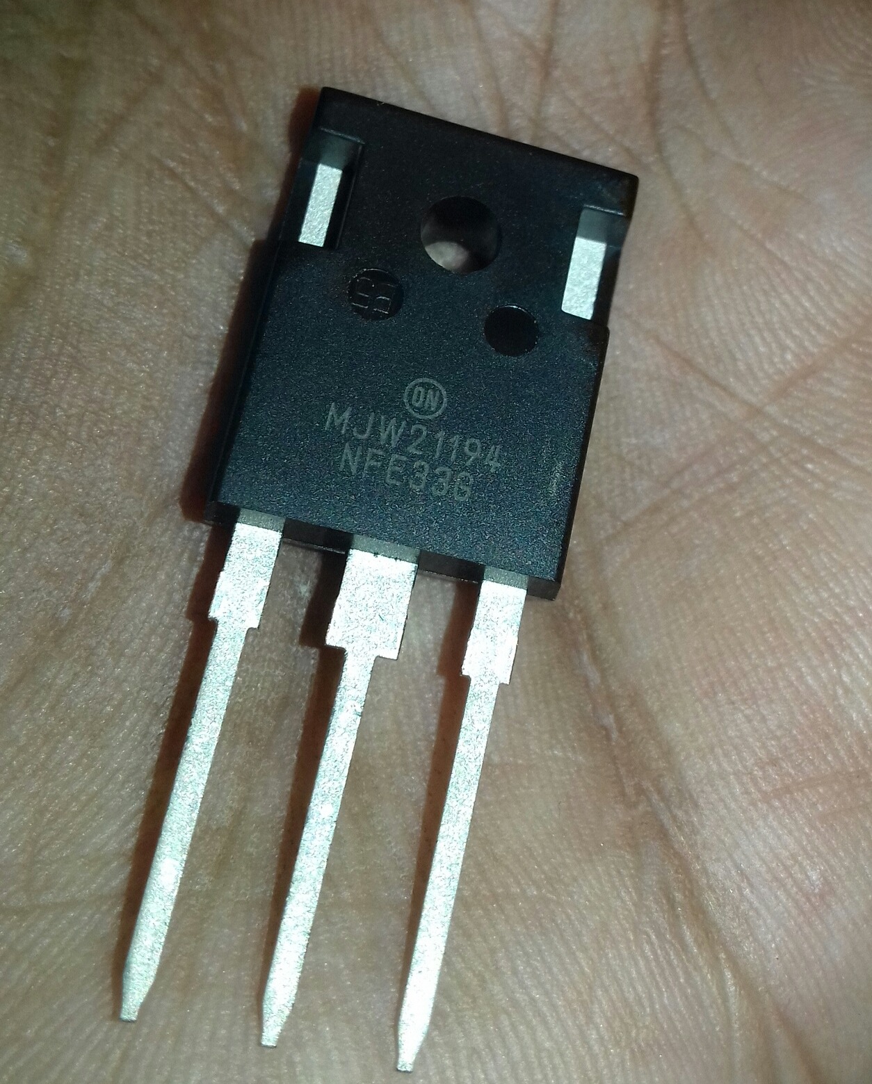

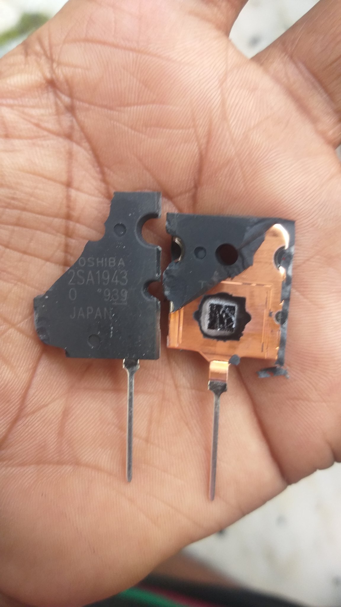

Do they have some white silicone rubber thing on dieSome MT-200 devices out of unknown source were given to me. Looking good to my eyes, don't they?
View attachment 1071498 View attachment 1071499
No, everything is clean. No silicon or rubber-like mess on the die.Do they have some white silicone rubber thing on die

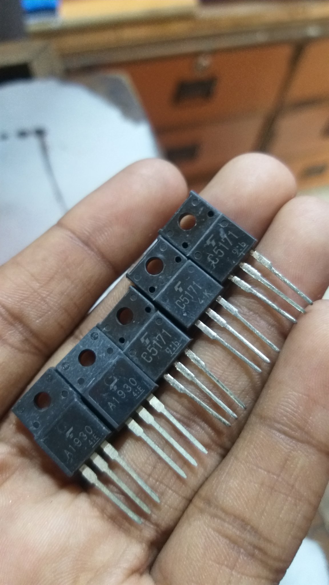

The 2SA1930s on your last picture have a slightly different package than the 2SC5171s whose packages look authentic to me. The 1930s might be DIYI semiconductor parts with faked Toshiba markings. Or maybe Toshiba changed the package at some point, I don't know.
Edit: The legs of the 2SA1930s also don't look like Toshiba to me.
Then it's just the matter of die size and die area, otherwise OriginalNo, everything is clean. No silicon or rubber-like mess on the die.
Reprinted maybe
