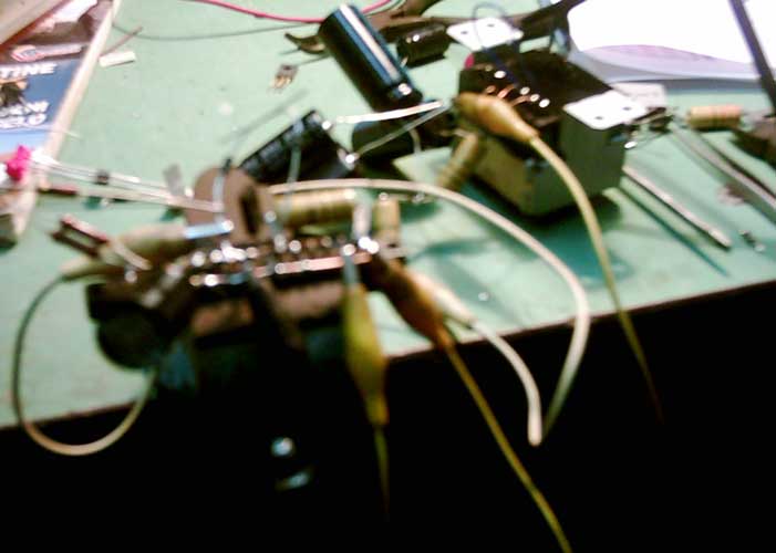

I played some more with the little wonder this afternoon.
I popped in the 2200uF's, but that didn't help. I also tried to run both channels form one supply, thinking that maybe its in the dual mono setup's grounding. You know the LM317/337 supply being one supply for both channels. It wasn't, the same buzz was there. For the heck of it, I tried it with my "Workhorse-test-BosoZ" supply, which is not excactly a perfect build. I set it up with 3x9,1V zeners. The buzz was gone, and the preamp sounds pretty good Maybe a "mini"-Twisted BosoZ supply is the answer. A board could be made pretty small with 4pcs of 50V, 1000uF electro's
Steen
Steen

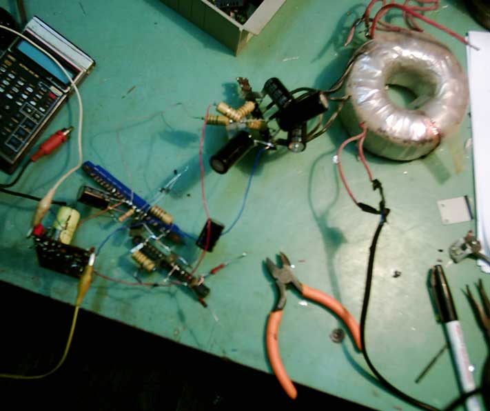

OK-now my s*ity CHokyNS10Clone in breadboard mono version sings Misery'n'Blues .........
yeah-SINGS!
without nasty buzz or anything
I have in start some bacground cookin' noise,but I found that old 250K trimmer is guilty-when I replaced trimer with resistor-everything is OK
setup is completelly on the bench-my Pioneer PD8500 feeding from hphns out (I have pot there ) to pretty much 3D "air" version of 1ch NS10,which is supplied from 2x even more airy shunt regs and they are feeded from 300W toroidal ,and I get steady 35 (x2) Volts tnx to variac.graetz is some plastic B250C3300/5000 jobie
then I send all that NICE amplified signal in my ancient DIY MF A1 bastard,and spk is from some old tube radio-oval 5x7" with muuuucho sensitivity.
differences- or not:
toroid-graetz-2x470uF/100-2x100E-2x1000uF/100-2x100E ;
I use (2x)2x12V generic 1W3 zenners,100E is in bases of both darlingtons,darlingtons are bdx53C and 54C,and finnal caps are 2x2200uF/35V
NS10 is made with one BC560C and two BC413C,100K resistors are in fact two 47K in series,10K resistors are 10K54 ,input cap is wima 1uF,output cap is 10uF MKT no name,so you can see that I didn't tried much to make one hell of a prototype-I just grabbed first from drawer without looking hard.
tonight I will post some more blury pics

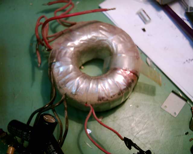

ONE IMPORTANT THING:
and I think that this is mebbe couse of all Steens troubles-
THIS PREAMP HAVE F*UCKIN' ENORMOUS SUSPECTABILITY FOR INPUT SIGNAL!
ok-now you'll say -we know that
BUT ALSO SAME IS CASE WITH ANY NOISE FROM SUPPLY OR MAINS!
you'll say the same
so-maybe best solution is to use AS MUST- GOOD RFI filter for mains
and plain EI xformer,just because toroid will put through any junk you have in mains
that's why 317/337 combo is without buzz
and that's why shunt may have some buzz,just because shunt don't have enormous feedback and 317's cappability for garbage smoothing.
but-main thing is that with shunt signal path is clearer and shorter,no matter what solution you use for shunt reg (discrete,hybrid or chip).
SO- use whatever you wannt for stab,or do not use any stab- it's free board
comments?

Good work I will try and see if I can clean my mains somehow. I think I have some of those X2 caps somewhere.
Man, that was great news
Steen
steenoe said:Yeah, way to go Choky
Steen
even better-put some surplus corcom (?) mains filter with integrated fuse
then make one decent dc blocker and gooooooood mains filter in one case for entire system
