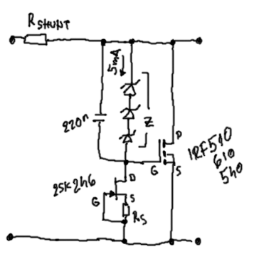

in a meantime ,you can try this:
http://choky.on.neobee.net/images/fusekiller.gif
or this (my friend Oli is also ,suddenly, "warmed" for shunt regs):
( in any case-CS will do the better job ,regarding noise etc and that is thrue for BD or darlington or even mosfet shunt implementation,no matter which sort you choose; me humble thinks (hehe) that this is sort of overcomplication,but-what the heck-if ya wanna ,try it )

Looks good ,Choky. Might be worth a shot, if the NS10's psr is to lousy for the other reg.or this
Steen

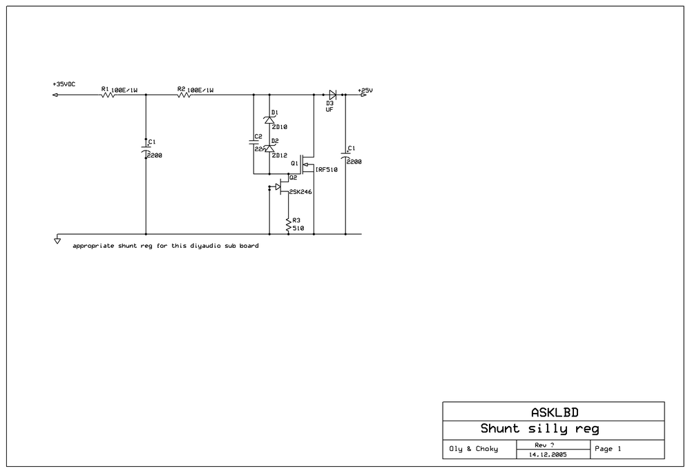

steen -while you wait fro some parts for our simple shunt with bjt darlingtons ,you can see that I'm also just walked in computerized era (see attachment) .
I presume that you have enough parts in drawer ; I don't have any spare (read -not preciouss in this moment ) mosfets or jfets to try
besides-I'm pretty new to this silly SS stuff ,meaning on construction ,even if simple shunt with fets is in case......

and what last schematics is,anyway?
I'm sorta loosed in this,tnx to PSU funnnnnnnnnn
in that case-with less caps etc,we can have both active part and reg on same board per channel,even if caps must be something bigger ,regarding voltage...
