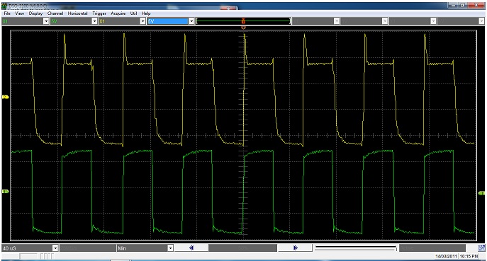

Boy do I have some cool scope shots for you :)
Pic 1 is the amplifier's 20kHz square wave output on the bottom plus the base voltage of the MJL21194 on the top. As you can see the square wave isn't too bad. But look at how fast that base voltage is moving! I zoom into the fuzzy part as much as possible (0.2uS) and it _just_ becomes apparent that there is a waveform there, but the period of the waveform is still much less than 0.2uS. So we are talking about tens of MHz oscillation.
I guess this is to be expected and is just the whole process of the CCS loop operating - sensing current, turn off, current drops, turn on, repeat, etc. But I have no idea how much you would expect to see and how much is excess oscillation. Looks neat though!

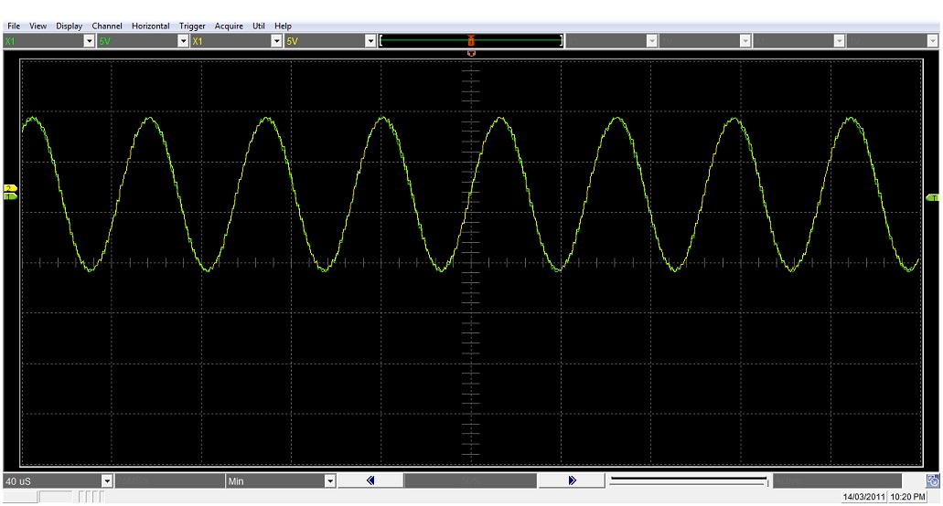

Pic two is the same again, but with a sine wave output.
Pic three is what the fuzzy bottoms of the square wave output actually are - baby oscillations. Again, very fast at 0.2uS/division. There's no way my inductance-rich lash up is going to help at those frequencies.
Anyway, as far as the design goes, I think pursuing it further with the crude construction may be pointless as it just introduces too many variables and stray inductance. It's time to make a PCB I think.

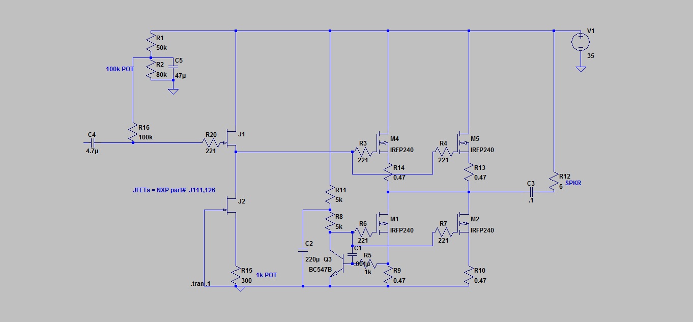

Here is how it's going so far. Attached are the final schematic and initial PCB design. PCB keeps getting refined every time I look at it, but if I'm completely on the wrong track it would be nice to have some feedback.
Edit: actually, scrap this design. I've just seen a way to improve it significantly.

Hi Greg
Final schematic looks nice. I haven't looked at PCB yet, just getting into panic mode now with the move. Hopefully back to normal next week. If you're lucky, AndrewT might comment on the PCB too.

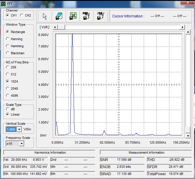

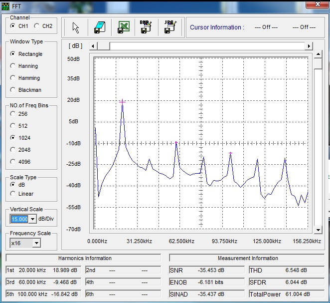

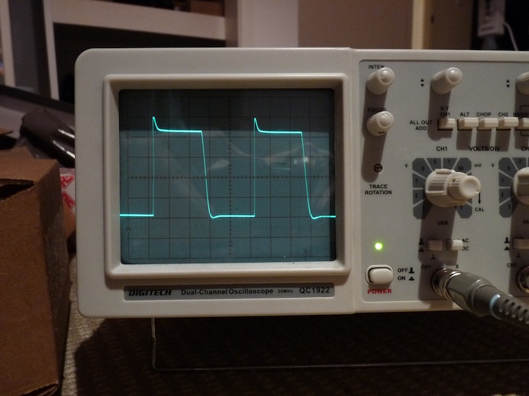

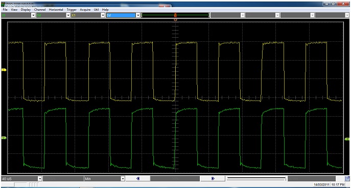

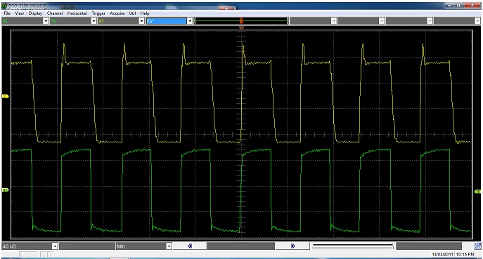

Update

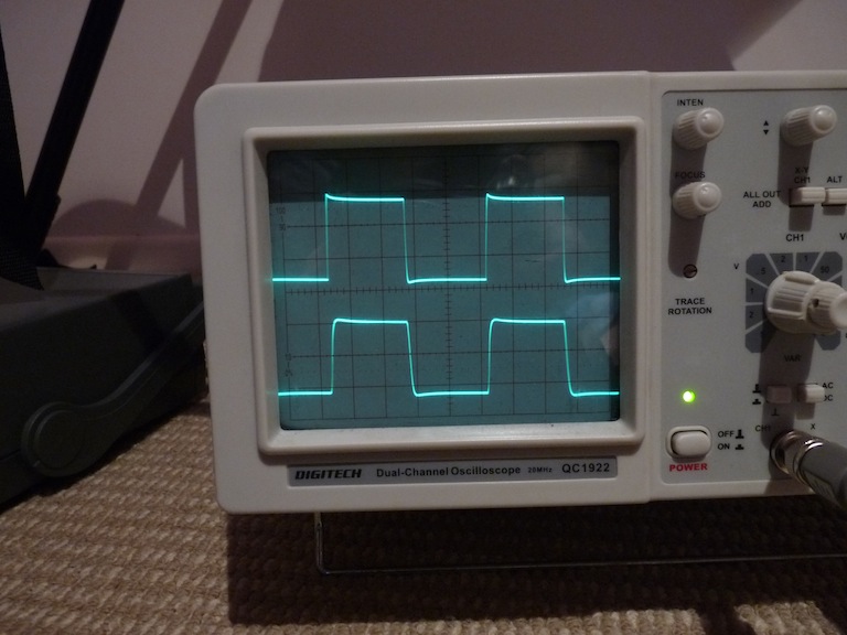

Got the PCBs back today and assembled one tonight as best I could with the parts I had available (fig 1).
Plugged it in...no smoke.
Adjusted the bias pot...output varied appropriately. Set it to just under 1/2 the rail voltage. Plugged in the sig gen and scope.
First the 20kHz square wave test (fig 2). Rise and fall times not too bad, but still quite a lot of ringing (fig 2 & 3).
I'm not overly concerned about the ringing though, as I'm fairly sure larger gate stoppers would prevent it - the waveforms on at the 240 fet gate is dirty whereas the waveform at the gate stopper is clean. It seems some oscillation is happening in the few mm of lead between the fet and the gate stopper...amazing considering how close I have them.
There probably isn't any point using larger gate stoppers though as audio waveforms would never cause this, right?
Anyway, it sounds quite nice with my little preamp. Pretty happy with it really. The treble is especially sweet sounding, but overall frequency response is very good.
It's running very hot at about 2A per device though!
