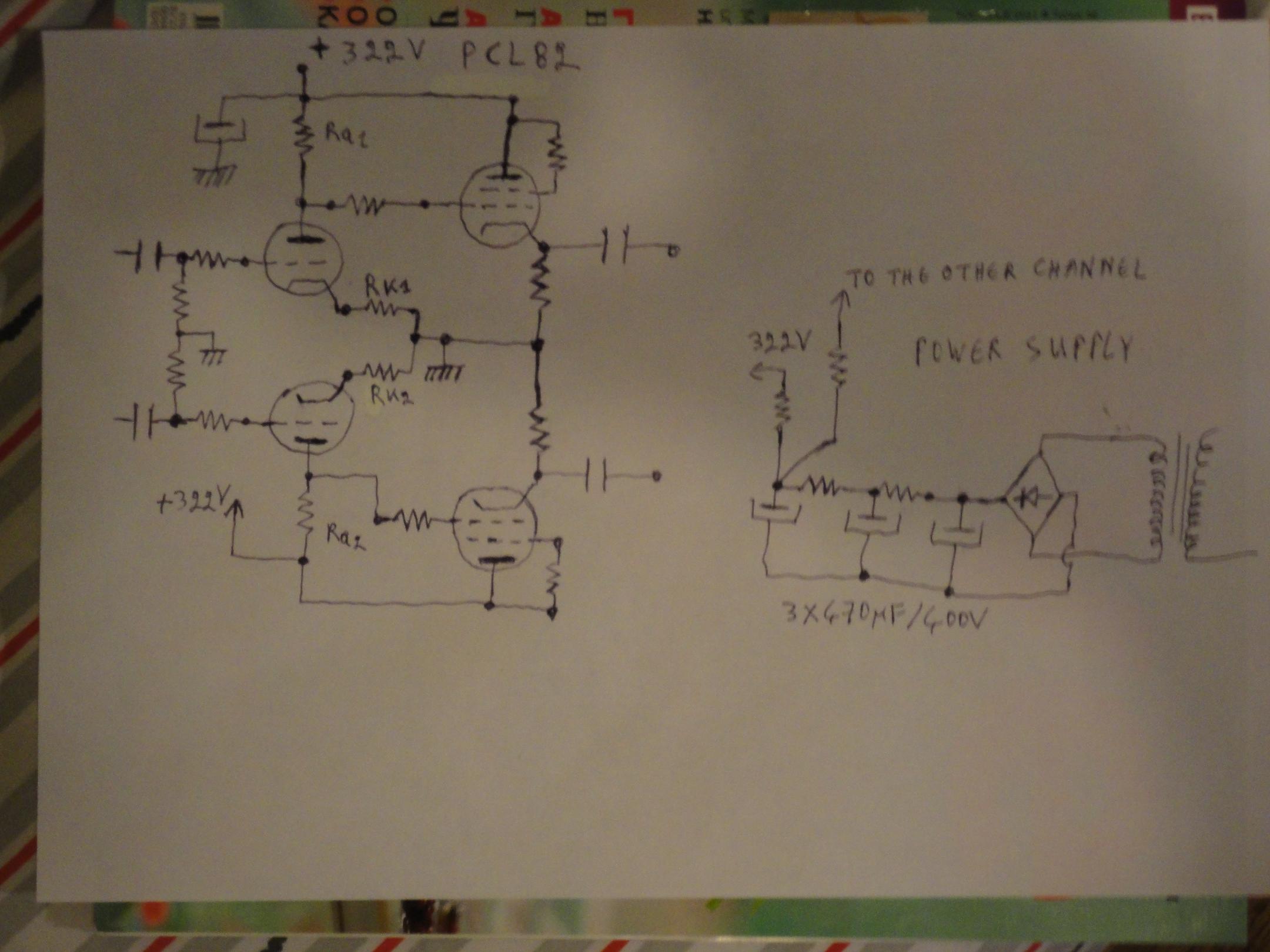

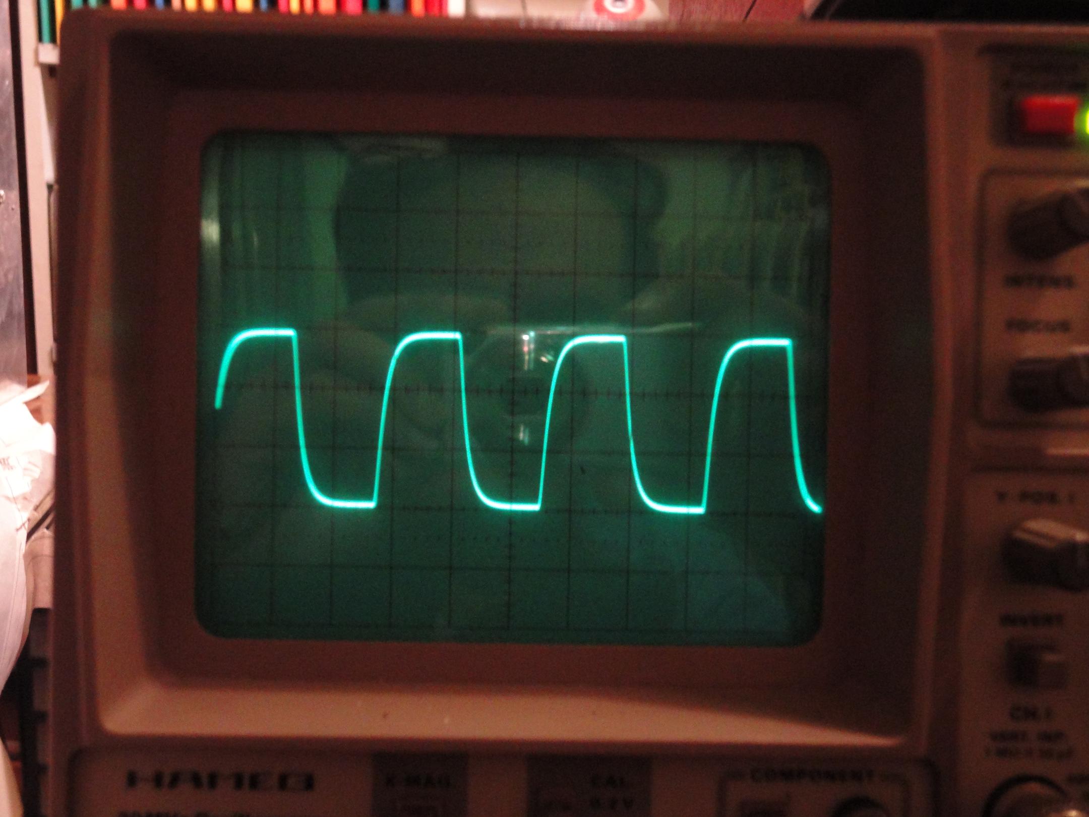

Hi Max , I think the triode section of the PCL82 is not so useless as you say , I have many of them and I decide to use them in the amp , I think this triode is the reason for decreasing the high frequency response of the amp , but it's still high 170Khz -3dB in comparing with the 195 Khz -3dB of the Futterman PL36 amp . But it sounds good with detailed sound and better bass than the Futterman , so I think I will leave it as it is . As for the overloading I will bias it a litlle bit harder as I say before and I will see what happen , BTW before I choose this tube ( PCL82 ) I was searching for the PCL200 ( it has more powerful triode section ) but I didn't find it easy as I found the PCL82 .

Hi Kay , the triode section of the PCL82 have amplification factor of 70 and anode dissipation about 1W , and the 6SN7 have amplification factor of 20 and plate dissipation 3.5 W each triode so they are different tubes , and yes the triode section of the PCL82 isn't useless at all in this we agreed , the pentode section of the PCL200 have much larger gm than the pentode of the PCL82 and of course is better as cathode follower in this we agreed too , and its cheap as you say . Thanks for your comments .
Last Sunday I make some improvements in the amp . I lower the value of the cathode resistors in the triode sections of the two PCL82 Rk1 &, Rk2 ( which is second diff. gain stage and drivers - cathode followers ) in other words I bias those triodes harder and the gain is increased a little bit , after that I increase the supply voltage from 310V to 322 V . I add one more capacitor 470μF/ 400 V in the power supply . The amp now sounded with more powerful bass , and all the other good things that it have before the improvement . Now it delivers 24 W into 8ohm load ( I have an increasement of 4 W ) after this modification . I measure the output impedance again with 1Khz sinewave at 20 Vp-p into 8 ohm load and its 1.2 ohm ( 23 Vp-p with no load ) which is pretty good .
