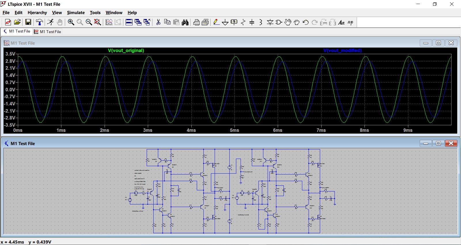

Wouldn't the gain of Q1 increase if R10 (6.8K) was removed and a resistor placed between base emitter of Q2 ? Lower value of course since the voltage across it is now only about 0.6 V or so. The collector of Q1 would see a higher load than 6.8K.

I just tried it quickly with a 1k and the results are pretty similar. The original configuration comes out with fractionally higher open loop gain, only a couple of db at most though. This is with 35uV input voltage @ 1kHz

I can confirm that the amp works fine and sounds very fine with 1K in the feedback resistor position.
The resulting CL gain is much more satisfactory in my system.

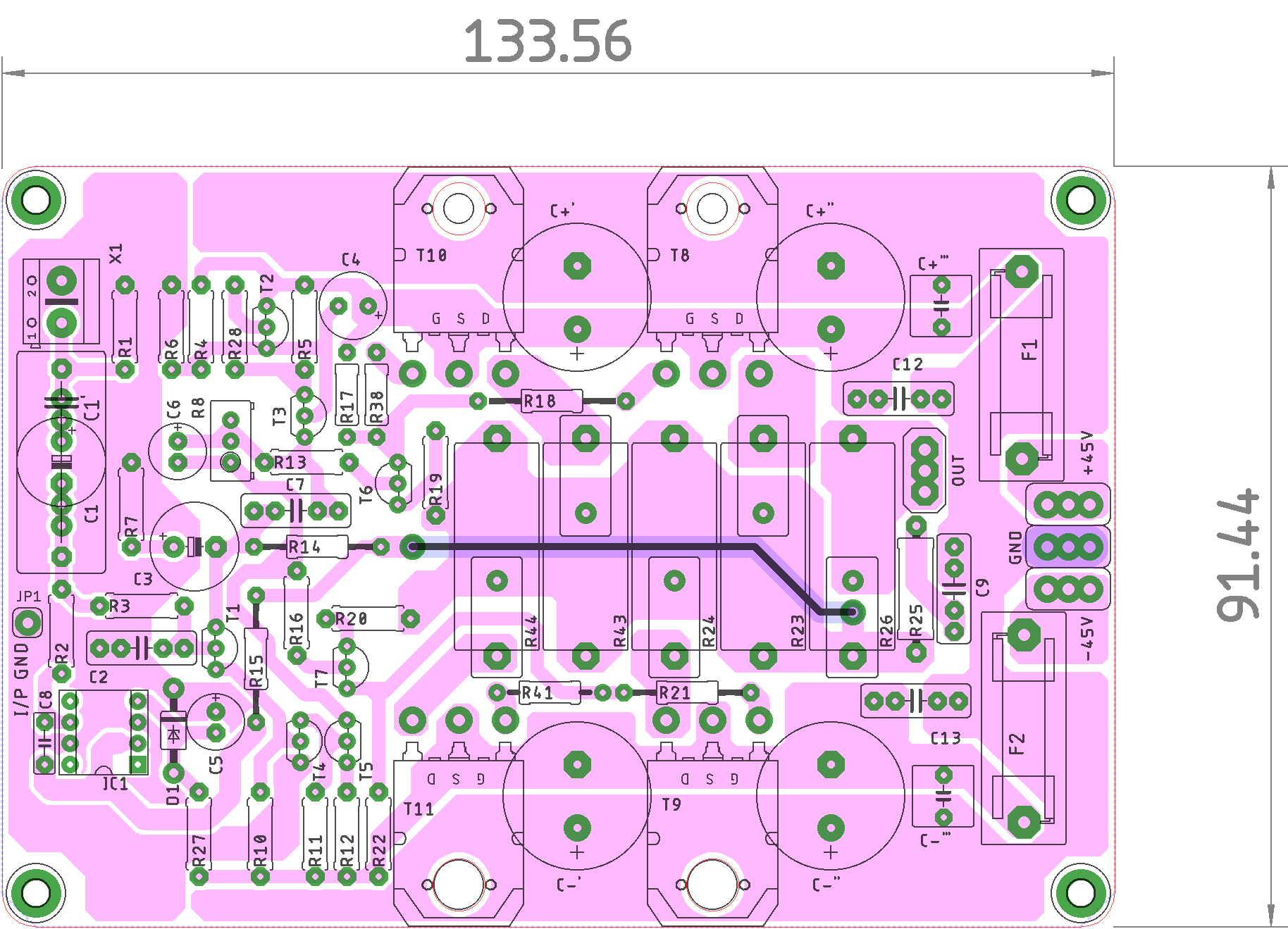

Here is a version of your amp. (I hadn't made a layout for an amp for some time, so what better amp than this one.). There are many layouts for this amp, nice ones by Alexmm.
The corner mounting holes can be omitted as mosfets are nearly in center.
Because of the width of PCB, a 3U case is more suitable for vertical mounting on side-heatsinks.
I am thinking of putting a ground plane on top. What are your views, please suggest.
I am a bit worried about the length of trace from R15 to pin-2 of op-amp, is it too long:eek:?.
needs a bit of clean-up/touch-up with regard to niceness. Although size a bit on the higher side, I tried to maintain larger copper clearances and sparse placements of the components.

That looks good :up:
The print to the opamp is fine because pin 2 is at a low impedance due to the integrator action of C8.
Personally I wouldn't use a ground plane for low frequency audio like this, and in fact may cause more problems than it solves. Tying circuit grounds to a plane would result in unpredictable interactions because of the finite impedance of the plane... it might be low but its not zero.
The links work for me but I see they have page numbers embedded within them, so if you use anything other than the default forum page setting then you might end up at the wrong place. I'll see if they are easily fixable in the next few days.

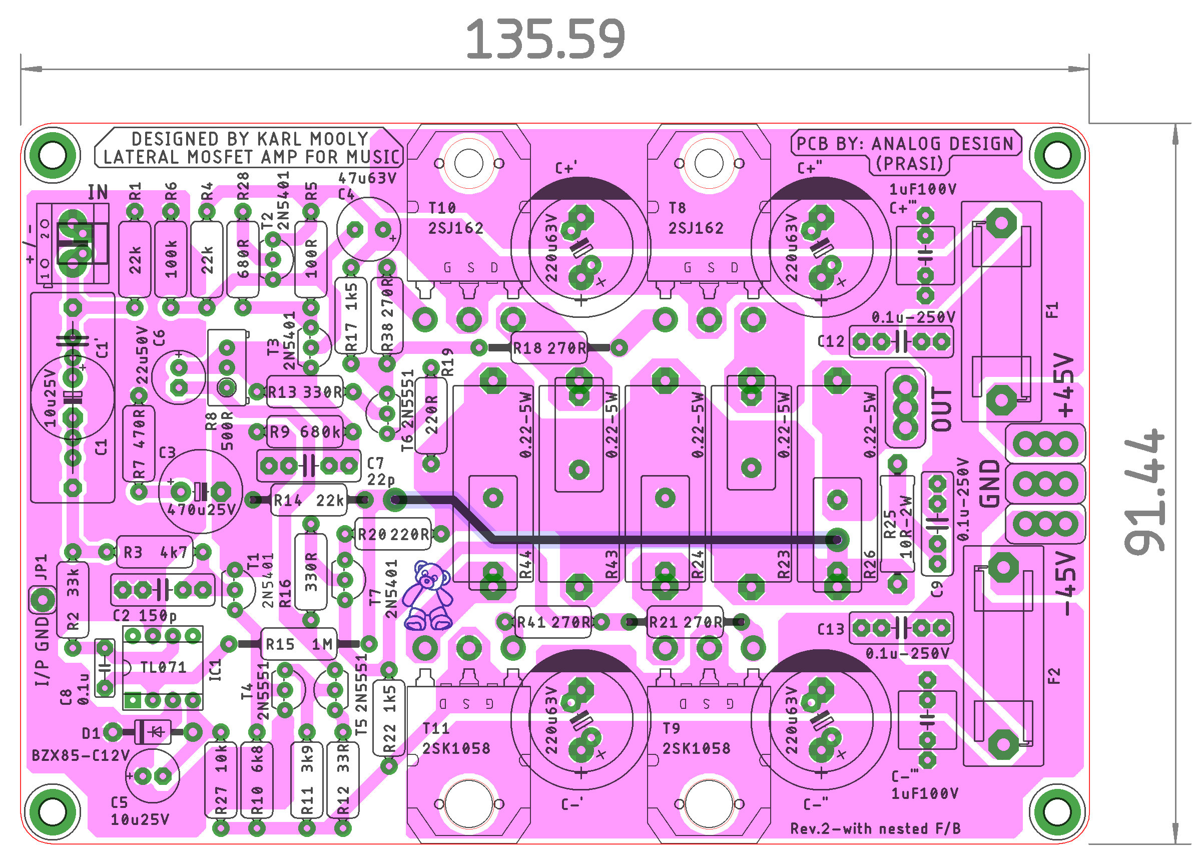

Oh... and why not add a slot for Hugh's nested f/b resistor (across C7)?

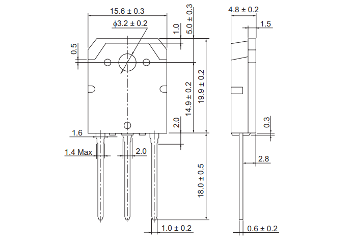

The fet package I used in this layout needs 7 mm length of the lead from the base of the package to the bottom pad of pcb, add 1.6 mm thick pcb + another 1-1.5 mm or so for top side protrusion, so total of ~10mm min out of 18mm total lead length of package. I used this before for many designs/ builds (built by others too) and never any problems.
Yes, I will add the nested fb resistor for the C7, suggested by Hugh :wave: or in the posted design, one can simply solder it from the bottom. I just followed Mooly's original design and an extra pair of fet.

Nested FB resistor option
Here is the version with nested FB resistor as suggested by Hugh.
