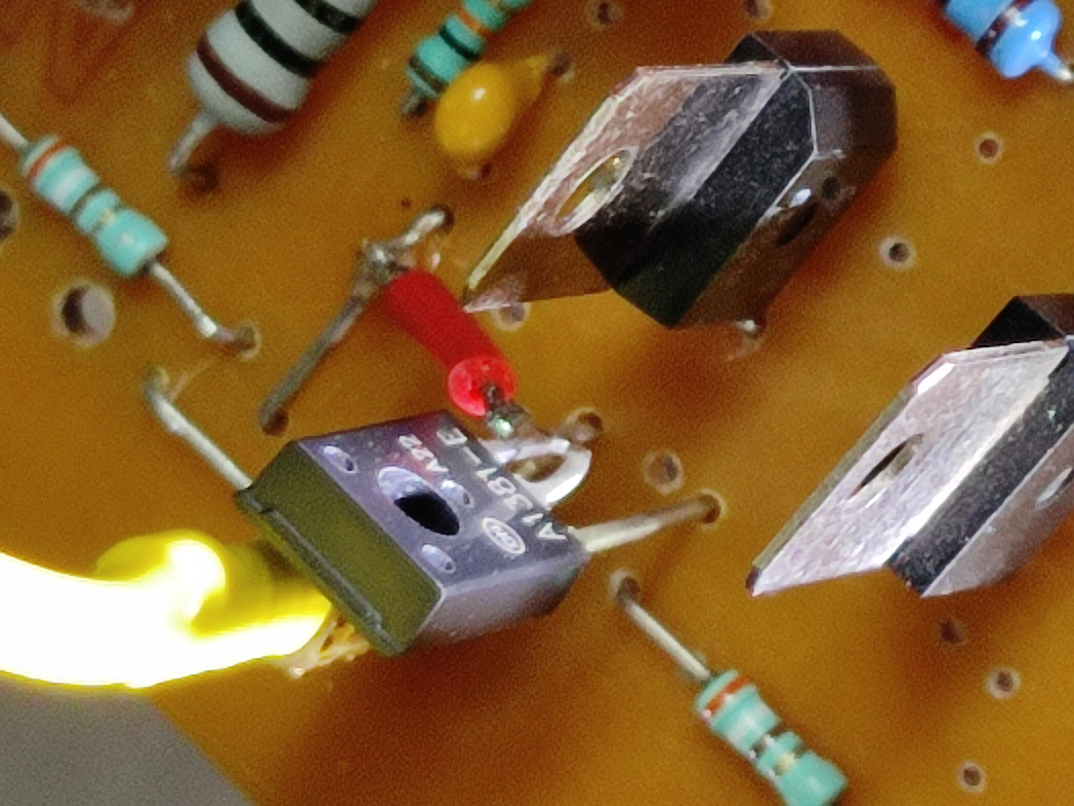

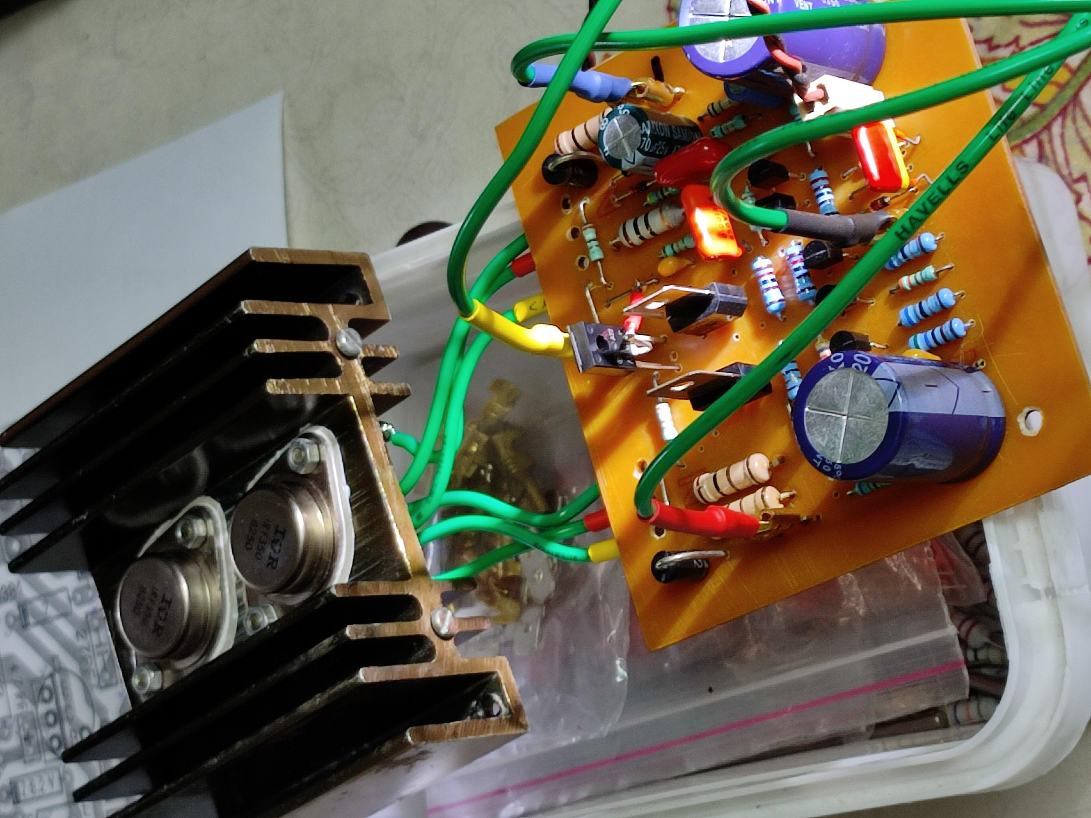

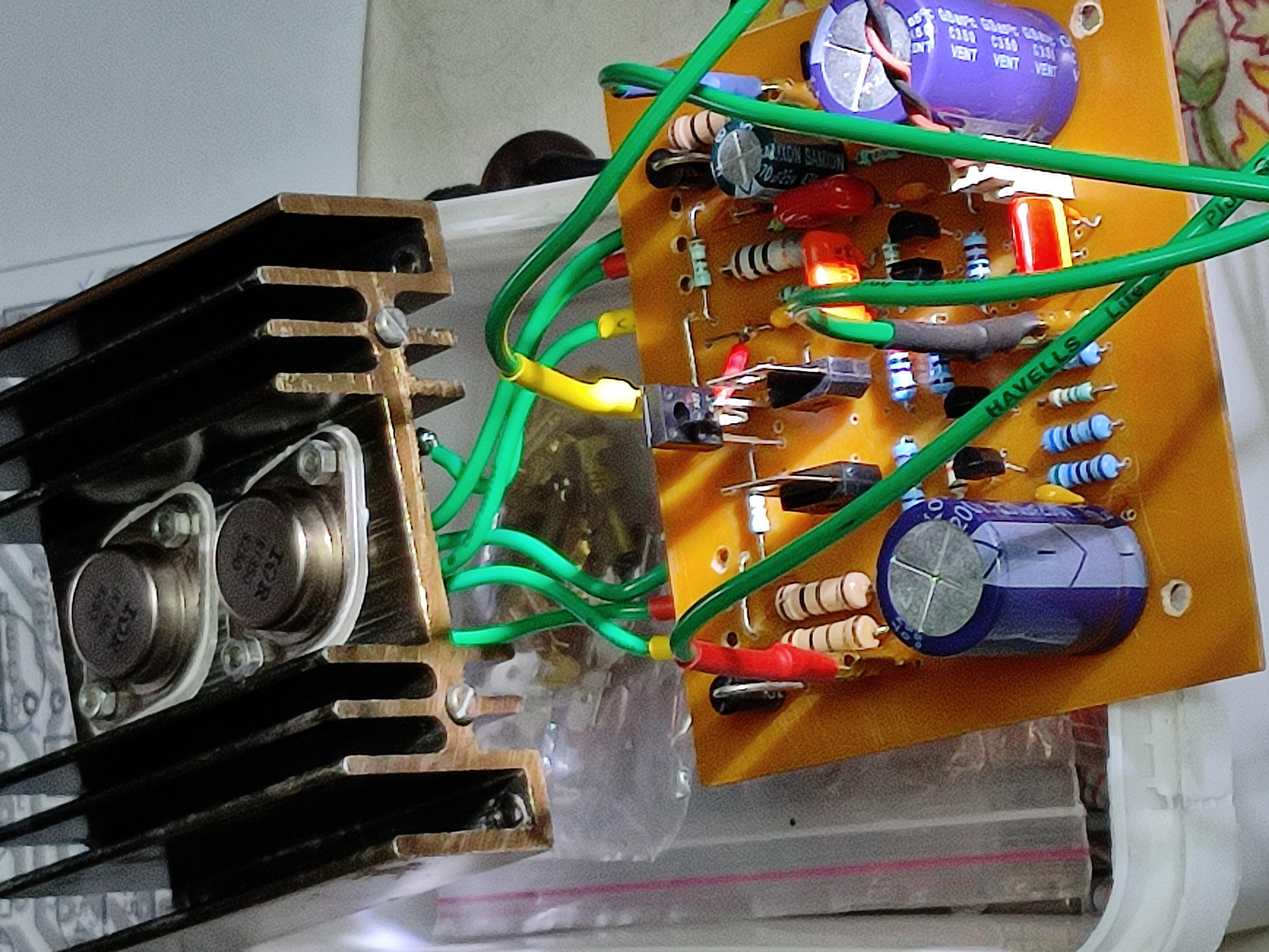

Both Zeners are out. Replaced BF870 with KSA1381 in the hexfet version. Functioning exceptionally well. Rail voltage 32-0-32 V DC. Thanks
