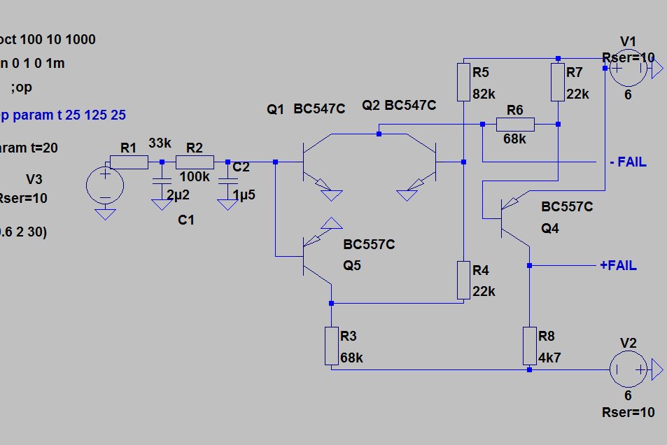

The fuse is possibly not a brilliant idea as there is no simple implementation of a "fuse blown" indicator. Further in that case the fb loop is open within the threshold voltage of the antiparallel diodes. So ok., good old relay.
Why not put a 220nF or so capacitor across the fuse? The sound will be so bad it'lls be obvious something is wrong. Then write something on the chassis to explain to check the fuse if it starts sounding bad.
That's brilliant, but I think you'd need a bigger cap if you want to hear some signal despite a fuse blown. A likely range is 2u~330u. That's very doable with a 2u~4u7 polyester cap.
Alternative: Automotive blade fuses aren't very inductive and could be used outside the feedback loop more easily.
Rod Elliot says fuses aren't really effective, and suggests a PTC thermistor instead:

It depends on what you are protecting against: If you're always on the edge, pushing as much power as possible through your speakers, using a fuse to protect them from your excessive optimism is going to work moderately well at best.
If you just want protection against a gross defect, like a blown OP transistor, or DC ingress in the amplification chain, then a correctly dimensionned fuse will be very effective.
By correctly dimensioned, I mean just above the maximum unclipped rms current for a music program, which is going to be much less than the rms current in sine regime, and much much less than the peak current the amp is capable of delivering under normal conditions.
In addition, the fuse should be of the fast variety. If you simply insert such a fuse into the output of an amplifier, it will severely distort the signal: for a 100W/8Ω amp, it would be something like 0.63A, but in the FB loop, it is transparent, and can offer a good protection at the same time.

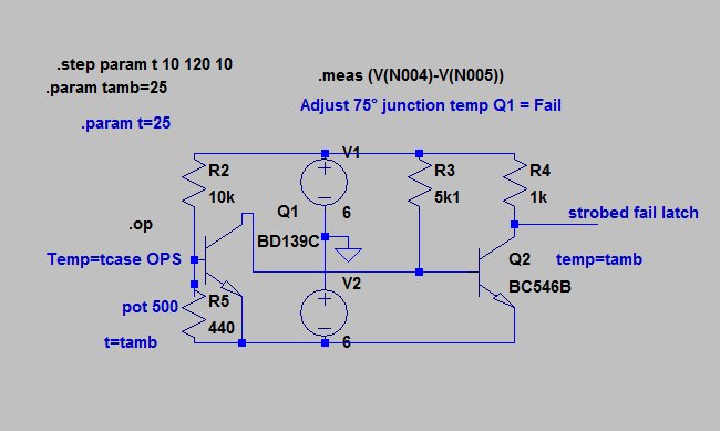

Eliott's idea with PTC is to provide thermal-image protection, something that is widespread in the industry, for big motors, etc.
Nothing wrong with that, but the parameters of the image have to match closely those of the real thing, otherwise it is dangerously useless, or annoying.
I am not sure the PTC you are going to chose more or less randomly (regarding thermal inertia) is going to match your voice-coil accurately; I suspect that its mass being larger, and its materials being mostly different than metals, its thermal capacity will be larger. Since the power it dissipates will (hopefully) be smaller than what the coil does, it will heat more slowly, unless you chose a really small one, therefore the protection won't be that effective, and PTC's on the edge are no more linear than fuses.
That said, fuses also have some in-built thermal imaging capacity: if you look at the characteristic curves of fuses, fusing time vs overcurrent, you'll see that for its nominal current, even a so-called "fast fuse" takes forever to open the circuit; yet the thermal inertia of a fuse is much smaller than that of a PTC.

Anyway an indicator is more professional than a gues for ex. by low volume and much distortion. The case could be the amp or the speaker.

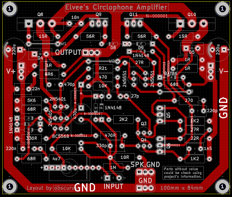

Hi. I'm building the Circlophone and need some help. I finished one channel prototype. Board layout will be attached to this post. It sounded but when no input connect and I listen very close to the speaker, I hear some noise out of it. Since it is my first power amply build, I need your help about it.
- My build is default Circlophone. But I added 10 Ohms ground breaker resistor.
- Shorted input won't make the noise goes away.
- PSU is 4x10000uf 63V.
- Here is the url of the recorded music which I used my phone to record when it was ~ 2-3 cm close to the speaker. No input connected.

From what I can gather, this hum sounds like ripple, but not base ripple: more the harmonics than the 100 or 120Hz (an oscillogram would be more helpful than the sound).but when no input connect and I listen very close to the speaker, I hear some noise out of it.
Your layout looks a bit strange, but I don't see where it could pose problems, except perhaps in the tracks leading to the local 220µ bypass caps.
You could try to remove them, or reduce them to something symbolic, like 470nF, to see if it changes something.
In principle, with the main filter caps you use, local problems should be very attenuated, but their large value could cause other problems: are you testing your amp in its final configuration, or do you have the boards and supply spread on a table, with flying leads?
The inductively coupled charging spikes of the filter caps could very well sound like that.
Try changing the position of the power wiring, in particular the secondary of the transformer, the output of the rectifier bridge. Be also careful about the ground lead of the supply, how is it connected wrt. to the filter caps and center tap.
Anyway, try as many things as you can think of: reverse the mains supply plug, short the ground-breaking resistor, try feeding it with a lab supply, try various shields at various locations: magnetic and electrostatic.
Any additional information this produces, even negatives, will help in pinpointing the origin of this hum

Thanks for the help. This noise is very low, I can only hear it when my ear are 1cm close to the speaker. When I open the record file with arta, it is max -64db and seem base at -84db. There are some clock tickling and some one cough in it so it is not so correct.
The amp only at test step. Both AMP and PSU had their own PCBs, place in a test place.
So I need to try these:
- reverse the mains supply plug
- short the ground-breaking resistor
- try various shields at various locations
- try to use another cable to speaker.
- I moved wires around and decrease the noise a bit.
- I shorted the ground-breaking resistor - same noise.
- I shorted input to ground -> no noise any more
As I read, if I shorted input and not hear any noise then it come from outside of the amp? Is my prototype seem ok now?
Yes, it is probaly electrostatically coupled hum from the input wiring.As I read, if I shorted input and not hear any noise then it come from outside of the amp? Is my prototype seem ok now?
Did you use shielded cable? Is the metal frame of your volume pot grounded.
How is you input connector grounded, chassis....?
Is the amp board itself close to the transformer, or power or AC wiring?
