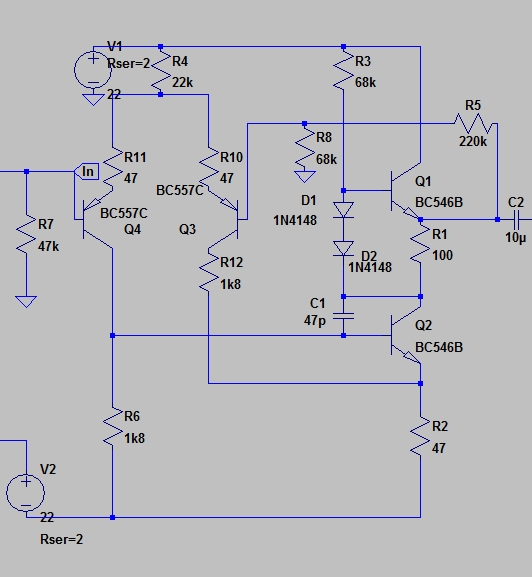

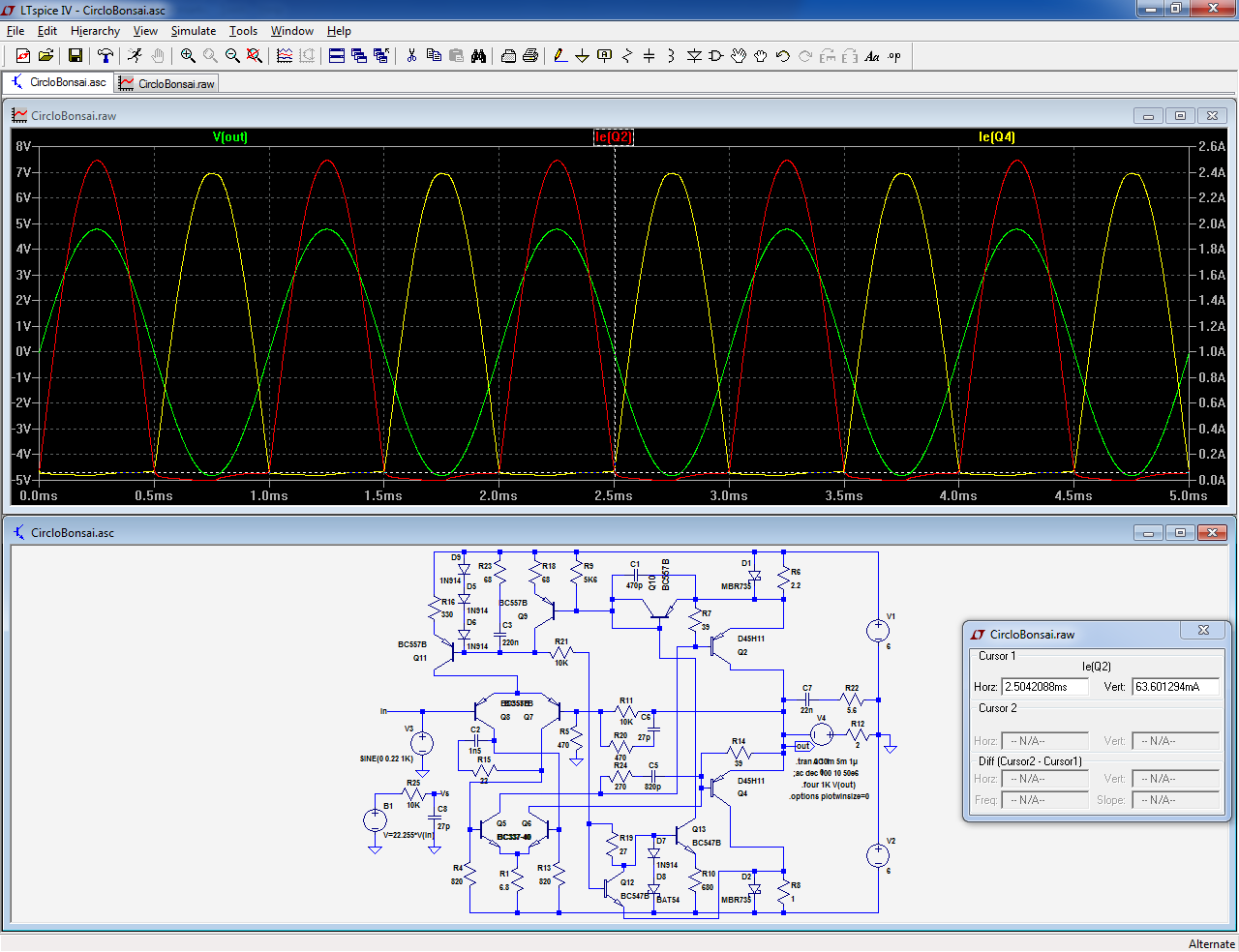

Just wanted to say thank you for this. I will attempt a build in 2015.Here is an attempt at a midget Circlophone: CircloBonsaï.
6W to 2R is. . . 1.5W to 8R?Here is an attempt at a midget Circlophone: CircloBonsaï. The modifications consist mainly of simplifications: singles as OP, no zener, and a few resistor values adapted. The Iq has been reduced to 65mA
With 12V total supply (+/-6V), it delivers 10Vpp into 2Ω before clipping, that is 6W average power. 2V total waste is not bad for a general purpose amplifier, but cannot compare with specialized amplifiers for car radio and other low voltage applications having common emitter output.. . .

Yes, approximately.6W to 2R is. . . 1.5W to 8R?
Like most amplifiers, the Circlophone is not married to a specific voltage: the low voltage example I have provided could also work at 6V or 24V, but you have to take one or two things into account:Its kind of in "no man's land" for power range, where a lot of transistors did not much. So, what does it look like at about 7W to 8R? That's just about the minimum for a biggie size table radio and/or computer desktop speakers that doesn't clip a lot.
Because the OP transistors are now single, the drive current has been increased to be able to drive 2Ω comfortably. This means that the dissipation in Q5/Q6 is tripled, which is OK for 12V but for higher voltages, a type accepting a heatsink would be required.
If you don't want to drive 2Ω, the current can be reduced, but at higher voltage, the load will take more current, even if it is 8Ω.
You need to decide a supply voltage, an output power, and see if everything adds up.
With superbeta's as OP, things would be easier. The D44/45 have a decent Hfe, but they do not qualify as superbeta.
That would be about 2W/8ΩP.S.
