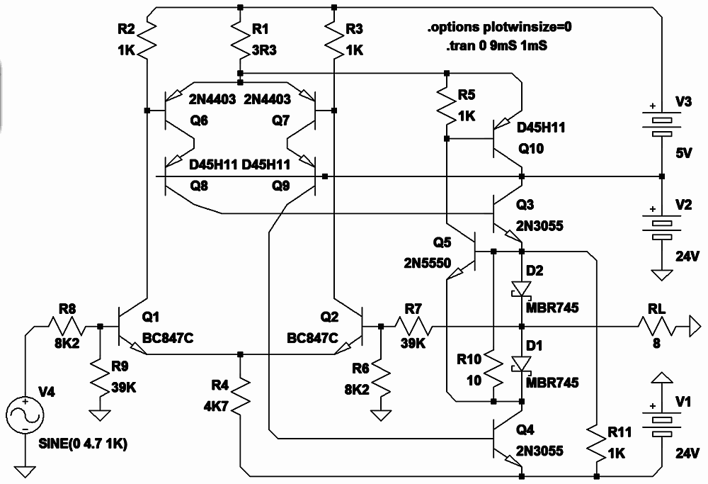

Furthermore, the increase in distortion could be compensated by doubling R4 and R12 in your schematic.
It is indeed a possibility, but of course as there are no free lunches, the negative swing would be further reduced.
And if you try to reduce the current in R4/R12 in the same proportion, the transconductance of the input pair would be reduced by the same amount, canceling the gain benefit
Again, bases of Q5Q6 (LP) should be -20 rail.
To allow the full negative output swing.
Cascode supply then providing -22.5.
But why some bizarre voltage like 2.5?
3.3V or 5V warts are more easily scavenged.
The original pair there also had a short tail R5
(OP) that Elvee said necessary for stability.
Somehow in the rush we forgot that?
The output cannot swing very low with that cascode in the way. Have you considered the existing negative rail for cascode base? You would have to provide an extra negative rail for circlophony. But it needn't be anything elaborate since the common mode is strongly controlled by quadrature anyway, a 5v wart might do.
I've no idea what that means, due to lack of a schematic. The idea sounds interesting yet vague. Connect where?
Again, bases of Q5Q6 (LP) should be -20 rail. To allow the full negative output swing. Cascode supply then providing -22.5. But why some bizarre voltage like 2.5? 3.3V or 5V warts are more easily scavenged.
Again, could you show your idea on schematic? Even a sketch would do fine. Please, something to see instead of confuse.
The original pair there also had a short tail R5 (OP) that Elvee said necessary for stability. Somehow in the rush we forgot that?
Well, I looked up the "OP" (post #1) Original Post's R5 and I didn't omit that resistor on any schematic posted. Therefore, what???

Before anyone develops a drawing withdrawal anurism...
Here we can swing an output within 1.4V of either rail.
Because this cascode's reference drop isn't in the way.
No other point was intended, so ignore everything else
that might be weird about this circuit. Its not finished.

Basically, I hate anything resembling multiple supplies.
I have designed amplifiers or variable lab supplies amongst other things, but I always managed to get decent performances without this kind of prop, even high voltage supplies with full I/V control down to zero.
The plain vanilla Circlophone swings to within 1.5V of either rail without any artifice, and I think it would be a pity to depart from that philosophy.
Then we ought to drop this non-folded cascode nonsense instead.
We can't swing both rails with that added piece of junk in the way,
there is no support for adding the wart rail, to shift a cascode out
of the picture. I never saw what cascode supposed to fix anyhow...
Original circlophone satisfied all cometary collision requirements.
Some of the random "improvements" thrown at it of late, do not.

The Circlophone is undoubtedly perfectible and improvable, just like anything else.
And I do not not mean absolute improvement, because by adding more components, it is always possible to improve performances, but that is not what I am interested in.
What I mean is a better performance to complexity or resource ratio: a rearrangement of the existing components for instance.
The compensation scheme has in my opinion the most potential for improvement.
Kean has made a brave attempt in this direction, but not a completely convincing one so far.

Hello,
I tried to simulate several variations of the circlophone driving ESL speaker with a 1:150 step-up transformer. It shows the idle power of the upper output transistor (MJL21194) is 2.8 Watt, but the lower (negative) side one dissipates 308 W. If i change the load to a resistor of 8R, the iddle power are 5.9 and 6.4 W respectively. A load resistor of 3R gives almost the same results.
Can someone point me in the right direction to solve this ?
With circloMOS i'm getting I can get much reduced iddle power dissipation of the O/P stage, but the distortion is far inferior.
Edwin
(i could post the LTspice file if someone is interested).

Some transistor models are not included, so I couldn't run the simulation, but anyway the likely cause of the problems is the lack of a DC blocking capacitor in the output, and/or a low/absent winding resistance for the transformer.
I wasn't able to track the actual series resistance used by the simulation: I saw it equaled Rip, which then equaled Ris, but then I lost the track.
Even if there is a finite series resistance, it is probably not a good idea to drive the transformer directly: normally, this type of transformer is ungapped and has a high permeability, and the winding resistance is low.
All this means that even a negligible output offset voltage will be sufficient to saturate the core.
It will also cause a high dissipation in one of the OP transistors, because the amplifier will try to impose this OS voltage to a low resistance.
Try inserting a large cap in the output, this should fix the problem.
BTW, making R23 ~=0 will probably cause problems. Even if they don't appear in the sim, the reality will be less forgiving.
