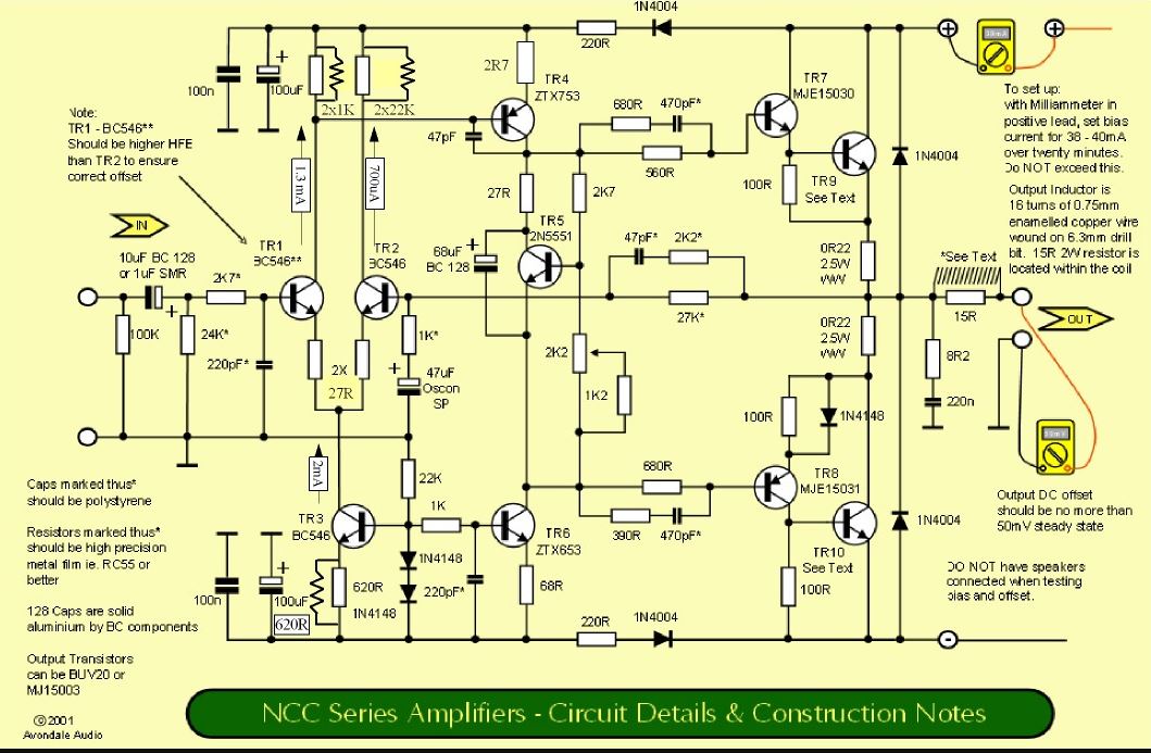

Mr Elvee, I have a querry.
I have come across NCC Series Amplifier circuit diagram on DIY forum which gave me a sense through the note that the Input transistor should have more Hfe than its counter part Feedback Transistor of the input pair to ensure correct offset. If this theory is correct than how to correctly find out Hfe value of both transistors.
I have assembled two prototype BJT and MOSFET and a Stereo MOSFET version of Circlophone at 35-0-35 V DC where I got a max of -6.5 mV DC as offset with matched input pair. Circuit diagram attached.
This Hfe requirement (relatively bizarre) stems from the unbalanced currents in the pair.
When the currents are balanced, as in the C and many other amplifiers, the Hfe's need to be matched.
Imbalance in a diff pair is generally carefully avoided, since it quickly increases the THD because the compensation mechanisms do not work any more.
Hi Guys
I m complete Noob for discrete and I want to build this amp so asking for help
can we use KSC2690A for replacement of 2N3019 or 2N3501.
Also as this part is easily available on mouser ( economically )
Will be building it using TIP3055 ( BD140 as driver )
Is there any preference between TO-247 vs TO-3 package
Would transformer current rating for 18 0 18 @ 5Amps is sufficient for both 4 and 8 ohms ? In stereo
Thanks in advance
It looks like KSC2690 should work, It's Cob is slightly higher than perfect (19 vs 10), but it's in line with TTC004B that I used without any problems.
TTC004B also should be in stock.
Another option: use
KSC3505 or KSC3503 and simply add 4.7pF C-B capacitors.

Hi Katiyar,
I will go with KSC3503 (VAS) and TIP3055 with BD140 as driver , and BC546C for the other transistors or should I use KSC1845 for Q12 & Q13.
My two way bookshelf speakers are 8 ohms 6”.
So what would be a perfect combo of parts such that I could use it with TIP3055 @ 25 Vdc and later change over to MJL21194 for 50watts.
Without a lot of change of parts in the active components.
Thank you in advance.
Mr Aditya. As you are from India I will advise you not to buy crap Chinese BD140 available very easily in the Indian market. You should instead purchase CDIL make BC546, BC556 and BD140. These transistors are genuine and performance is excellent. They will sustain the rated voltage. KSC3503 is an excellent choice for VAS. These are video transistors with 150Mhz BW.
As advised by Mr Minek 4.7pf capacitor is to be added between BC of KSC3503.
Good Luck
