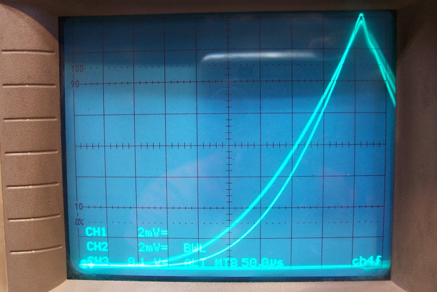

I put the three scope shots on top of each other. The average looks identical to the single FET without resistor... I guess it dominates. I put the one with the resistor in red.
I'm not sure how to interpret this...
I think it's normal, for two reasons: remember that in fact three FETs are paralleled. Two do not have a source resistor, and being majority, they dominate by 2 to 1.
Even in a match between two transistors, the non-resistored one would still dominate, because the resistor value is chosen for an equal sharing at an arbitrary, high current (in this case 6.4A), but the resistor value is probably much larger than the 1/gm increase caused by the correlation to the higher Vto in the non-resistored one.
The problem is that you cannot properly compensate a mostly-offset problem by a mostly-slope correction. The correction is exact for one point (at 6.4A here), but is above or below target

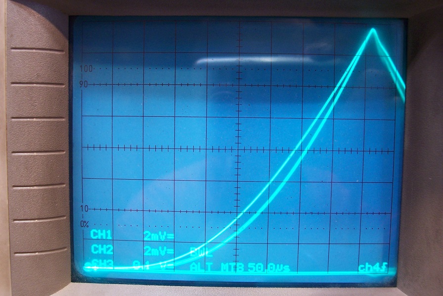

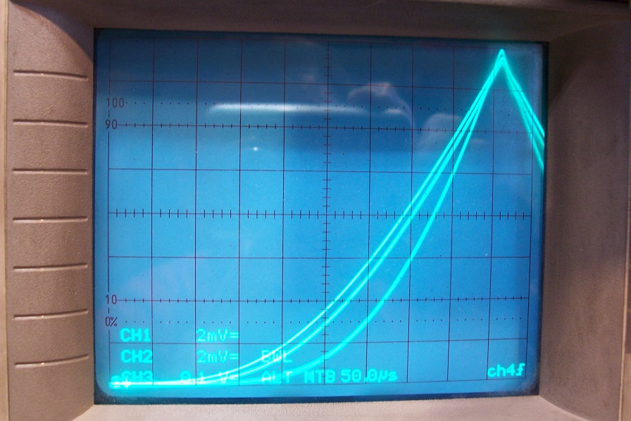

I can make the test with the two low Vto devices in my setup against the "strong", but high Vto one
To make the next test, I have sorted IRFP250's to find another low Vto sample, to be able to make the 2 + 1 test.
The one I used has 3.36V.
Thus, the lineup for this test is:
3.79V + 0Ω
3.31V + 71mΩ
3.36V + 54mΩ
First, the three Id/Vgs curves together:
attachment.php
The upper curve is the 3.31V, the middle one the 3.36V and the lowest the 3.79V
Next, the global average and the 71mΩ:
attachment.php
And finally, the global average and 0Ω:
attachment.php
This means that a single, resistor-less device cannot completely dominate two resistor-fitted devices (with the resistor values used here).
It can dominate another single device, but the resulting curve always includes a minor component from the degenerated device.

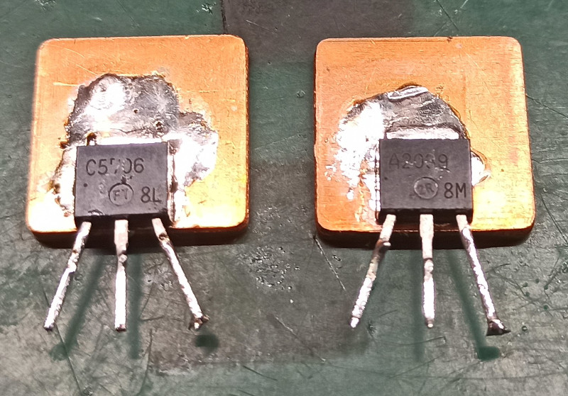

For parts that have a tiny package, interface with the heat sink really matters. There's gallium based materials but they destroy aluminium. So for DIY use, rather than polishing the surface flat which is hard to do without a milling machine, I'd just use solder and a copper slug, but so far I haven't found ones that are both cheap and flat enough. The ones pictured below are definitely cheap, but not really flat. It's okay for these devices though, they work anyway due to just having a lot of surface area.
That little trick is the ticket for making your own TO126 or TO220 devices out of surface mount devices. Soldered interface to the device is as good as it gets. Then you just have to worry about the interface from the slug to the bigger heat sink. The poorer the flatness, the bigger it needs to be. If you have room for something the size of. a TO264 you can make it work. Room to drill mounting holes, and understand that it *will* potato-chip a bit when you torque it down leaving the worst gap right under the die. Putting a bar clamp across two might be preferable.
