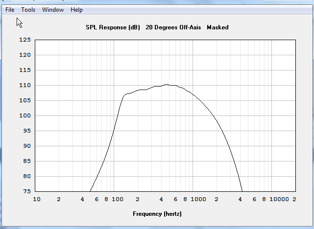

john what is a realistic LF reach for 8M in such a horn, or bigger. i'm wondering can it reach 80-90 hz with no more than a -3db roll? cause i intend to run it on a limited band, say 80-100 to 300-500 (depending on other things) and i'm more concerned with a LF output....
The lower limit will be set by how low you can get the resonance. The 8M has a normal Fs of about 100Hz. The air mass load within the horn will lower it some. How much I do not know, it depends on your horn. The type and size of the horn will determine how low Fs will be shifted. I don't think much of anything below 90Hz would be achievable with any kind of sound quality. I would probably not waste a 8M on a limited bandwidth of 90Hz - 400Hz. Almost any other 8" woofer can do that.
Rgs, JLH

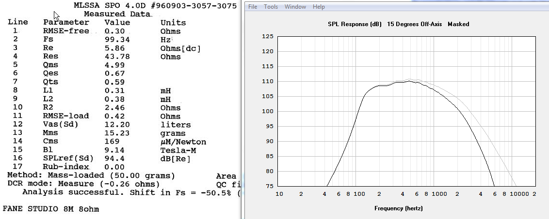

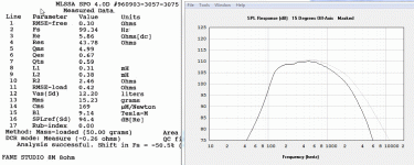

WoW, those parameters are really different - but good !
I can see why you like it ( attached ) .

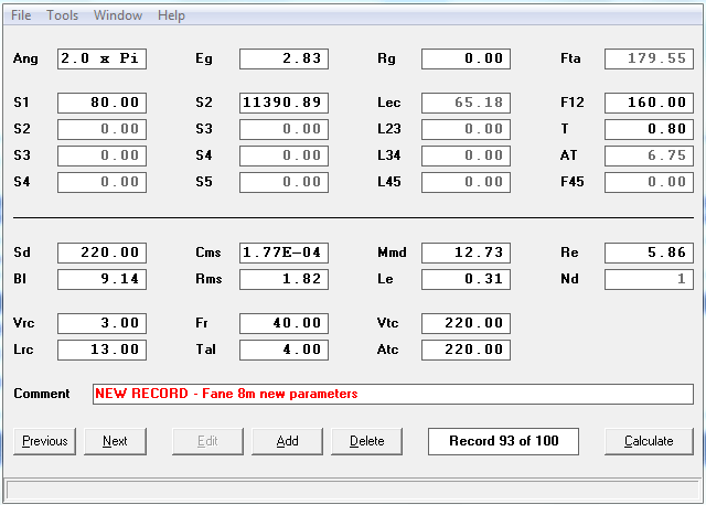

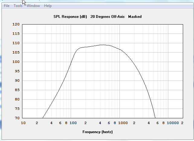

Goes a bit lower but with more ripple on my Hyperbolic (design). Probably the best set of parameters I've used for my requirements .
Let's hope Rakesh can get enough orders .....
Yes, not your typical "horn driver" parameters. Now everyone should understand why so many people have turned their nose up once they see the T/S parameters. They don't fit into what most of us would call good horn loading specs. Most people see a Qes over 0.25 or a BL factor below 10 and automatically think its no good for horn loading. You can't judge a woofer just by it specs sometimes.

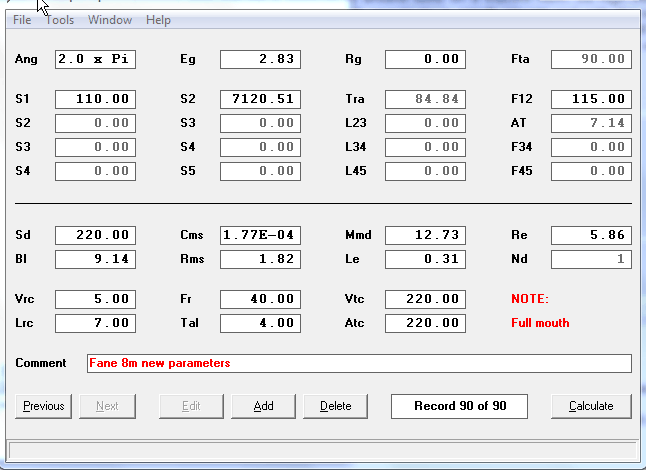

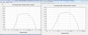

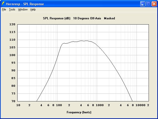

Here it is in a 115hz Tractrix with 2:1 compression.
3GGG,

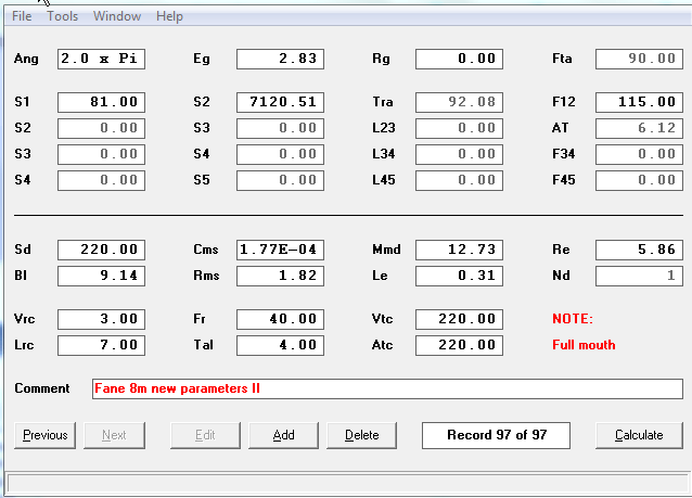

JLH told us in a earlier post that his horn had a 4" throat. This is 81cm2. So why not use this At? Will help you with better top end.
The graph of your sim shows the backchamber is to big. Should be in the ballpark of 3dm3.
Lars, you are correct on all accounts. That back chamber is too big.
I was warned off having compression too high, but if JLH has used 2.7 to success that gives a good starting point for me.

I have sim'd in a 160 HZ Le Clec'h as well as that is what I was initially going for.

Meanwhile, I'm trying to finalise a much more compromised hyperbolic horn for the Fane driver. I'm working with about 85 to 90cm length and a mouth of ~3500cm^2 . My room is not so big !
Now , the response is pretty good ( with JLH's measured data particularly ) and gives me ~120 to 1000Hz fine ( I'll be crossing at ~700 ) . As expected, the level of colouration / ripple is of some concern . I will in any case build ONE of these horns and evaluate, because going to a bigger tractrix horn will be difficult without major changes to the furniture/layout of the room .
I have therefore been playing around with the parameters on Hornresp to see what affects the ripple on the freq response. I find that the only parameter that makes much difference in the context of the Hyperbolic horn, is the throat diameter . The ripple drops usefully if I increase from 4" throat to 4.5" or 5" . So, this goes against the practical advice to choose 4" for the Fane .
Can any experienced builders comment on whether this effect is real, or just an artifact of Hornresp, maybe linked to any assumptions in the software . If it's real, what is the mechanism for the differences ?
I can quite easily build to 5" throat, and the efficiency is, in any case, plenty high-enough .
