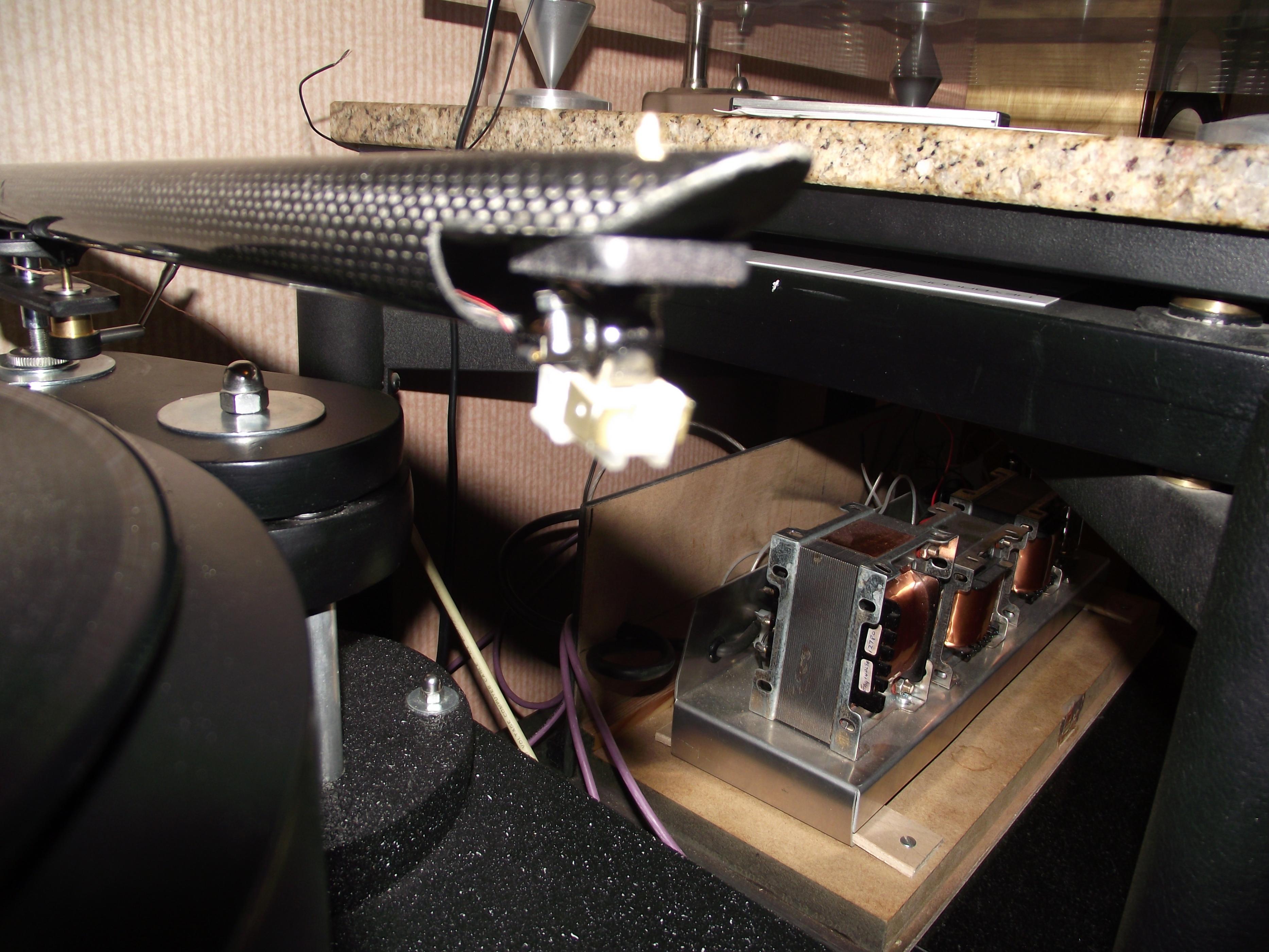

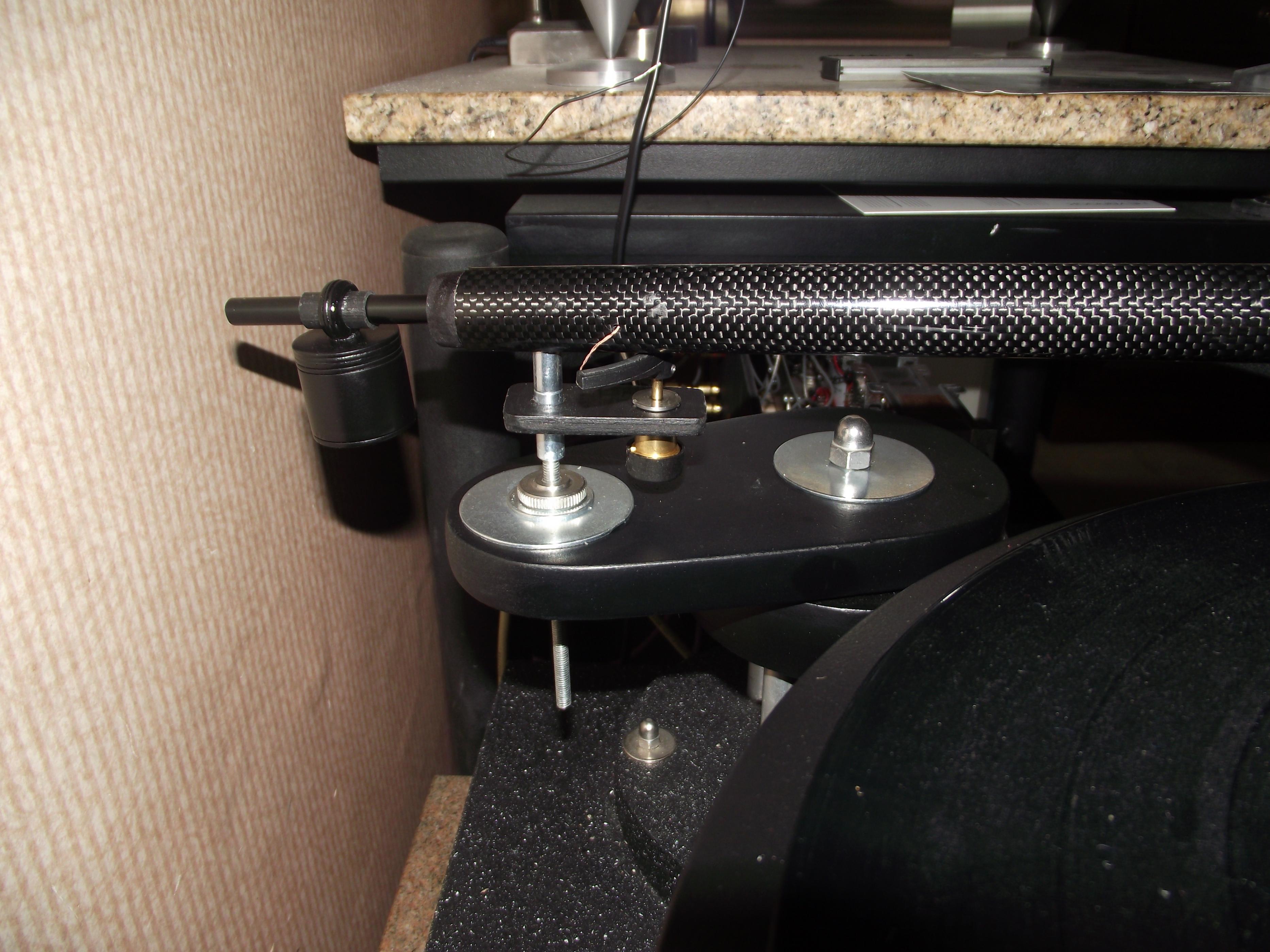

THE STEALTH MAGNUM
Here is my latest arm. It's a 14" with a large diameter carbon fibre 'wand'
I've moved away from some of the original design points and maybe it's time to start a new thread?
Regards
Chris
Regards
Chris

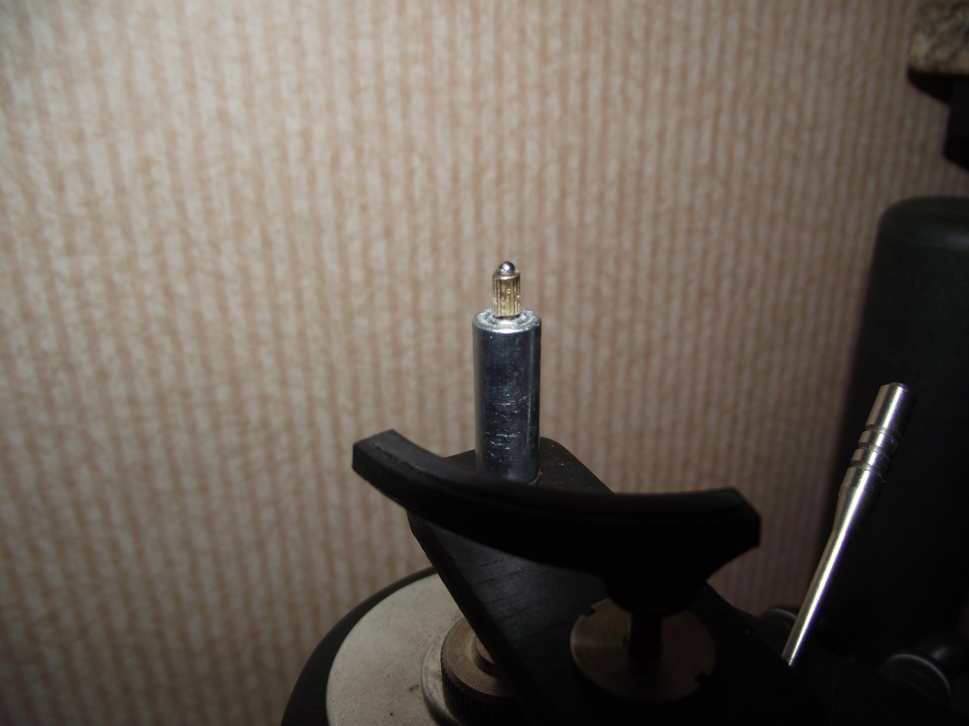

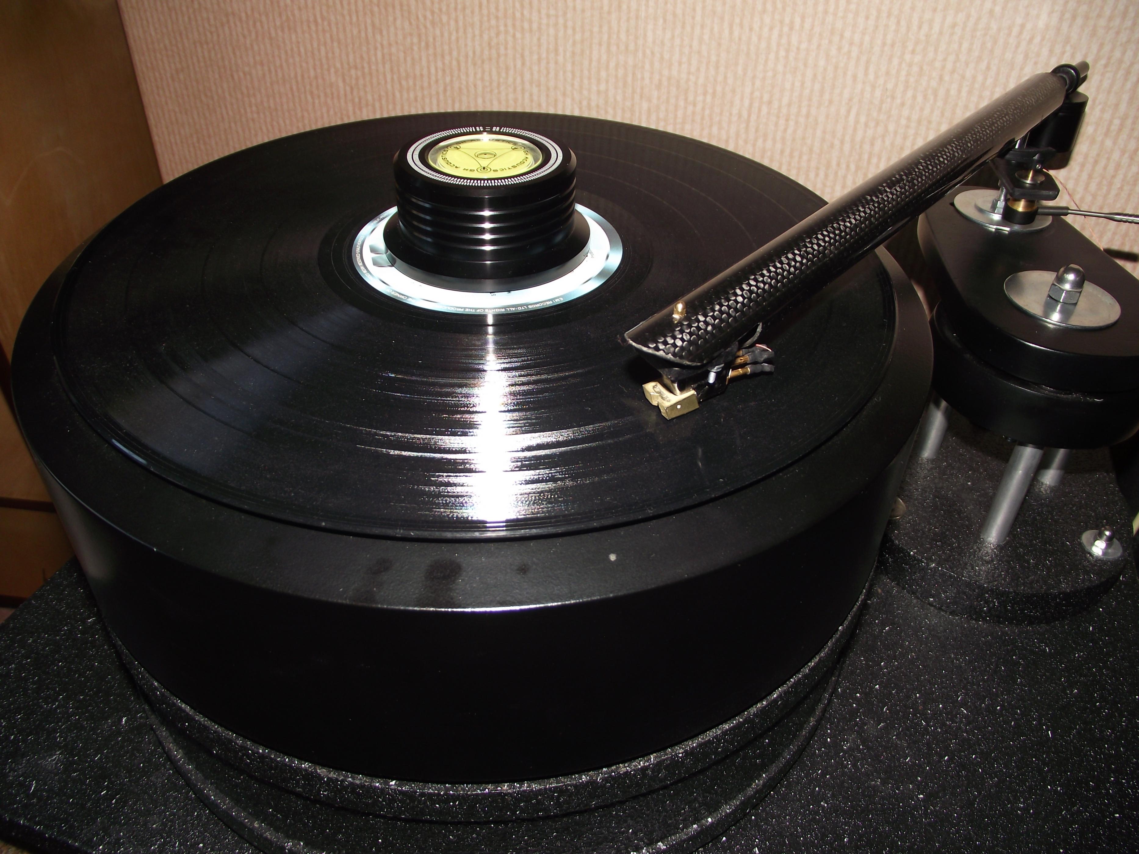

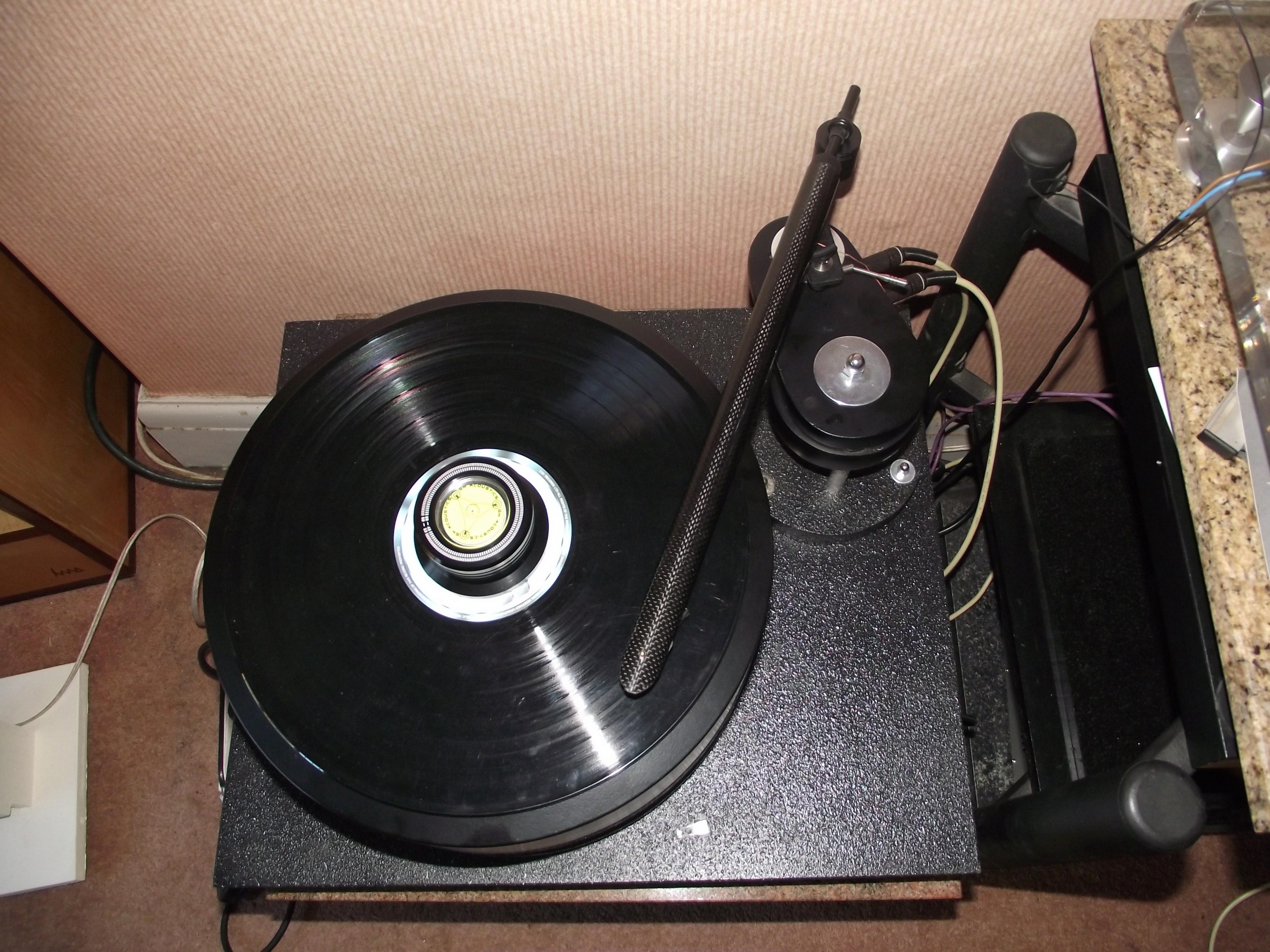

Hi Guys
A bit more ino and further pictures. The bearing is known as 'Cinematic' and is a variation on the usual point in a cup unipivot. It has three 2mm ball bearings arranged in a triangle shape mounted in the arm wand. A further 2mm ball then connects with these at their cenre- you can see this from the pictures. This is the same arrangement as used by Design, Build, Listen in the Wand.The arm lift is a standard Rega unit.
As some of you will know, I;ve built a whole range of different designs-from unipivots to WT clones to a wide variety of parallel trackers. I've also owned just about every arm you could think of- all sold off!
Sound-wise: my best design yet- it really sings with the XSV3000 cart.
Anyway.....more pictures:
Hi Guys

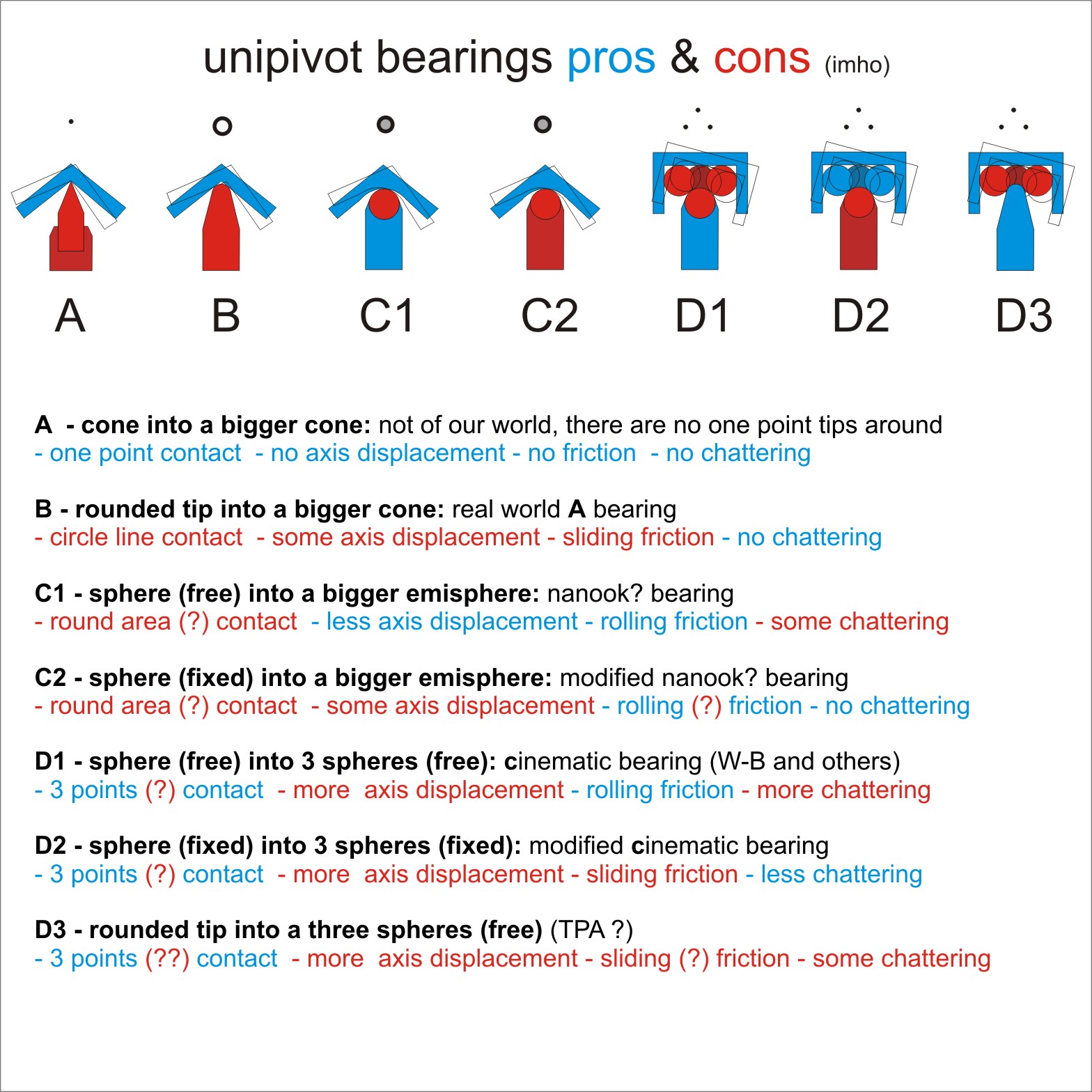

Thanks for the link, Marra: now it's clear for me too.
Googling "Kinematic" drove me out off the path, someone talked about "3 balls over 4 balls, like a stack of old cannonballs"
Silly question: rolling bearings need some play to roll, and this means chattering for us: but don't we make unipivots just to avoid this?

The tonearm proposed by Chris looks really smart and interesting, hope he will find the time to describe it in detail for all of us.
My question about the possible chattering was naive, of course, but that of Canzld (spheres free or fixed) imho is not at all.
This little drawing was done trying to better understand the problems of unipivot bearings. My notes are as reliable as as my experience of unipivots (I made just one, with a ballpen bearing: the ball, instead of lubricated, was superglued)
carlo

I do not see the benefits of using carbon-fibre. I also see that the Orbit Arm 2 (or whatever they call it now) is using Gimbal bearings, as though Gimbals are superior. They simply are not. Also regarding any possible bearing chatter, there is "zero", none, zip, zilch ...
... if you use appropriate sized pen nib/balls and an appropriate size set screw as a female bearing there is no chatter.
