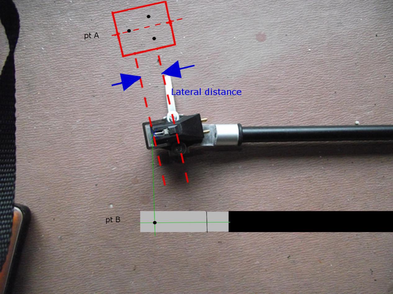

perhaps some clarity...
Ideally each cartridge would have a different headshell. But as long as the distance between the points (I call this "Lateral distance") is smaller than the between the forward single hole and the line created by connecting the 2 cartridge mounting holes, then everything should be fine. If the Lateral distance is greater than this distance, you run the risk of creating noise in the record groove.
Is the distance from the tip of the stylus to the screw positions constant among all carts? If not, I am assuming this would be built for a specific cartridge? That could get risky, as there is possibility there are minute inaccuracies with the stylus tip and its alignment with the body, no?
My only experience is with Technics style headshell's thus far, so this is all just my mental thought, and nothing that I've tried.

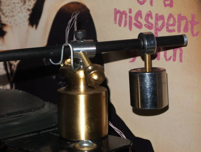

Hello Folks
This is where I throw a spanner in the works. Some of you may have seen my contribution to the WTL thread. If not-have a look. The upshot is that although I am mightily impressed with my unipivot (as noted in my contributions to this thread) I have just completed over the last couple of weeks my version of the WT. I've built quite a number of versions over the past few months. I consider the WT clone to be the better of the two-in soundstaging, presence (it's like I've turned the volume up a couple of notches), detail (I've never heard some of the low level detail on The Wall so clearly before), bass-which starts and stops so quickly etc..................... And this is before I've actually attached the headshell properly to the arm- it's a loose 'push fit' at present and needs fitting properly with a bolt and superglue.
Don't get me wrong-both are super arms and outperform many of the commercial designs (I know, I've owned a lot of them previously)-it's just that my WT clone takes things to another level.
Chris
Chris
and now the fun begins
Chris: Just remember the specific goals of the 219 vs. other tonearms: the use of existing (but better) materials and "found" objects to improve Charles Altmann's "joke" tonearm.
No doubt the WTL arm is a great arm, and depending how closely you clone it, should be a solid performer (I have never heard one, but a friend owns one and really loves it). Each iteration of Bill Firebaugh's tonearm has small improvements over the previous one.
As to the sound: As I pointed out earlier I might add that your arm, although similar to the 219, isn't. The 219 has an internal female bearing cup and doesn't use anything but the tube as part of the arm wand itself. I could suggest that the additional items in contact with the arm tube could colour the sound in any number of ways. This is not intended to be a "slight" of any sort, Chris, just an observation
John ALSR: Yes to your points as listed.
All: And this is where your mileage may vary, should you wander from my interpretation of Altmann's design.

Female bearing
My 2 penarth's worth,
This may seem like a lot of trouble to go to but it's very rewarding...In case you've missed the way I did my female part of the bearing.
And it doesn't get much simpler, well cheeper,
I used the brass end cap from a blown fuse.
To find out if it is Brass scratch the side & if it looks slightly yellow it is brass.
Q, Why Brass cos it's a very good material & as good as it gets, for this kind of application.
All you do is,
1 Carefully drill an appropriate size hole in the tube, i.e. a good snug for the fuse end cap.
2 break glass fuse. I found crunching the glass between a pair of pliers quite satisfying.
3 hold end cap very firmly but without squeezing or squashing it.
4 Drill out any left over glass, the drilling is quite nice to do (but do ware glasses) & can be done by hand so you can Feel the glass, crunching & breaking, (I love the sound of breaking Glass) Use a slightly smaller drill for this part,
Next use a closer fitting drill to clean out the fuse wire then the solder at the bottom of the cap. Do this part carefully till you begin to see shiny Brass. You should also get a depression at the bottom of the cap, This is a good thing.
If your drill has left a to flat bottom right in the centre. then you can use something pointy to VERY CAREFULLY make a sharper indent.
5 now glue this into pre drilled hole in arm tube. A drop of epoxy onto the end cap & little on the sides.
6 job done.....but if you f....d up the first one you still have the other end of the fuse to play with to get it right....
Jay

Almost inspired me...?
Helmuth and all folks unsure of themselves: This arm is so easy to build, you should build one even if you decide to never use it, as an exercise. The cost is so low, and the results are very good. Even if all you do is play around with the bearing and arm tube. It will amaze you how good the bearing is.
Jay1234:The use of a brass fuse end is a good one, I think. I would still glue it into a small piece of dowel so that the cap is very secure to the dowel and the dowel is very secure to the arm tube (I use Gorilla Glue polyurethane glue which expands as it cures).
ChrisG: I was pointing out that your arm is not constructed exactly in the same manner as mine. It could be better, it could be worse. And as I stated, I do know many who love the WTL tonearms and I have no doubt that your clone sounds excellent. I'll have to try my hand at one and see how they might compare.
