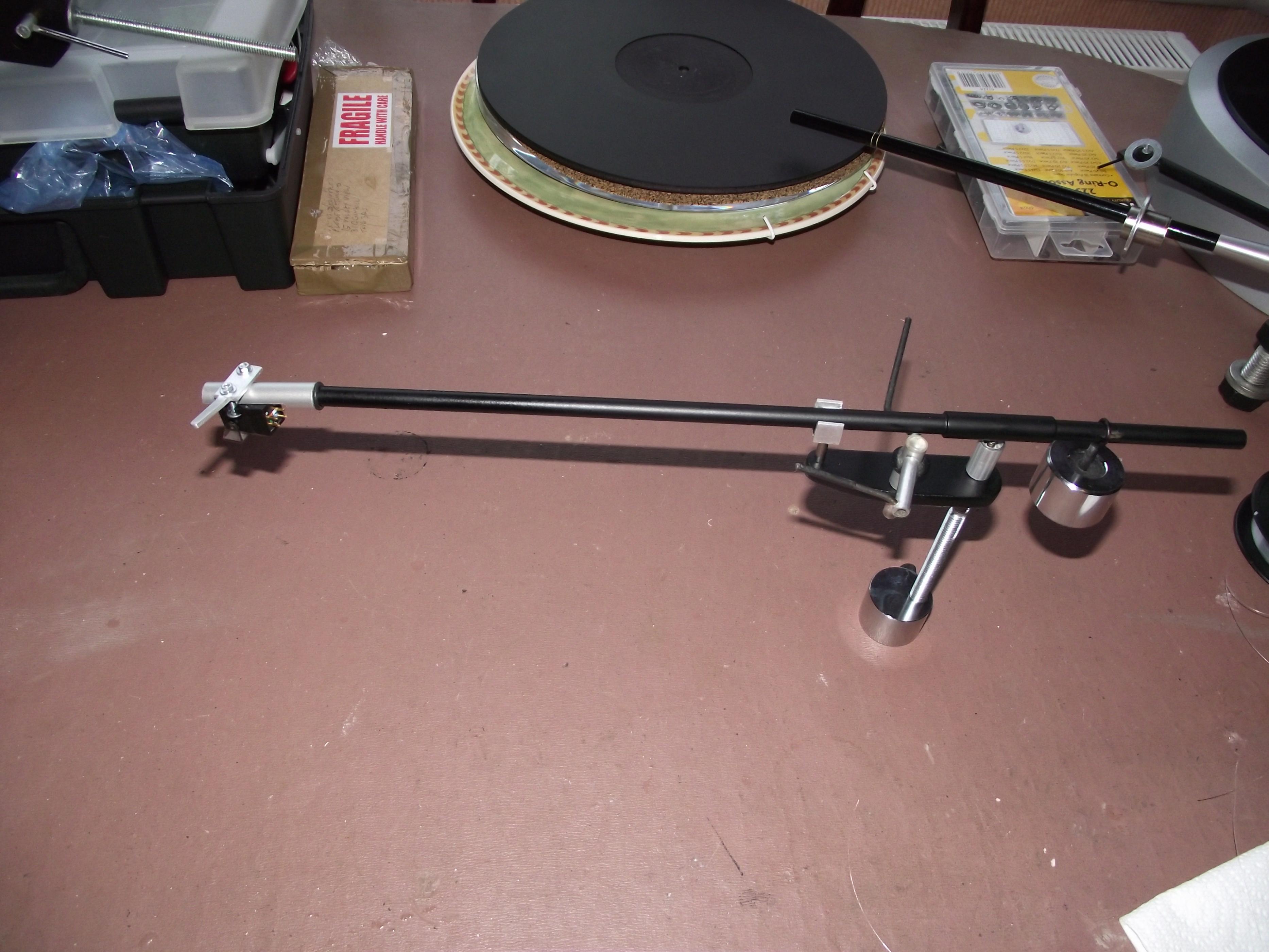

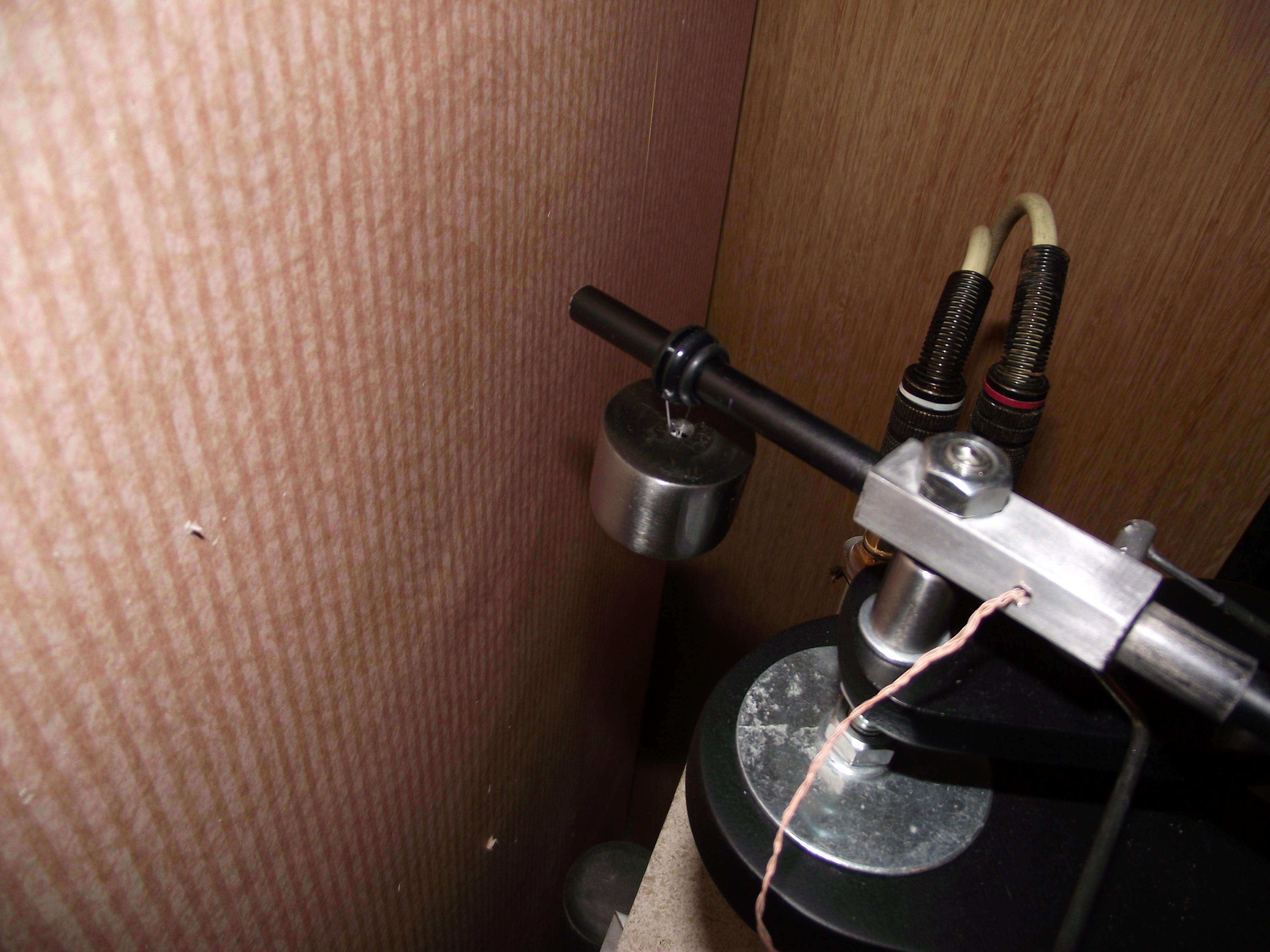

Hello Everyone
Here is a method of suspending the weight by a thread (7lb fishing line), decoupling it and enabling correct azimuth-sounds pretty esoteric eh?
It took 5 minutes to fabricate. The whole affair is suspended on a grommet (the ones used to protect electric cables as they pass through a metal casing) pushed onto the stub. The fishing line simply loops over this and then passes down to the weight which hangs from this.
There is enough contact between grommet and fishing line to ensure azimuth is correct and remains in place.
NEXT QUESTION: Is it worth doing?
ANSWER: Maybe/maybe not
REASON: it sounds no different in any perceivable way to my other arrangement (see earlier in the thread) but what it does do is introduce a 'side to side' wobble as the cartridge is lowered onto the record. It stops after a second or so but I can't help thinking it's introducing some instability. Tracking wise it still clears every band of HFS75 with ease so no problems there. I'll try it a bit longer and decide. I'm likely to go back to the previous arrangement though.

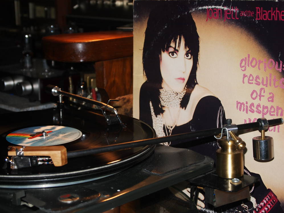

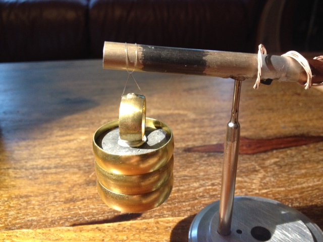

C/weights
Hear is mine no grommets or O rings just the Thread it's a monofiliment not sure what it's strength is as it came from wife's sewing box.
Iv'e gone through various methods of attaching the C/w & IMHOP this is so far the best.
The arm is very stable now.
It grips the bear tube more than enough for azimuth to be adjusted, in fact the heavier the weight the more it grips. No sliding of the weight in any direction, & it's about as de-coupled as it can be.
Also the amount of damping to the arm, this method introduces is about as minimal as it can get.
I can't see a way of making it any simpler.
Though with a more elaborate connection of the thread to the weight, ie somehow wrapped around the weight it might be possible to stabilise the weight further, perhaps using two threads!!!!
Perhaps spacing the threads loops further apart might gain an advantageb.
I will play around with the olives till I get it just the way I want it.
But I think this part of the "219" has gone as far as it can, how can it get more simple & be as effective.
What do you think ?

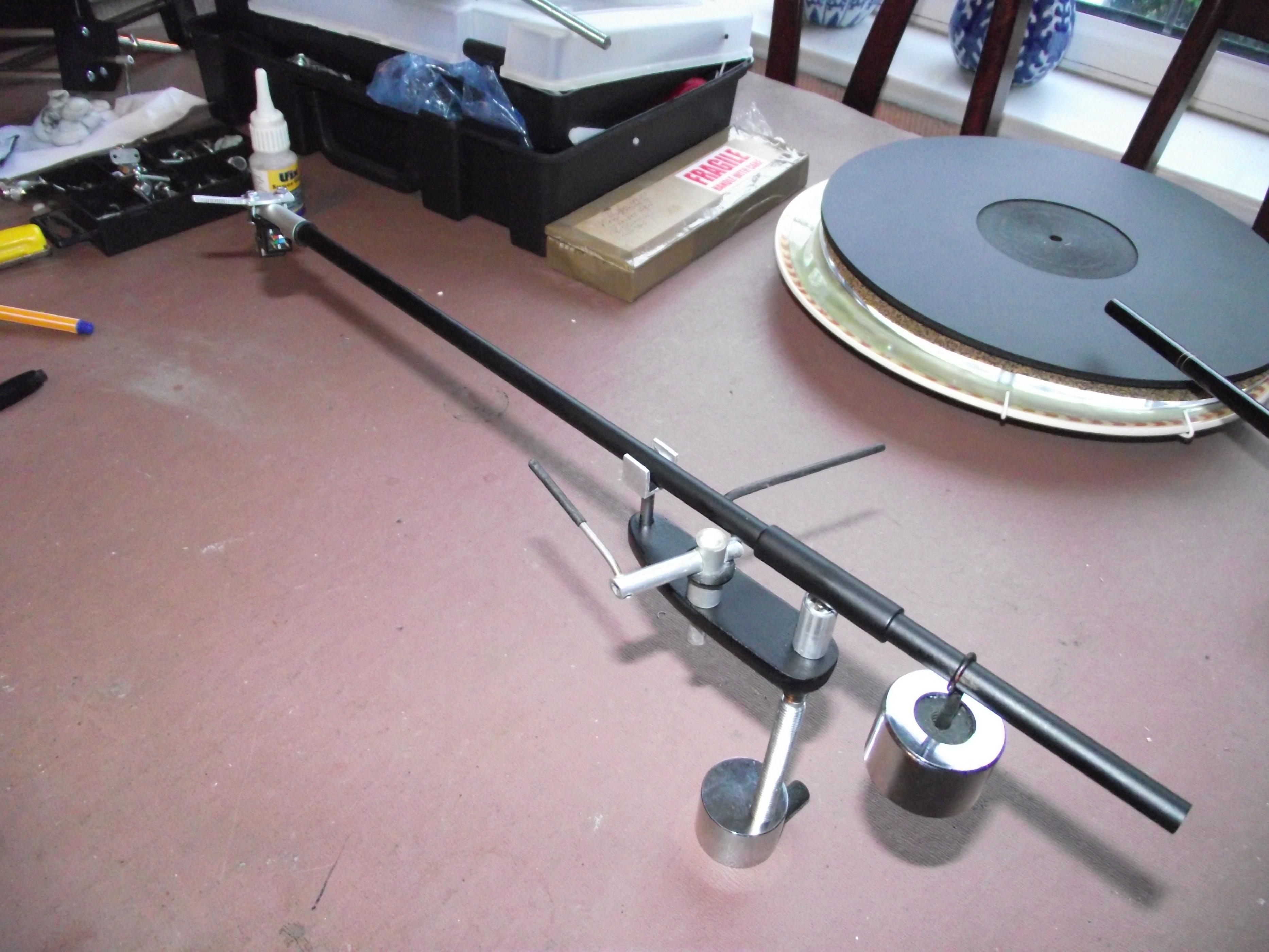

OK, now back to the c/w....
vdi_nenna: nicely done. It looks as though it should function as the Roksan version. It looks very good and follows my "use existing stuff" idiom as much as possible. Also the tonearm base has obviously been thought out., clearance for the counter-weight is not a problem with your implementation.
For all: The lighter the c/w, the farther from the pivot it needs to be and the less likely it will be interfered with by the tonearm base.
Jay and Chris: I've tried them all, and to me the best solution is still the heat-shrinked "stub end" and string or wire. The point of the heat shrink its to allow for some grip. I had not had good luck without it, so that's what I've used. MY attempt at the Roksan c/w was to see if it could be easily duplicated and if there was any other benefit. I feel that the benefit over the string hung c/w is minimal at the least and in most ways the string hung c/w , because it is so simple, has a huge benefit.

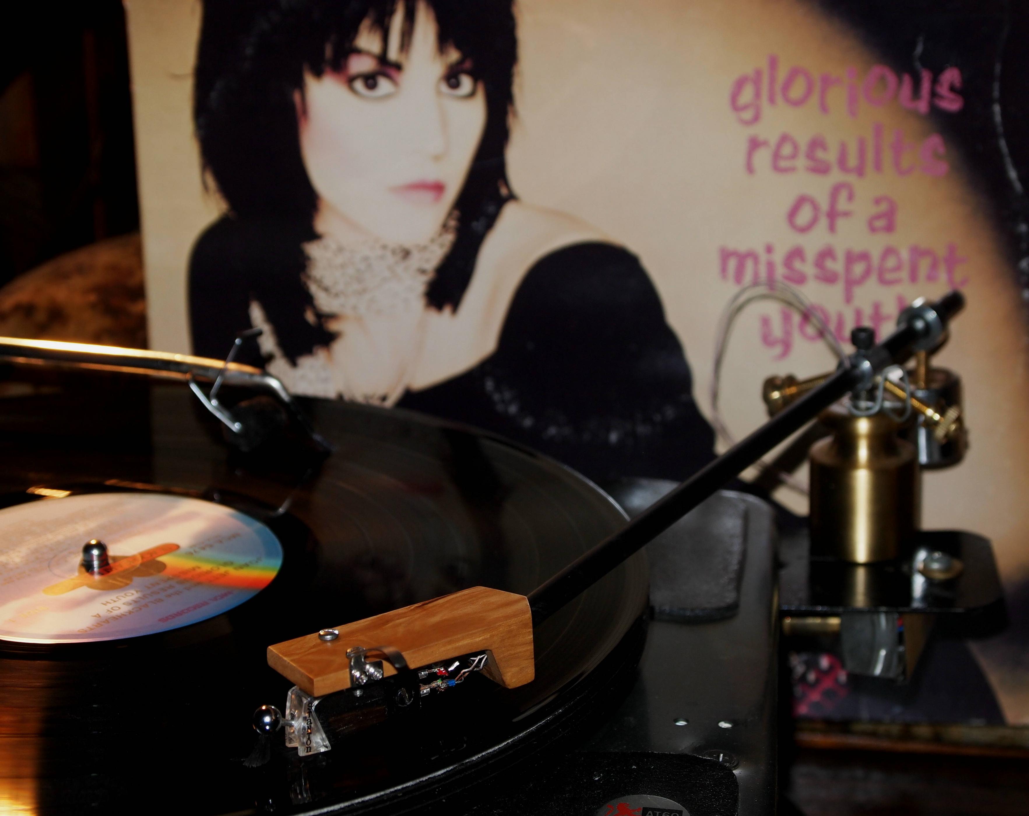

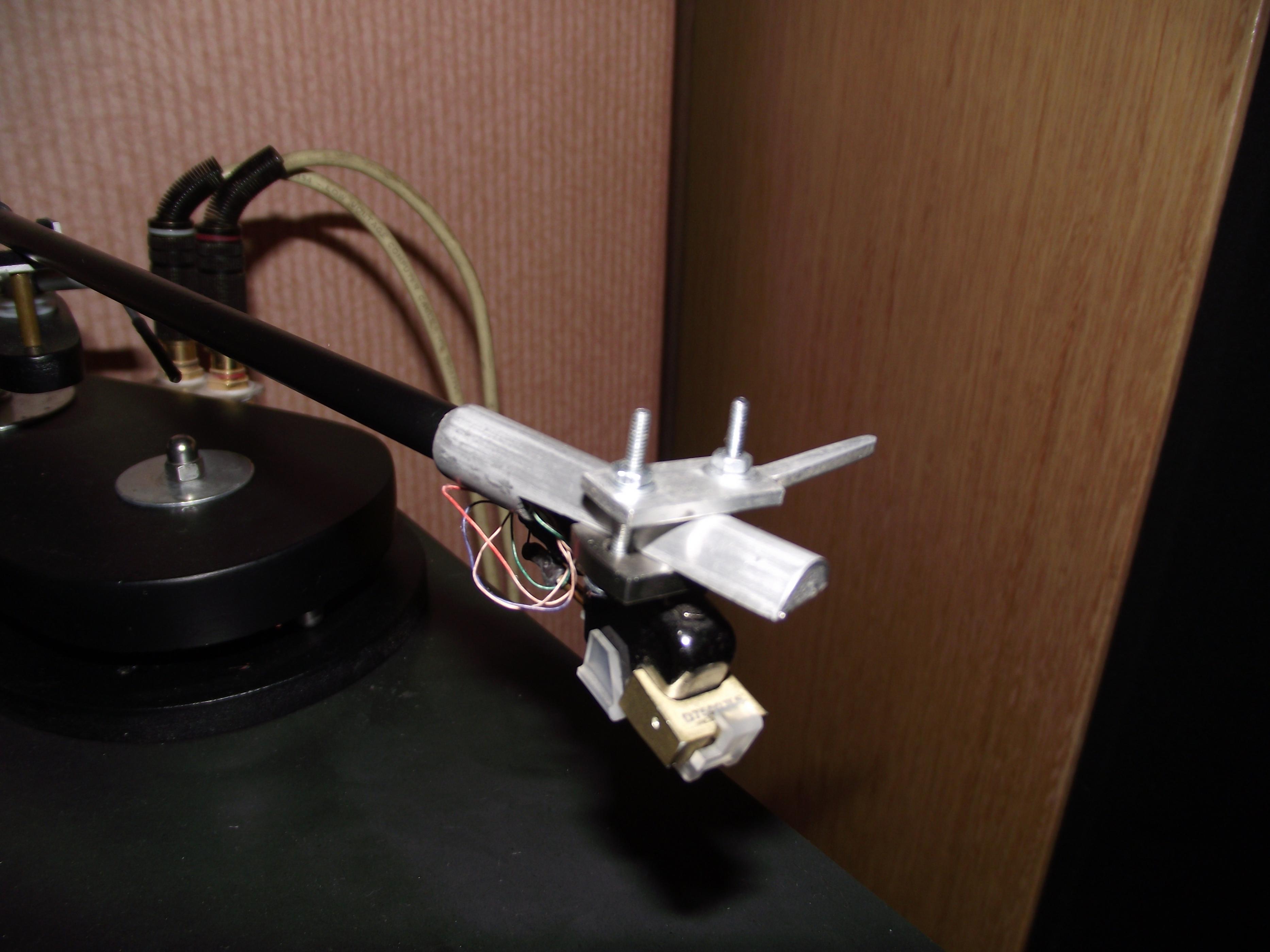

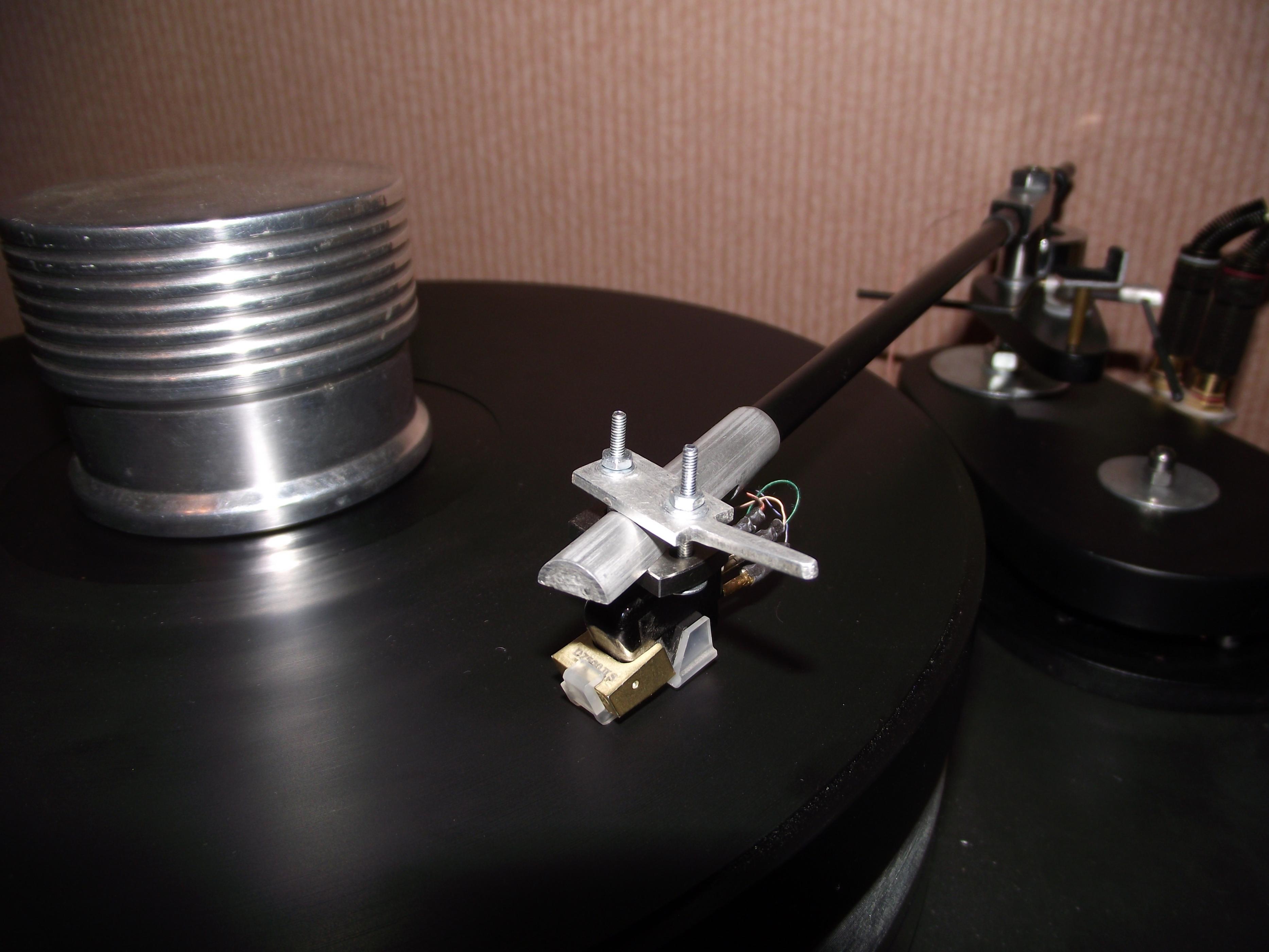

Hi Folks
If you are looking for a simple and effective headshell, look at the pictures I have posted. This is aluminium tube, filed down to half-way, filled with with epoxy putty-totally inert. I then use a 'saddle' which is the same principle as used on the Morch-but more robust. Getting the offset angle right is easy. It also includes an integrated finger lift. Close up pictures to follow.
Chris
Chris

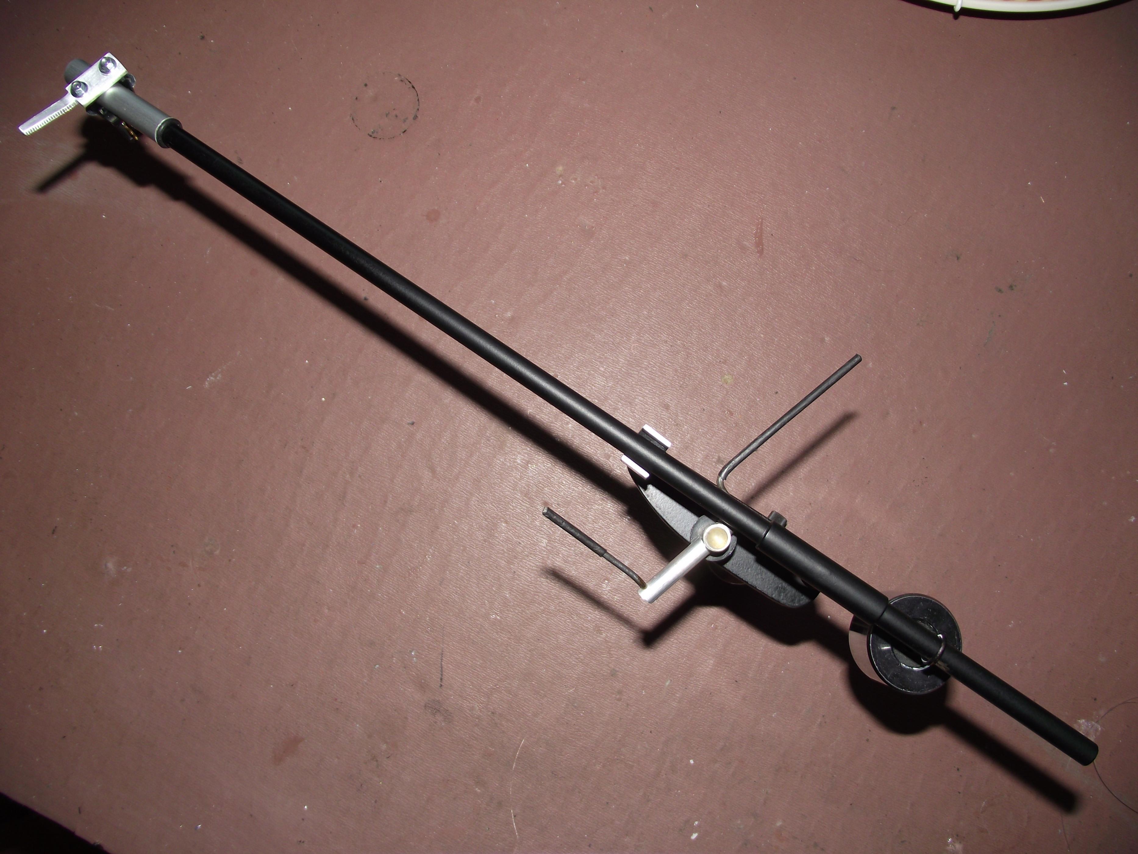

nice, but...
Chris:
Look at where the rotation of the cartridge occurs with regards to the stylus tip. This is a (to me) fatal flaw with every headshell other than my version of the Scheu design. The devil is in the details...
Everybody falls into the same trap, unfortunately. Resolving this is but a small step away...you're so close!
That's the end of the bad , except the use of a separate "stub end (or what appears to be a stub end). Everything else looks top notch. I'd be proud to own that arm.
Chris:

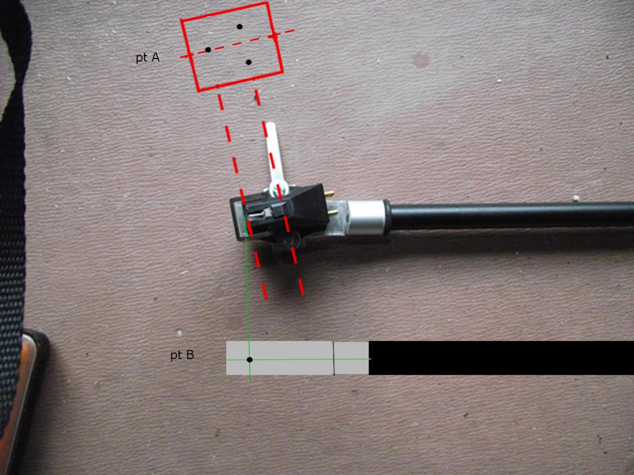

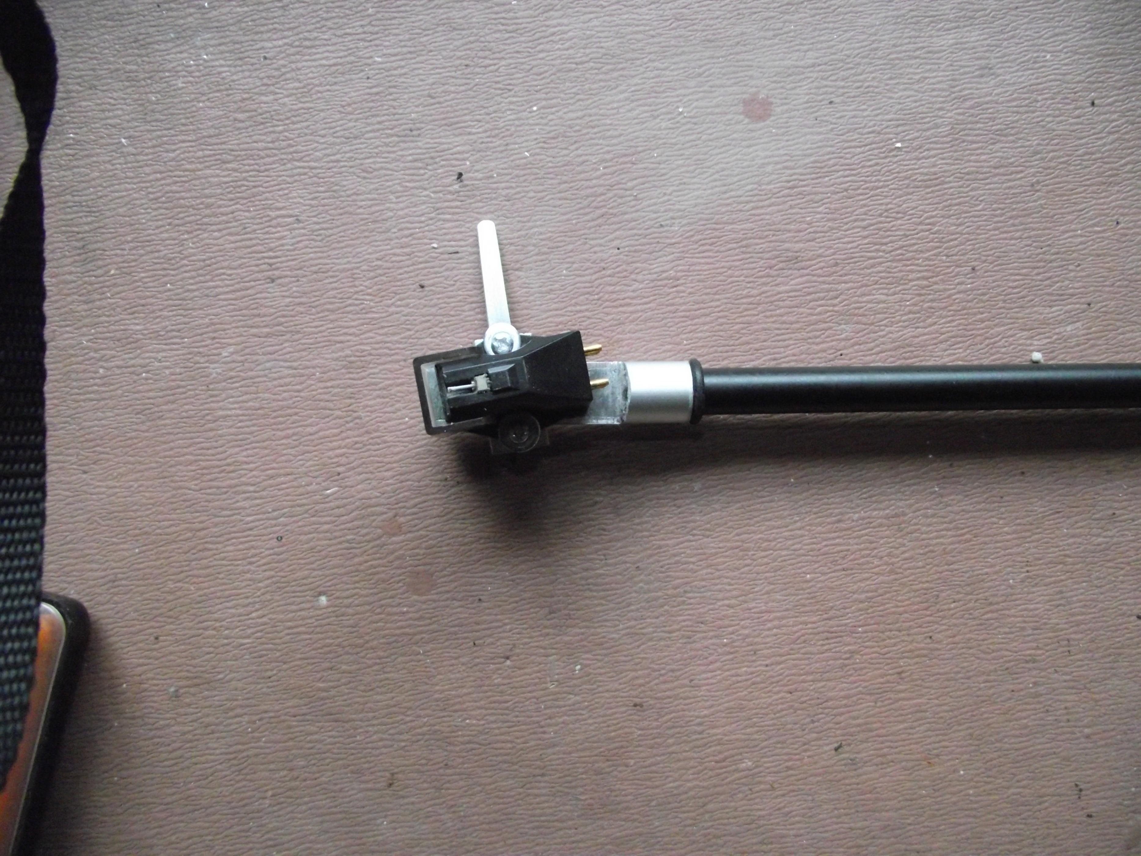

this is the intention...
Make a cartridge mounting plate. Drill 3 holes in it as indicated. It must be thick enough for the heads of the cartridge mounting bolts to be completely counter-sunk. Drill a single hole from the underside of the cartridge mounting plate that will allow a nut to be counter-sunk and then glued in place. Glue the nut in place. Screw the cartridge to the cartridge plate using the two 1/2" spaced holes
Make a simple dowel of metal or wood. Make a hole in it at pt B. Use an appropriate size and length bolt to push it from the top side of the "dowel", through the hole. The bolt will need to be + the thickness of the cartridge mounting plate. Screw the cartridge mounting plate to the dowel.
If seen from the side, the stylus point should be in alignment with the cartridge plate mounting screw, regardless of the rotation of the headshell. So the effective length will remain constant, regardless of the whichever alignment yhe end user decides upon.
This should also allow the adjustment of the stylus to the groove, reducing both stylus and LP wear. That's it

Is the distance from the tip of the stylus to the screw positions constant among all carts? If not, I am assuming this would be built for a specific cartridge? That could get risky, as there is possibility there are minute inaccuracies with the stylus tip and its alignment with the body, no?
My only experience is with Technics style headshell's thus far, so this is all just my mental thought, and nothing that I've tried.
