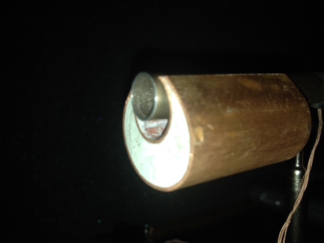

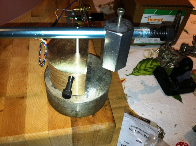

C/weights
The ugly C/weight, which is not dissimilar to Roksan in concept just chuck in more weight if needed, almost single point contact with arm tube so nearly a uni-pivot !
The elegant C/weight, still in rough form But way to light. Still I might well be able to use it on the Balsa arm.
Jay

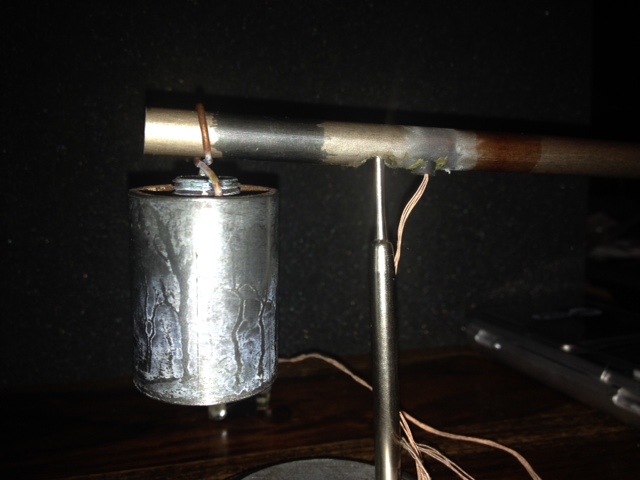

Hi guys,
Here's what I thought would be suitable. Functionally not different than a weight on a string...
Jay, you could "slug" the ugly counter-weight. Just drill a few holes and screw in a few steel bolts to get the desired mass.
Chris: What you have done is what I call "weight on a string". I think it is by far one of the easiest to make, best sounding counter-weight set-ups that can occur. Only the string, or in your case the wire, touches the tonearm. The coupling is quite tight at the contact points.

an explanation...
of the diagram:
That's about it. I'll post some pictures if need be later (gotta go eat supper at one of my kids' house.
Later.
of the diagram:
- the red piece represents the arm tube (at the rear of the arm);
- the (white) vertical rod is how the (yellow) counter-weight is attached to the collar (it can be a string, a screw, whatever);
- the (blue) collar (with the green male bearing) rides in a trough. The collar can be made of anything that will not grossly deform under the weight of the counter-weight. I made one out of wood.;
- the trough can be almost anything. A scrap of thin veneer glued to the (red) rear of the arm tube, whatever. A groove must be created in whatever material is used.

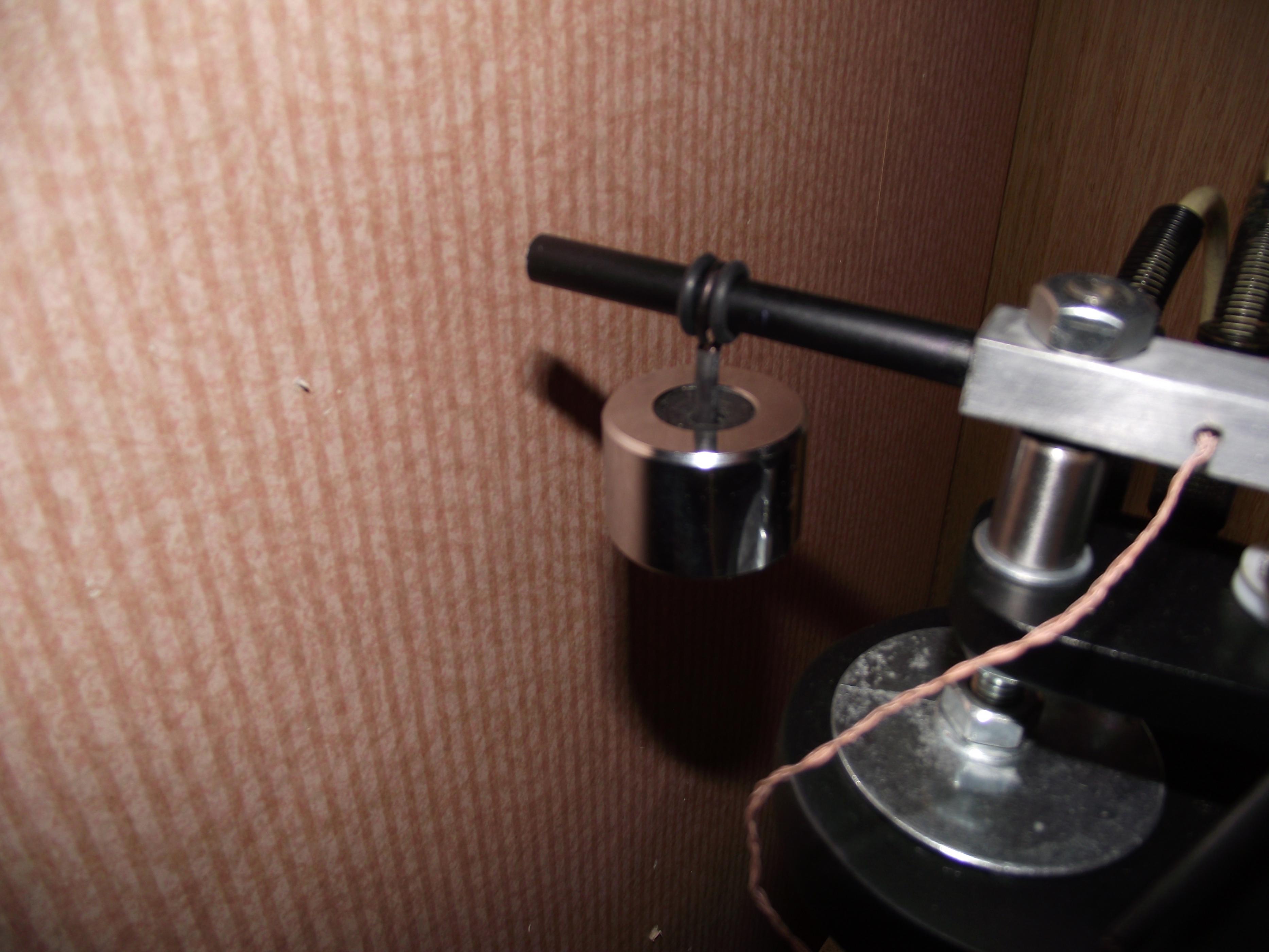

Nanook's counter-weight
here's a photo of one I just made. For all the B.S. involved the "string-weight" is as good as any. I haven't added a pivot for the weight, but the locking collar easily grips the heat-shrinked arm tube without the set screw being tightened. The red arrow indicates where a pivot should be placed.
A lighter collar of an appropriate size (maybe made of wood or acrylic, OD=3/4", ID=3/8") would allow the counter-weight to not crowd the pivot . I did make a wooden collar, but didn't drill out the hole for the pivot to screw into, but not enough. It cracked when I started to screw the pivot into it .

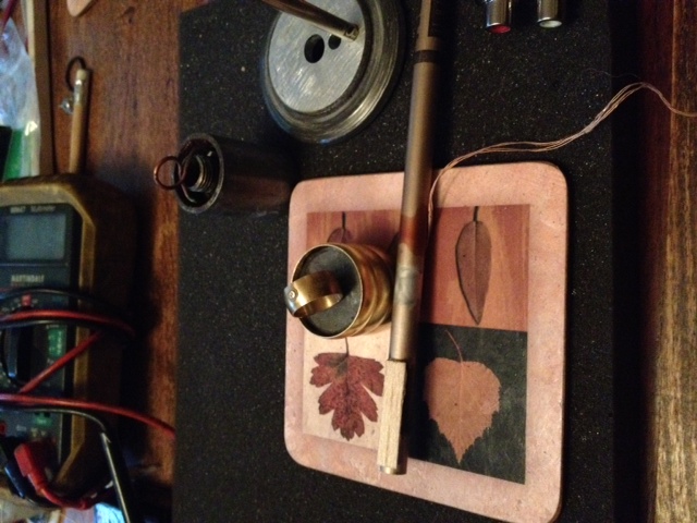

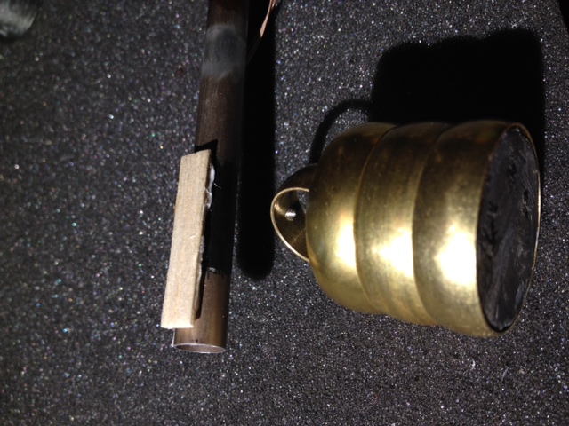

New C/ weight
Hears one iv'e just put together.
It seems a bit unstable on top of the arm tube. thats a bit of balsa just to hang it on rather than doing a groove at the moment.
Im going to think of some way to hang it from the bottom of the tube......

If your interested its made from 3 x 30mm brass olives & 1 x 15mm brass olive, and a load of LEAD stuffed inside the large olives + 1 ball pen nib & all stuck together with a small amount of silicon.
Im sort of thinking of perhaps a slot (I know a hole would be better but its position would need to be right) cut into the underneath of the arm tube, so that weight could hang on a string ?

the "dumb" counter-weight...
... isn't dumb at all. It is still my preferred counter-weight. If a string or similar is used the coupling is approaching that of a pivot, but so much simpler to implement. I've used O-rings before, but I like the idea of heat shrink on the "stub end" of the arm, as it allows for very simple adjustment for azimuth.
One thing to point out as well: the lighter the counter-weight, the farther from the pivot it has to be, and therefore no interference between the counter-weight and the bearing pivot.
