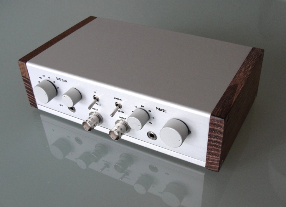

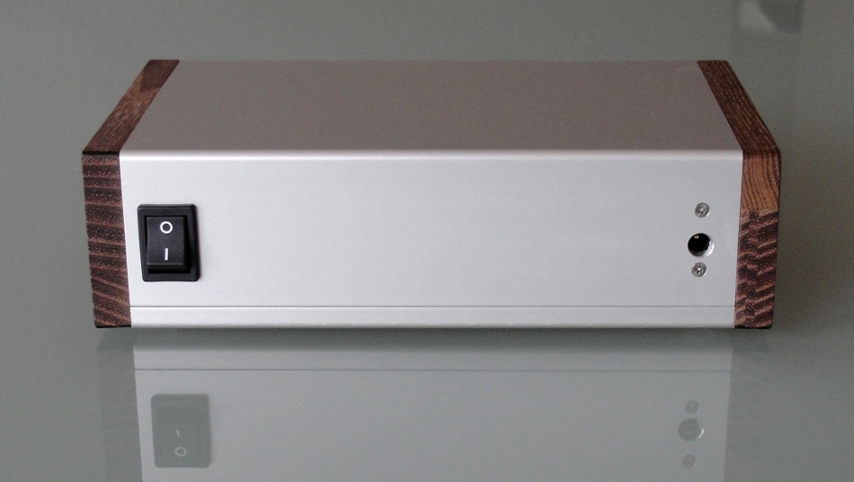

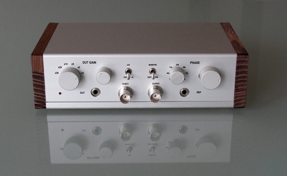

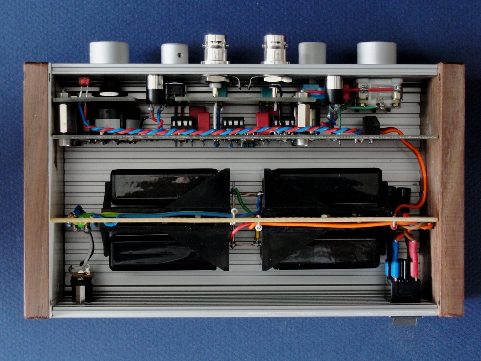

Distortion Magnifier
Finally finished (95%; need to get my 24 bit sound card & software going for some more measurements).
The BNC sockets give a sense of scale. Overall size is 160x100x55mm (tiny).
Input from DUT and Signal Source are both balanced, using 3.5mm phono jack as connectors.

Someone PMed me and asked :
"How do we connect and use your Distortion Magnifier V2 Public with a sound card ?"
The DM subtracts the original signal from the output of the Device under Test (DUT), while adjustments for gain and phase. The remaining output is then distortion (and noise). You may want to analyse the frequency spectrum of the distortion, or determined the RMS value, .. etc. Here, you can use a sound card with freeware.
Of course you can also use professional equipment for the same purpose.
