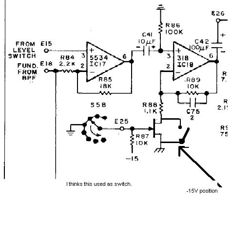

Hi abraxalito,
I refer to Q7 FET (see image).
I think it's so :
biasing to -15V, it has several Mohm between D and S, then R88 is isolated from GND.
Placing the gate to ground, it switches to max conduction and "connects" R88 to ground (+ Rds on).
I think it's so.
Ciao
Giuliano

That FET is indeed used as a switch. When on it increases the gain of that stage by a factor of 10. It is in the distortion residual path, so that any small amount of distortion it adds will not impact the analyzer's performance. A relay in that position will work fine, but it will likely not improve analyzer performance.
Bob
