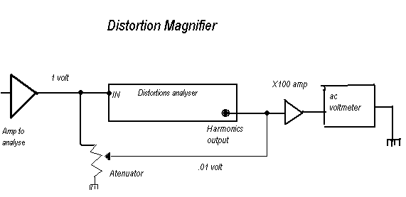

The Distortion Magnifier I built (described on my website) can increase the resolution of my analyzer, an analog spectrum analyzer, or a PC-based analyzer by 20 or 40 dB. This really enhances the ability of a sound card.

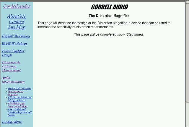

Hello
I think that Bob Cordell mean this description (untill the full description and schematics page will come);
Fom; Cordell Audio: Distortion & Distortion Measurement: Sensitive Distortion Measurement
----Consider a power amplifier that is producing 20 volts rms at its output with a THD of 0.001%. The distortion component will be on the order of 200 microvolts (100 dB down from the fundamental). The amplifier has a gain of 20, so the input is 1V rms. The output is scaled down by a factor of 20 to 1V rms, and the input is then subtracted from it. That leaves a distortion component of 10 microvolts. If a distortion magnification of ten is desired, an amount of the fundamental equal to 0.1V is then added to this signal, and the result is fed through a gain of ten. The result is a 1V rms fundamental and a 100 microvolt distortion signal to be fed to the THD analyzer. It can be seen that a 100 microvolt distortion signal on a 1-volt fundamental amounts to a signal with distortion down 80 dB, or 0.01 percent. The THD analyzer thus displays a THD value that is ten times the actual value. For a magnification of 100X, a 0.01V amount of fundamental would have been added back to the subtracted signal, and the result would have been multiplied by a 100X gain, resulting in a 1-Volt signal containing 0.1 percent THD.
Note that distortion and noise in the sinusoidal source are also reduced in the same relative proportion. As long as the DM is implemented with operational amplifiers with very low distortion, the distortion measurement floor of the resulting system is reduced by 20-40 dB.----

Hello
Your Distortion Magnifier would be very usefull for my old HP-333A distortions analyser.
Could you post a simplified working circuit of your Distortion Magnifier ?
I've made a drawing of my understanding of your ideas of this Distortion Magnifier, is my drawing are close to your ideas ?
Thank
Bye
Gaetan
