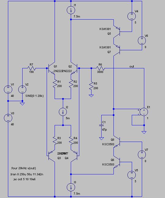

suggested topology, in consideration of function and transistor properties:
Andrew,
Hi Lumba
I'm not sure I understand correctly.
Is the input to the gate of T1?
And the output is from the drain of T2?
But that is connected to VS1, IS2 and R1, so the output voltage swing will be applied to these as well.
Is that right, or should those parts be connected to the positive rail?
Regards - Godfrey

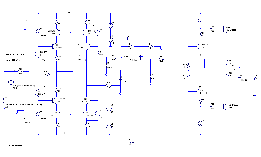

Good topic, Glen K.
I came here after google searching for 'folded cascode'.
This is because I am working/investigating in Spice with a
- symetrical input feeding into a 'vas' with
- cascoded folded cascode
(like diagram in your first post:
http://www.diyaudio.com/forums/atta...scode-vas-linearity-investigation-figure3.jpg )
- output buffert is one Class A Sziklai power stage
Thanks for very good stuff, Glen!

Hi Lineup
I agree, this is a very interesting thread and Glen is “in my opinion” ingenious.
BTW: you may have noticed that GK is no longer a member at this forum, so he is not able to answer your post.
Cheers
