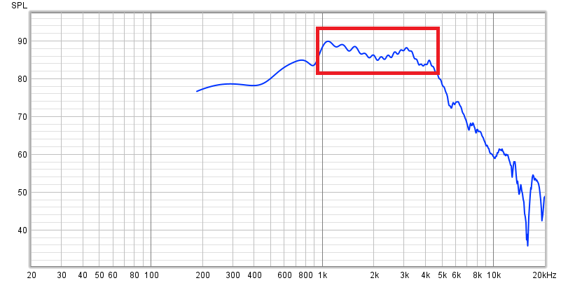

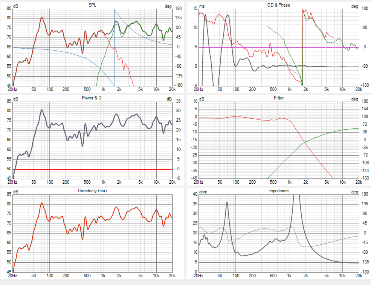

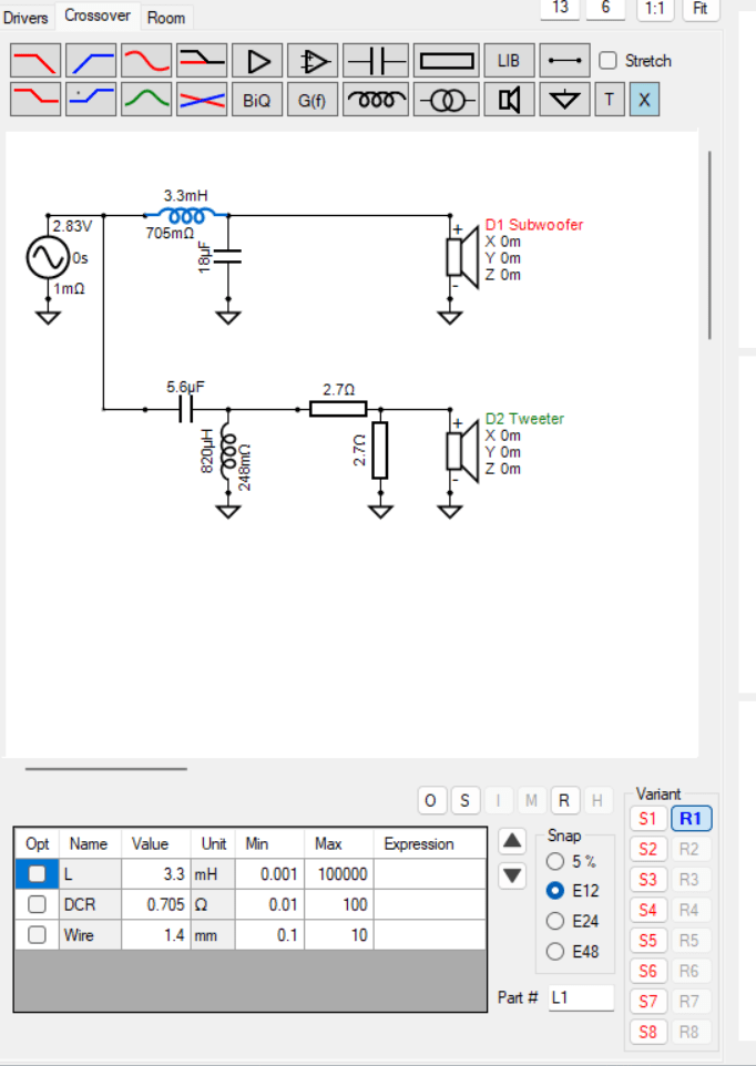

This feed is quite old now so not sure if anyone is still looking at it! Nonetheless I have now bought some measuring equipment, I now have a DATS V3 and an audio interface with a condenser mic. I managed to make my own ZMA and FRD files and came up with the bellow design for a crossover.
The mid response on the sub isn't ideal but I think that might have to do with how I took the measurements as the response file from the supplier don't have the same spike around 500hz. I'm quite happy with the look of the crossover design but there might be some glaring issues that I'm not seeing with it. If anyone has some advice on how to improve it that would be great!
It seems you have some heavy room influence. Did you take gated and/or nearfield measurements for the woofer?
By the way you can rely on response simulations for the lower end, that's a common way of doing it. Then you could just use gated measurements and simply disregard the cut off or apparently downward sloping response of gated measurements.
Also the woofer impedance wiggles at the lower end indicate a measurement issue. Was the woofer firmly held in place during measurements? Were there any external noises/vibrations during the impedance measurement?
I took nearfield measurements for the woofer but haven't tried gating the subsequent measurements, is this something that I can do from the file created by the software I use? What kind of simulation software would you recommend to look at this? I measured the impedance using the DATS V3 with the speaker firmly secured to the box, I think it is more likely that external noises are the reason for the wiggly impedance - I might see if I can apply some smoothing to the graph on the DATS software or have another crack at taking the measurement in a quieter place.

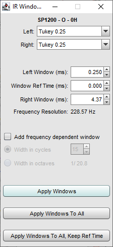

Does this involve shortening the frequency range of the sweep or doing something else entirely?
You can apply gating (eg for excluding room reflections) to any measurement in REW. It's quite interesting to see the influence that has!
Have a look at the rew help regarding "ir windows":
https://www.roomeqwizard.com/help/help_en-GB/html/impulseresponse.html#top
I usually use 1 ms for "left width" and 5 - 10 ms for "right width" and leave "ref time" as it is. Have a look in the impulse response window to identify the first room reflections and adjust the right window accordingly.
To remove reflections from your measurement:
1. Select the measurement in question
2. Click Impulse
3. Click IR windows above

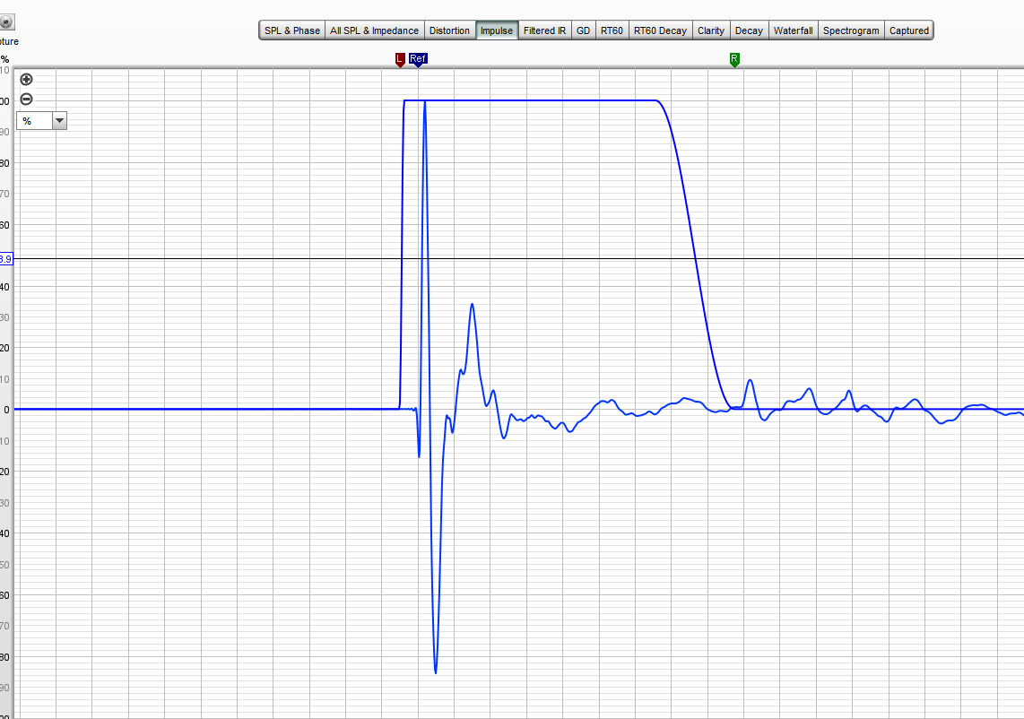

4. Change the left window to something like 0.25 and right window to 6 (so you can see them in the main REW / impulse window
5. Drag the R marker in the impulse window until it is left of the first peak = your first reflection (as shown below)
REW will show you the effect of gating dynamically on the frequency response as you move the R marker
Reactions: 1 user

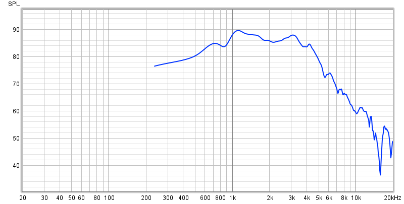

The gate length determines how low you can measure reliably (getting a full wavelength). The rule is 1000/gate window in msec. Therefore if your gate is 4msec (roughly mine above) then I can get down to 1000/4 = 250Hz lowest frequency
Here's the result of the gate on my woofer measurement as an example. Note: this is a far field (i.e. mic a distance away) from the driver.
If you start to include reflections, you'll see ripple appear in the response. This means your gate is too long (R marker too far to the right). Here's an example of the same measurement above, but including reflections (we dont' want this ripple)

When you've managed to get good gated measurements, post them up. There are few more steps to do, so you can have useful full range measurements for crossover design. Preparing useful and accurate measurements takes a bit of effort. but this then assures you of a crossover simulation and design that will reflect reality. Trust me, this makes the whole crossover design process a lot less frustrating / painful and will get you to an optimised result much quicker, especially when it comes to ordering passive crossover components.

This is a lot of very good advice, it should make getting more reliable readings a lot easier! I can imagine that the small things wrong with the measurements will make large changes to the audio quality at the end. I'll try get some more measurements this week and see if I can improve the accuracy of my measurements and crossover design to come!
