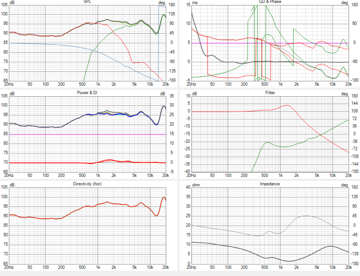

And the resulting graphs from this
I can tell from the frequency graph that the tweeters aren't doing a lot, now I'm not sure if this is from how I've tried to link them in parallel or how my attempt at a Zobel network has affected the level of these drivers. Or whether it is a good idea to have them connected at all or if I should just use the horn and bass drivers to make the speakers. Any advice on how I can better improve this design or use this design to inform another design would be greatly appreciated!
Why are there so many tweeters, I'd generally advise against this as you will encounter serious comb filtering effects (driver interference)
How high can the horn driver go frequency wise?
Your impedance is going incredibly low towards 20kHz, that would effectively be shorting the amp.
You are also crossing your tweeters and horn above 20kHz, why bother adding them when they are doing so little?
The source of the shorting is the resistor parallel to your horn driver, its value is 68 miliOhms which is tiny, I'd increase that as well.
The capacitor value on your horn driver zoble network is 2.7 miliFarads which is probably 1000x larger than intended.
You are also using some very large capacitor values on your bass driver for its crossover, see if you can decrease those while maintaining the desired crossover frequency, take steps changing the capacitor and inductor values.
Definitely a learning exercise to learn the software.
You would have to model the drivers on the baffle and what position
they will be at. Since how phase interacts and baffle step comes into play.
It is just a horn driver and does not represent the frequency response with
a horn.
Plus as mentioned the impedance curve is almost dead short.
No amplifier would be happy with that load.
I would try to find drivers that can be modeled realistically.
And model the baffle. On positive note the woofer looks like
a fun unit to start with. Find a single mid and tweet that will work
and model the baffle. So you can see off axis behavior and baffle
step. And also why such a large array of tweeters would not
work very well. Luckily there is a pre designed 3 way in the software
including common compensation for impedance if needed.
You can scroll the values and makes the learning curve easier.

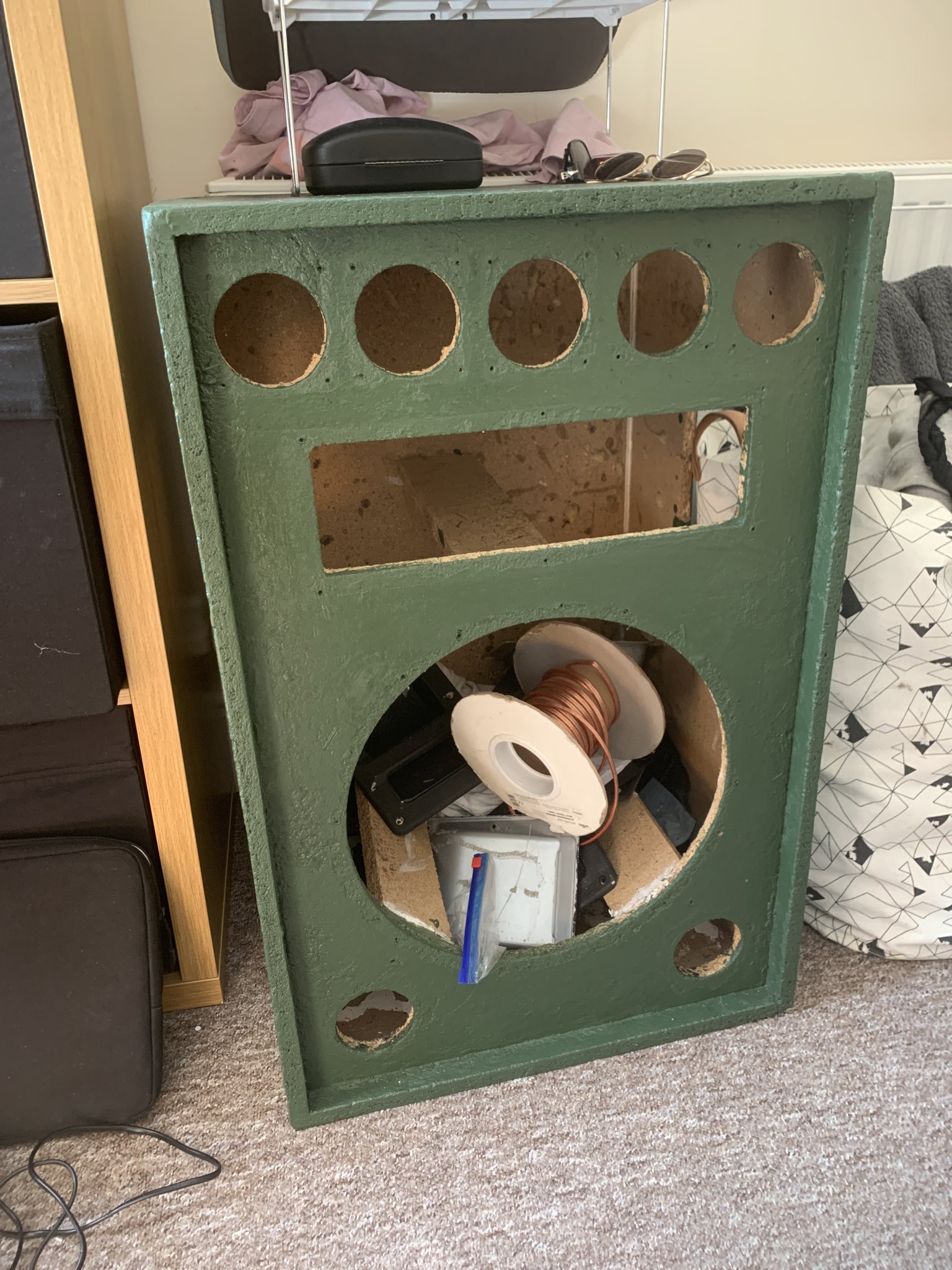

This photo is for reference so that the excess of tweeters makes more sense. The only reason I had 5 was to fill the spaces in this box which I’m rebuilding. I would be very happy to drop down the number of tweeters to say 2-3 or completely ignore them and just go for the horn driver to fill the middle section. I also just thought that maybe instead of tweeters two smaller “full range” drivers could be used but this might not be practical in actual design. The range of the horn driver is 2khz-20khz would I want to look for one that deals with more of the mid range to make it more valid in the build? The low impedance at 20khz is due to the zoble network I tried to implement flattening the impedance incorrectly so that’ll need correcting. To address the talk about baffles, I’m assuming this is about the size of the box and spacing of drivers within said box. Can this be changed within the room settings of vituix CAD? As far as the horn driver yes it is just a screw in horn driver I’m still yet to find a horn for it. Will the shape and design of the horn effect how I design the crossover?
