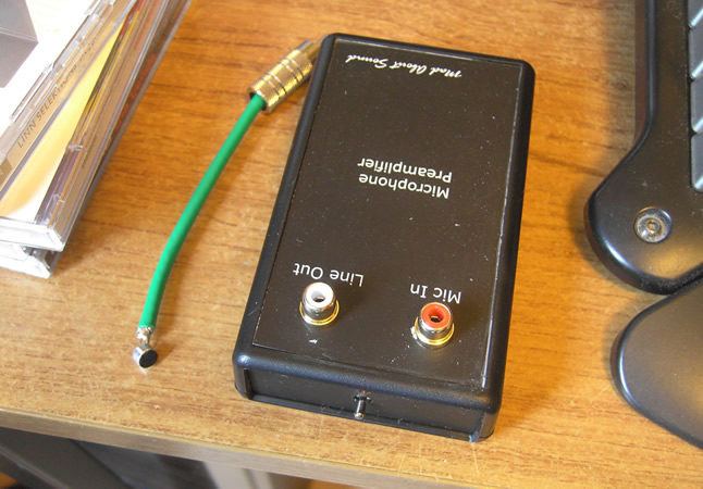

SimontY said:
Download ARTA, get a flat microphone (like the one on the site I linked to) and build that kit or get a preamp. (...) The capsule will do the same or a better job for peanuts. It needs soldering to a bit of coax or something - this is as good a stand as you need and avoids reflections.
Hi Simon,
How did you make them work? Care to post/mail a picture?
They have great specs and are very cheap comparing to decent measurement mics (200€ and up)
Simon I am the master of doing crazy things, just look at the problems i have had by reading my threads, you will see the controversy i have caused!!!!!!As a newbie i am obviously an easier target. OOOps sorry i know i registered way back in 2005 but have only been active in more recent months
Luke
Luke
I just soldered the capsule onto some coax and that onto an RCA plug. This plugs into the kit preamp and you're away.
The capsule comes with a calibration file, which is easy enough to load into ARTA. I think you have to rename the file extension to make it work.
Simon
Simon
Hi Simon,
Can I ask you if the LED on your mic pre flashes very briefly when the switch is moved one way, and stays lit slightly longer the other way?
If this is correct I assume the long flash is the higher of the two gain levels available...I haven't tried mine yet.
Cheers
Stu
