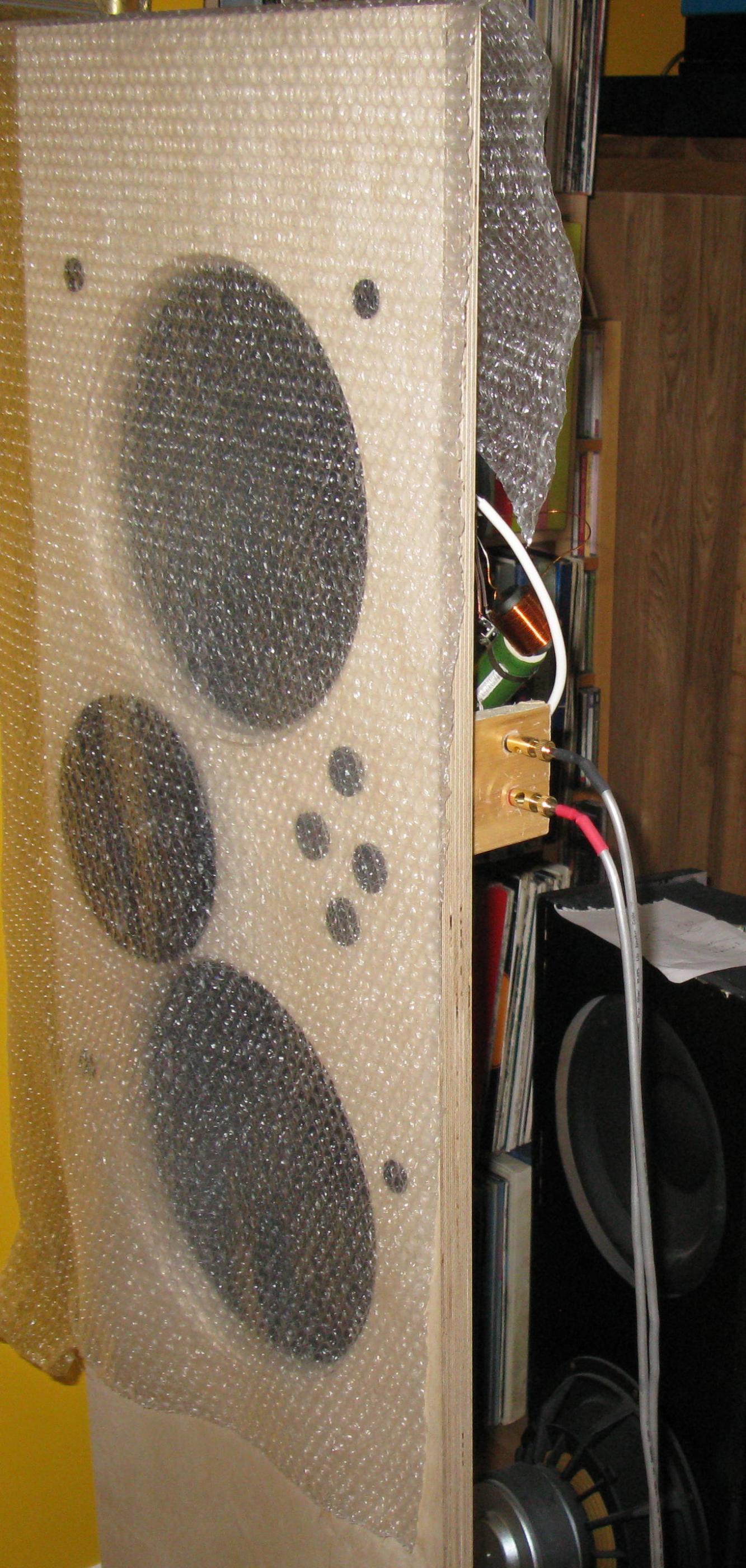

Probably another old hat, but related to cancellation of front and rear waves, simply turning the speakers outwards facing towards the side walls has a tremendous impact on tone. Ideal for my room and equipment is a 10 degree turn outwards to the horizontal line. Yes focus goes a little, not much but voices in particular sound so much more tonally correct and hence more real.
BINGO?? BINGO??? BINGO???
Mad rush of thought............ electrostatics are the bees knees when it comes to microdynamics and harmonics...... thin membrane that vibrates...enclosures do the harmonics thing but enclosed in an air bubble. Combine the two and you have BUBBLEWRAP........... Zap it with sound waves and you have an enclosure vibrating................... but thin enough not to effect the dipole effect in an open baffle.
Tried it with small bubble single layer front of speakers only....emotion from voices and instruments was once more to my hearts delight restored with an obvious increase in harmonic texture. Could not believe Harry Belafontes voice, I had forgot how he used his voice to pass an emotional message across with the intonations of his singing. Tried double layer ...no good....tried back and front....echoed.....tried large bubble wrap worse...tried thin cloth covers as placebo....worse much worse!!!
This is my patent for the idea if it gains any credibility and if I remain convinced after more listening.
Imagine ultra thin bubble wrap material we have a genuine mad cross breed.

obviously need lot more experiments i have only just tested this, the obvious one that comes to mind as a placebo is having just thin plastic to cover the front of the speakers without the bubble.
what about on the dipole woofers??
What about how firmly the membrane is attached to the speaker cone and/or the baffle??? Distance from mebrane to speaker 1cm or 5cm, and what is the optimal bubble size/volume and what about the space between them. So many possibilities

You sir, are bonkers
However, you're not alone. I'm trying it too... not much to say yet as I'm not hearing a big difference and am confused because I've just run off a million changes on my speaker (right channel only for testing) today. I reckon it must be doing something, and I think it does perhaps sound a bit more full-bodied. I expect it will be attenuating high frequencies and doing gosh knows what else.

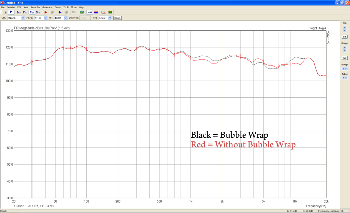

Thanks Simon for that
I am no expert but that graph indicates the sound changes heard are not due to an attentuation of frequency effect. The measurements obviously do not show harmonics therefore that adds strength to what i am hearing. I think your graph has gone a long way towards proving what I am hearing. No loss at any frequency but a gain in perceived harmonics.
You should be hearing more expressive emotion from the music you are hearing now???
I don't really know. That graph shows changes that could be audible, but I suspect there's much more to it than simple frequency response. I only did a fairly quick test because I'm still ironing out my basic crossover design. When I've got the 2nd speaker wired as the first I may try the bubble wrap for a longer audition.

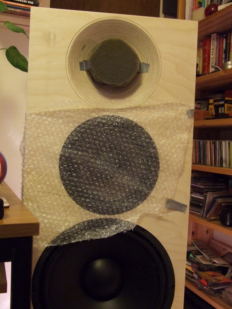

Done a little bit more experimentation.
Having the bubble wrap on the front of the speaker baffle clearly reduced spl and reduced the tweeters output most severely. Yes there was still that improved emotion and tonal warmth to the midrange, but the high output loss was too restrictive for continued listening. I am surprised that such a strongly audible anomaly was not clearly demonstratd by Simon's measurements. The veil was certainly there and this was somewhat contrary to my original findings, where I clearly had not tested a range of CD's and simply got excited by my midrange vocal findings.
Tonight I replaced the bubble wrap and let it cover only the rear of the speakers. Tweeter was once more unrestricted but to my surprise the apparent microdynamics had clearly improved further. I was extremely pleased by the detail and tonal realism that was coming from the speakers. Furthermore soundstaging and clarity had improved. The instruments seemed more locked in their positions and had clearer focus. Certain instruments were producing that startling factor when they suddenly came into a mix with such clairty and presence. Voices now had even great tonal depth with more air and detail also apparent.
I next repeated the experiment using the larger sized bubble wrap and once again there clearly further improved microdynamics and focus with an overall very much more refined soundfield. There was no obvious attenuation of any frequency or veil apparent. This was clearly a big step forward.
I suspect a lot of the imrpovements may be related to the way the soundwaves travel and how they are controlled by the bubble wrap rather than due to some half baked idea regarding resonance within bubbles!! but i leave those theories to those that are in the know.
Have I at long last successfully married open and closed box sounds without affecting that tremendous clarity and mega dynamic range that we so dearly love open baffles for?? I believe I am getting very close.
Will report back after more listening, but this is, for me at least, at long lasting becoming a truely exciting project. I hope more of you can try this very simple experiment and report back.
