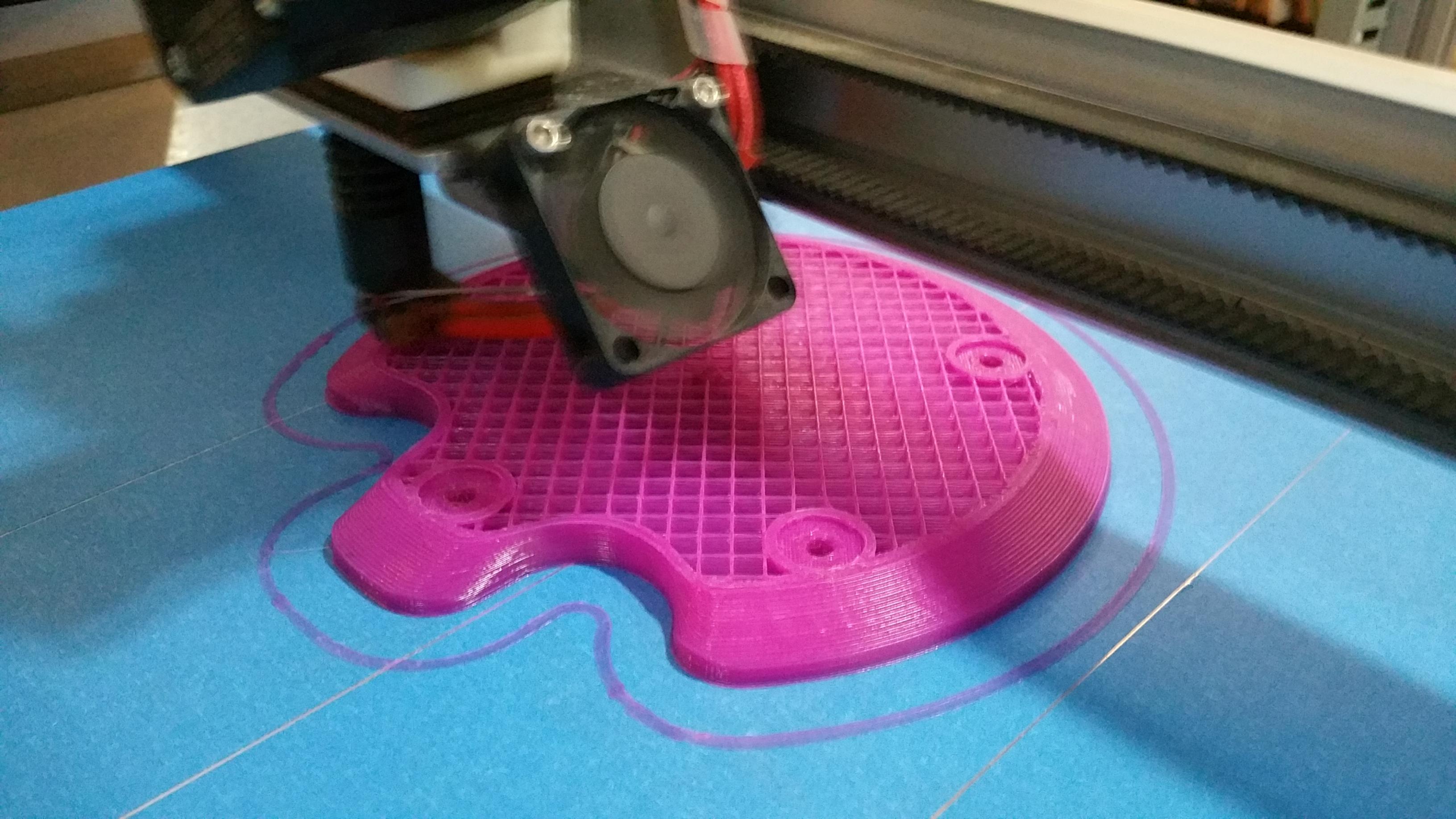

Finished designing the jig for the six circles needed for the x-ls encore:
It's designed to screw onto this $30 trim router from harbor freight (that we own):
1/4 in. 2.4 Amp Trim Router
Going to print out the jig right now on 3D printer in cheap PLA.. about 70 cents to print.
I'll let you know how it works. Hopefully the trim router is strong enough to plunge into 3/4" MDF?

400 watts isn't a lot. My (crap/noname) 1/4 inch router is 1020 watts...
I feel you will get dizzy circling the work with many shallow cuts to get through. :)
The plunge routers or maybe the fixed base 2HP model might be a better bet.
Though if you drill your centre hole all the way through you can flip the work and start routing in from the back too.
You seem capable so apologies if this is obvious.... Changing the size of the router bit changes the diameter of the routed hole by the difference in the radius of the bits. I say this as I have 1/4", 3/8", 1/2" inch and 1 1/8" straight cut bits, all of which fit a 1/4 collet router.

Thanks. Yeah I have a variable called "bit_diameter" that I use in part of the calculation :)
Later on, if I have a different speaker I am working on all I have to do is call the guidepin module with the appropriate diameters in millimeters. And it will create a new custom tailored one. Takes 5 hours to print at 100% infill and about 70 cents of material (PLA).
Ignore my choice variable names and lack of some variables :) Could of chosen better names and typed in less hard coded values :) BUt I just went crazy at it with the calipers and started typing in :)
I'm definitely thinking about buying a good quality router with higher horsepower. Any recommendations? Should I get plunge or fixed base?
Once I get one, I'll definitely make an elaborate jig for it similar to the jasper 200 jig that goes for $40. And I'll put it up for free on Thingiverse.. probably about 1.25 or so to print with cheap PLA like I'm using.. one that large that is.
I'll share the OpenSCAD file so someone can easily modify it to match their router as well. Like it will be setup with screw holes for the particualr one I buy.. whichever that might be.

Rather than go with a thinner router hole jig and 100% infill you may have a stiffer more structurally sound jig by making it thicker with 25% infill and 4 solid layers on top and bottom walls but increase overall thickness a bit. The moment of inertia increase gets its stiffness from members near the edges. Amount of PLA and duration to print will be similar.

I took the low tech approach. I made a sliding "truck" on my circle jig. I use a try/combination square butting the far blade of the router to set distance to pin.
Well I tested out the 75 cent jig for the inexpensive Harbor Freight trim router. (well 75 cents for the PLA -- the pin for it was 67 cents from Ace Hardware).
It works :)
