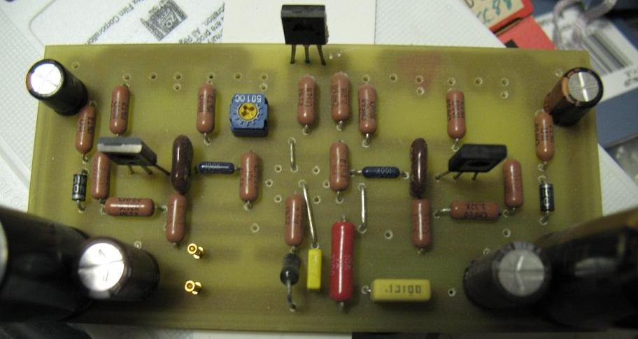

To those who wrote they would give a try to these darlington amp I'll post the layout before I will mod it to include wahab's mode.
The PC board size 112 X 56mm frame to frame , I advise to live some edge for mounting and if you use some exotic large size 1000uF 63V caps.
In that case cut the board done around 130 X 65mm size.
The lay out still remain the given size, all the parts feet very well.
I post the color codes but you have to figure it out the right place of the resisters.
Please pay att. at the input transistors -ECB- BC550/560, in my case JFet they are not face to face.
The 4 emitter resister goes under the PC board! Also the two 68K resister.
Take a look at the pictures.
To set up the bias
Adjust the trimmer to measure the highest R value between the two side of the trim pot (monted in the PC boards)...
After you connect your DMM between the PSU + and the PCB + measure mA or A --
Set up the bias to 100mA.. Please do not use speakers when you do any adjustment!!!
Leave the DMM there for a few hours until the amp warms up. Re adjust the bias after the warm up!
Please do not under estimate the heat sink size, that would lead to a thermal runaway 100% sure!
If you get any offset you can get read of if you chose right the input transistor matching the Hfe or choose a 100K multi turn trim pot (20X) as a adjustable resister, set up that 68K and and use that to replace one 68K resister. From the 68K please adjust that trimmer until you get read of the offset.
Take it out and measure the value of the trimmer and replace it with a resister..
You can always ask question, I'll be glad to help!

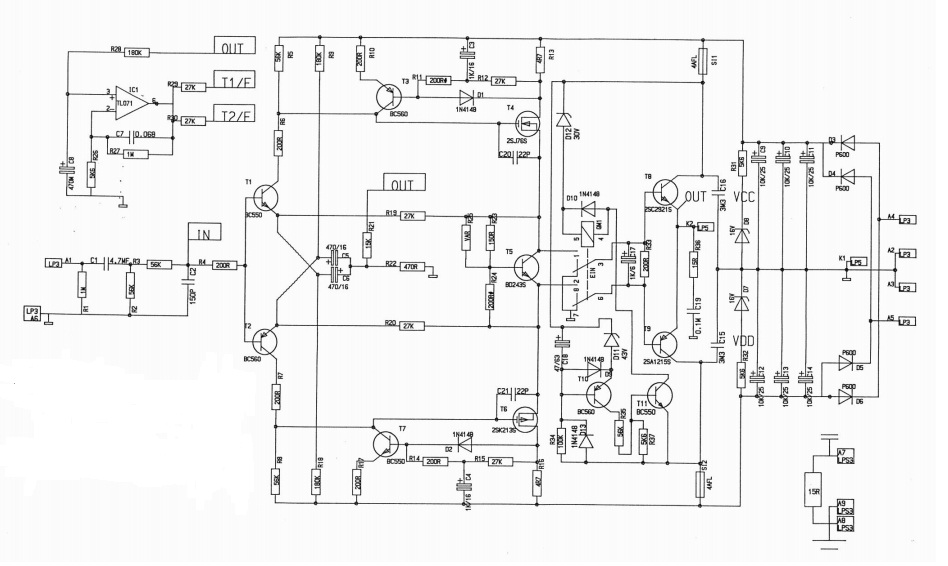

With your mode using those zeners and 40V rail voltage can I stick with the BC550/560C pair??
The emitters of theses transistors are defined by their base voltage
and as such they will be at +- 0.7V for the PNP and NPN respectively
while the collectors are almost at -+40V respectively minus two volts
drop across the VAS emitter/base junction and emitter resistors ,
that s still about 38V to withstand , quite close to the max ratings.
Also I need to know the 220uF V rating. Before 16V was more than enough..
The reason those are special low noise signal transistors.
The voltage across theses caps barely reach 1V , so even 10V models
are already overkill voltage wise but AC wise they are part of the amp
negative feedback loop and as such will define the low frequency cutoff.
With 220uF the gain has decreased by 13% at 20Hz compared to 1Khz,
so this is the lower recommended value , the original japanese schematic
use 1000uF.
When I was looking for the orig BC414C/416C which became obsolete I did tried a lot of transistor there but nothing did the job good as the BC550C/560C. And I was informed the 414C/416C was replaced by the BC550C/560C which has a bit higher voltage but lower Hfe.
In one word I would like to keep the BC550C/560C at the input. Knowing that those transistors are still OK I can swap them to JFet to.
With JFet I get in the mids area more neutrality, more air between the instruments.
There are a lot of equivalent devices in the BC series for 45V Vce but
such devices with C rating (gain > 420) are relatively rare.
The BC550C/560C have gain as high as the 414C/416C ,
they are in fact the same devices but from different manufacturers.
The best possible devices are the very one on the japanese schematic ,
120V 2SA872A/2SC1775 , while the 120V 2SA992/2SC1845 are valuable
replacements.
As for Jfets , in simulations they do no better but i ll take a second
look just in case i missed something in early sims.....
R28 that symbolize the speakers load?
Yes , that s it.

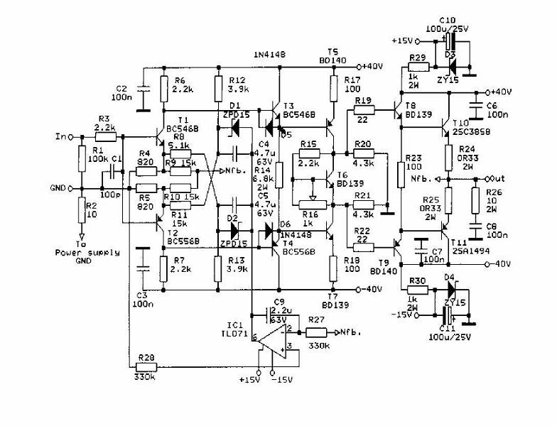

I repost this stabilized version , it is likely the one that will help get rid
of most misbehaviours and , i hope , end all the time waste devoted by
builders to this schematic.

I modified the layout after your circuit.
One more time thank you very much!!
With the FET the amp has better mid-range, become more transparent and natural.
Not just after my ear, other people wrote similar about.
All do some people say it does decrease the dynamic and the deepness of the bass a bit.
Thank you one more time
Greetings Gabor
What about 2SA970 & 2SC2240 from Toshiba, I have BL grade at home......
2SA9702SC2240BL should suit perfectly but if ever the amp yield higher output DC offset than the BC550C/560C then stick with the BCs but make sure that your PSU voltage will never be more than +-45V.
now we mode the front and the input transistors will receive higher voltage if I understood that well.
No , the voltage across the BCs is the same as with the original amp , this is unchanged.
If we take the original schematic as exemple , one can reduce the 68K almost as much as he wants, this wont change the emitters voltages wich will stick at close to +-0.65V , hence only the current through the said resistor and by consequence through the transistors will increase , not the voltage.
Of course , if this current is increased this way , this same current will forcibly yield a higher voltage across the 3.3K that load the collectors , hence the VAS will see a higher voltage at its base thus increasing its collector/emitter current.
Do that influence the power of the amplifier??
Indirectly , but to a very small extent.
You can see that the VAS emitters resistors have been reduced from 330R to 180R.
I had to procede this way because the 100K resistors that once provided an additional current of 0.4mA (that is added to the 0.58mA coming from the input stage) through thoses 3.3K resistors are no more here , so the voltage at the VAS bases is a little less , hence there is slightly less voltage at their emitters so the 330R are reduced to restore the initial 5.6mA VAS current.
Of course , the voltage across theses 180R is still high enough , about 1V , to make sure thermal variation of the VAS wont change it significantly , but a consequence is that the voltage loss in the VAS is reduced by about 0.85V and as much , or rather little , is gained for the max output voltage of the amp compared to the orinal that had higher voltage loss.....
If you advise bigger caps for the 220uF I can test that to..
You can keep the current value for first tests and if swapping the things ,
just take what you have at hands , no need to buy anything.

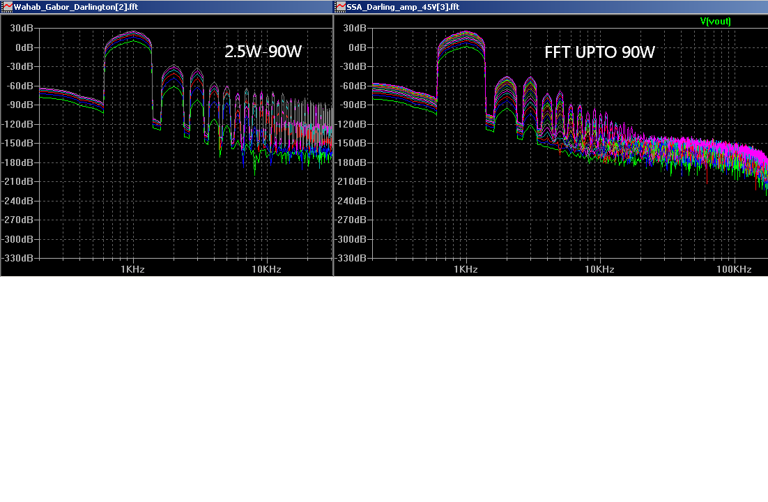

The perfs are quite correct but notrhing exceptionnal , i guess
that it would have been a good amp back in 1972 or so...
The bias i used in sims was 100mA/pair , with a total of two pairs
of BDW93C/94C , adequate for a +-40V PSU and 8R only speakers ,
but 60mA/ pair should be enough given that the total current is 120mA.
The most bothering is DC offset stabilty with temperature.
The original schematic has about 40mV variation for 60°C
variation in active components temperature , while the modded
one do a little better with a 16mV variation in the same conditions ,
still an order of magnitude worse than an average differential input amp...
The perfs are quite correct but nothing exceptionnal , i guess
May be nothing exceptional. But people willingness to accept the temperature stability issues, implies that something worth the hassles, no?
I think the FFT graph (almost) reach the position where good or bad is not only in the graph but lay somewhere mostly in "unknown" places. I simulated using BF469/470 in the VAS which I believe is inferior than your chosen transistors.

Gaborbela, here are two circuits. The first is a commercial design which was very popular in europe and recieved very high acclaims for its sound. Most reviewers claim was that no distinguished difference can be heard between it and a top notch tube amp. Youll also notice that the design is 100 % based on the original JLH except use of the mosfets as vas. It has none of the shortcomings of your circuit, bias stability is rock stable, as you can see it it was cleverly taken care of although it costs two more transistors and a couple of resistors. Servo was placed to take care of DC offsets and its a class A design. some models used two output devices for higher power, also note the dual feedback as in your schematic. Its part why the amp sounds the way it does.
The second circuit is capable of very low distortion, around .007 with good parts and also stable but this one is class AB. Here the bias stabilty is obtained through other means, it s as simple as it looks.
I can post more models as recent as 2004 using this circuit but here the sound does change somewhat as cascodes are introduced to achieved super low distortion figures. Seems like old 1972 technology is just fine judging by the great reviews the first amp in particular got.
use 1000uF.
replacements.
Hope these mode will not degrade the sound of the amplifier at all.
One of the main reason I want to stick to the well known & tested transistors.

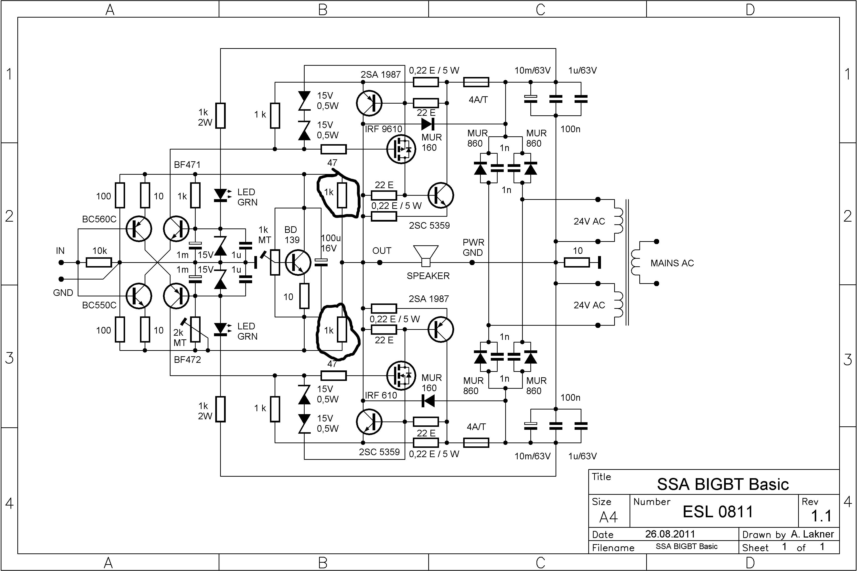

Hi Gabor
probably I was wrong regarding lowering THD at about 10dB, the simulations showed similar values and harmonics behavoiur to the original circuit.
I cannot promise that I will play with the simulations later.
This OP stage was taken from Lazy Cat's SSA http://www.diyaudio.com/forums/atta...ical-amplifier-ssa-bigbt-basic-1.1_zadnji.jpg . It has very high input impedance which is not loading to the vas.
