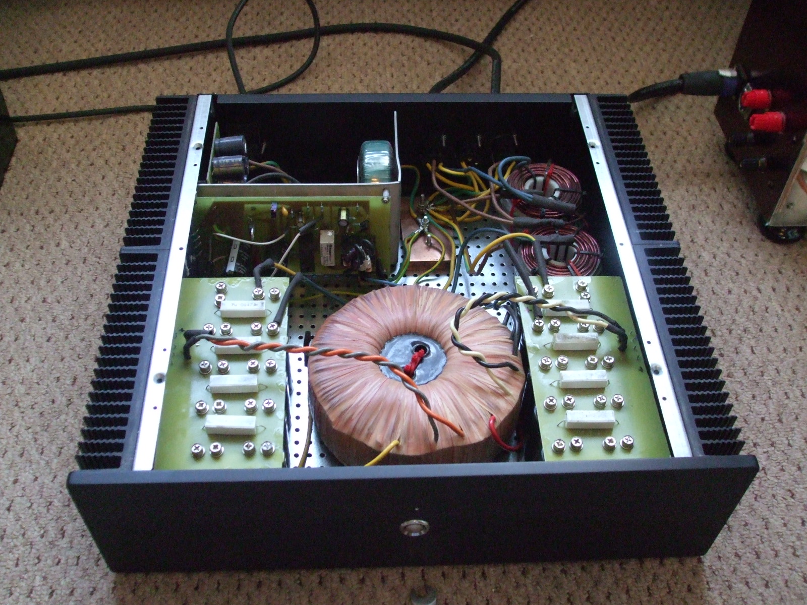

Okydokeyduck

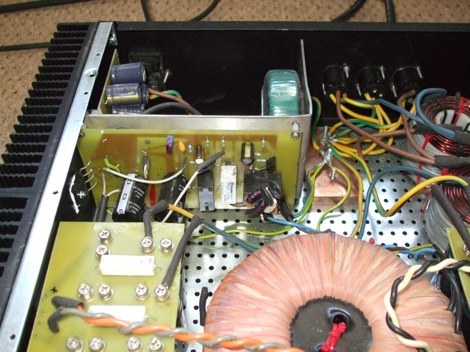

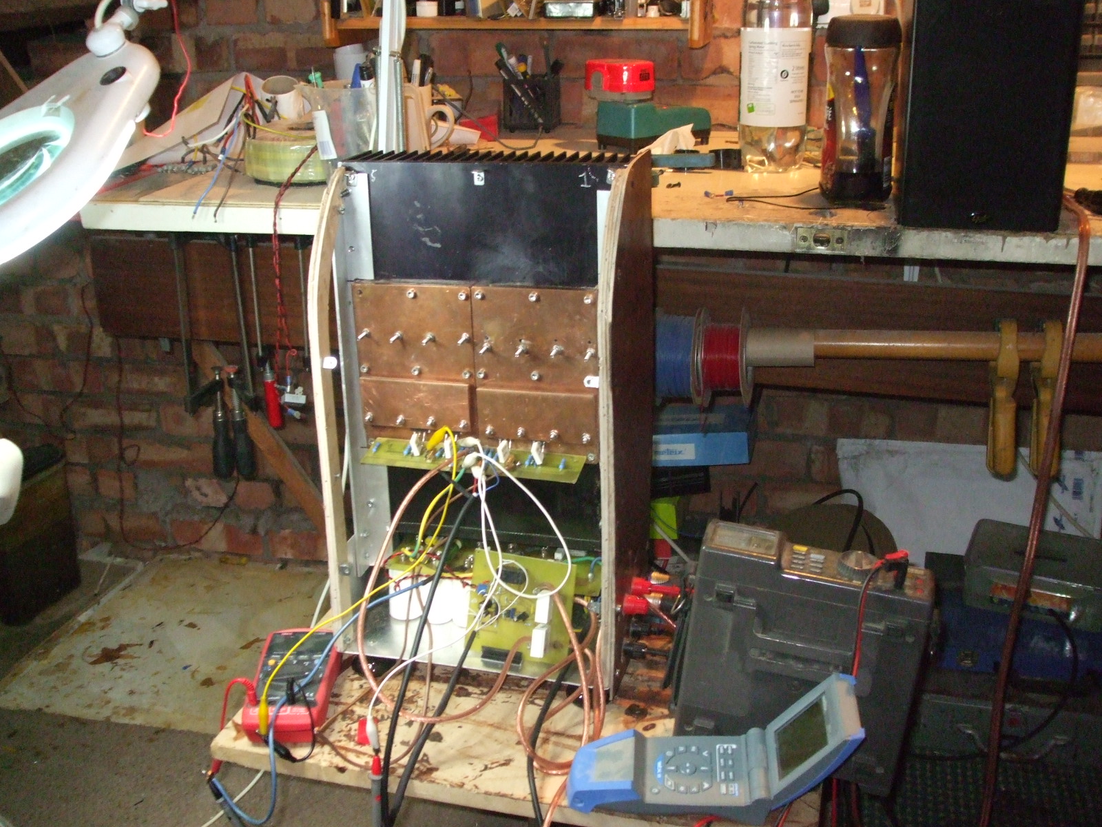

Back from work on proper PC

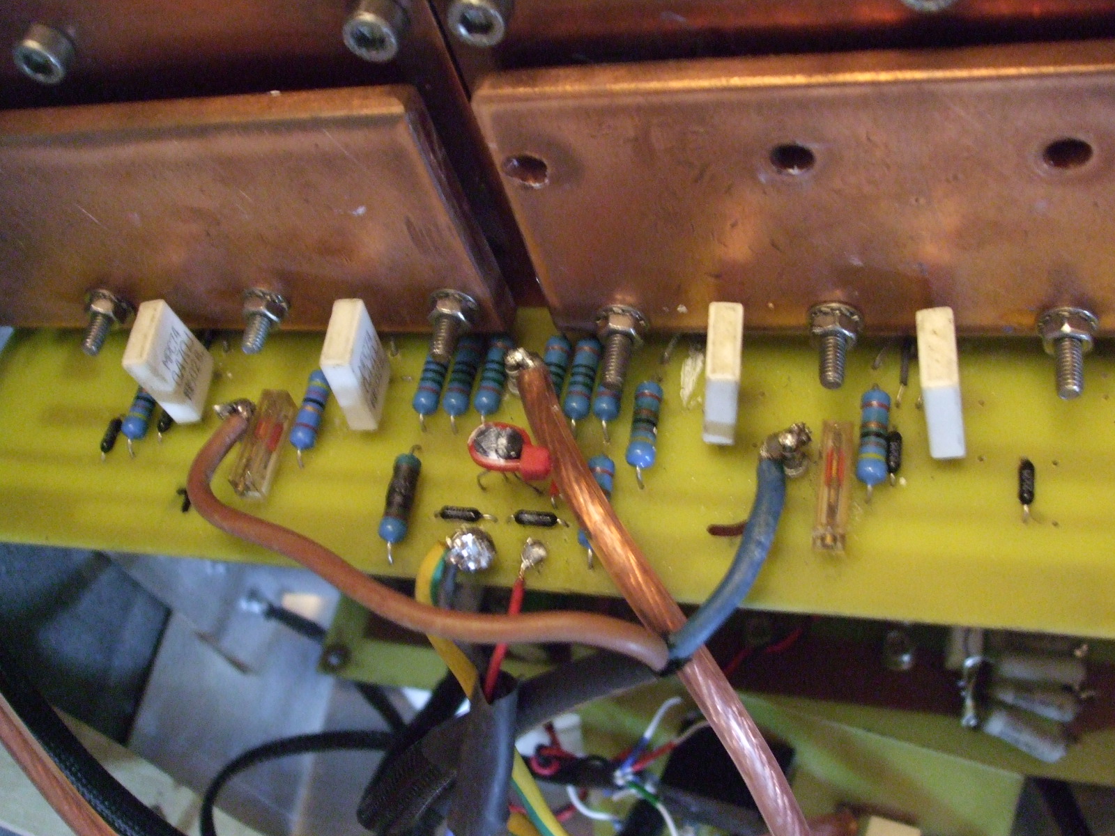

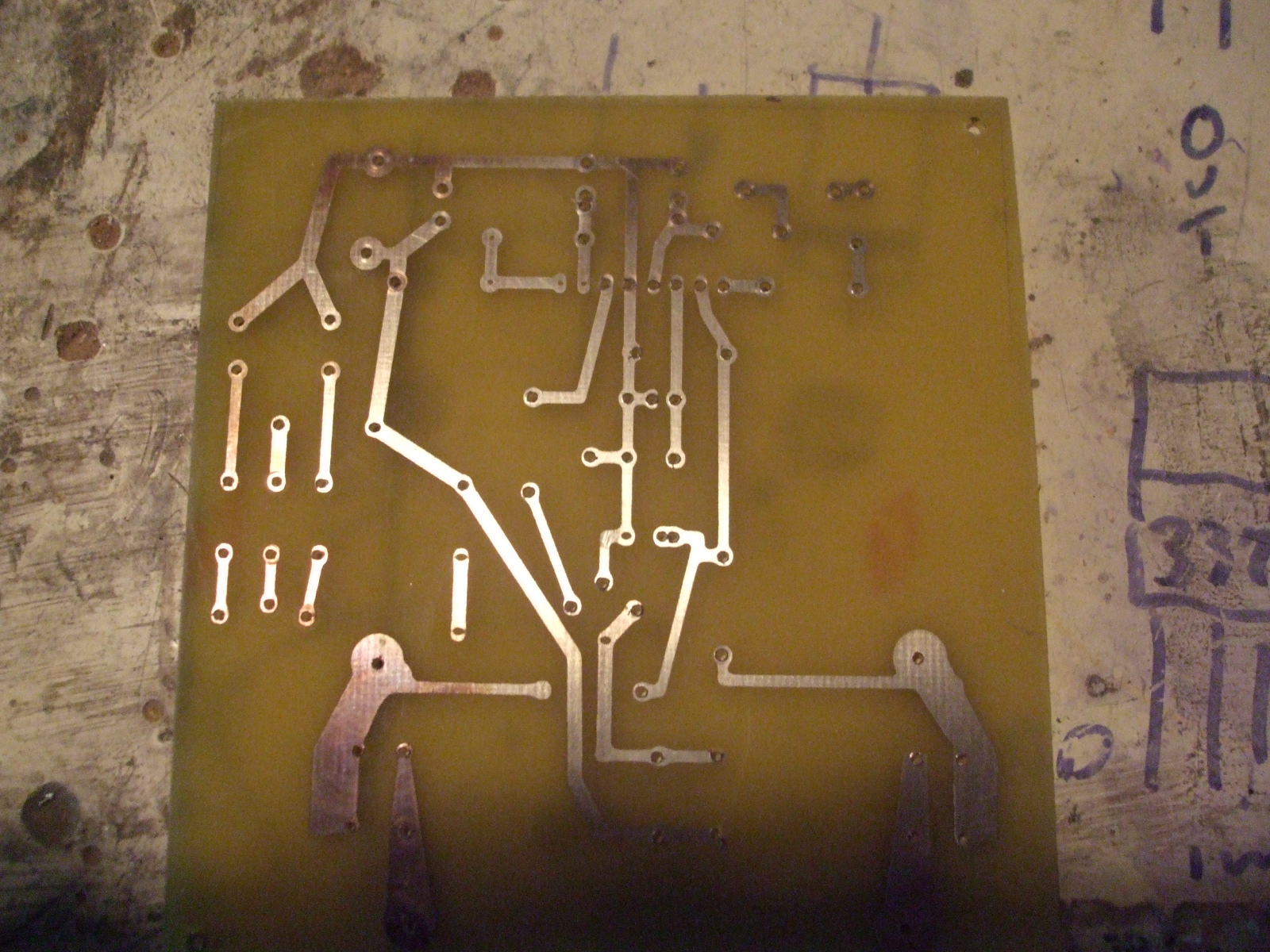

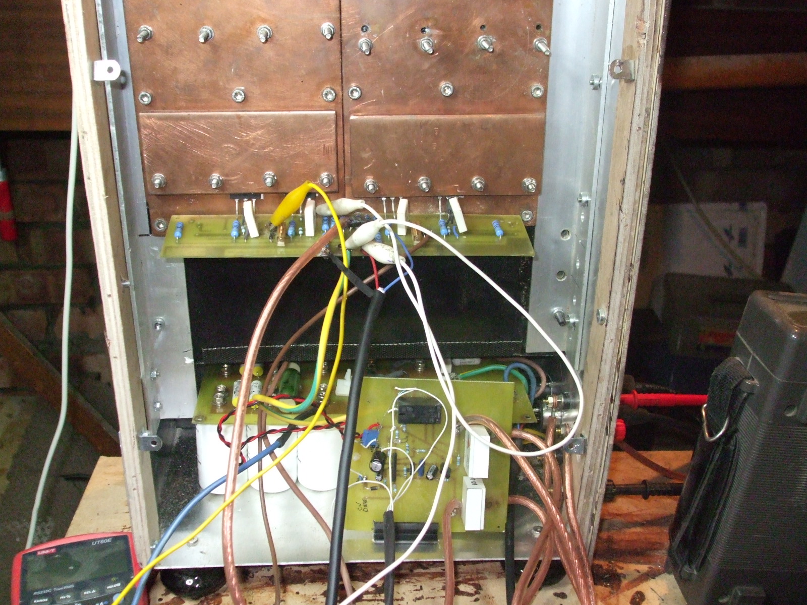

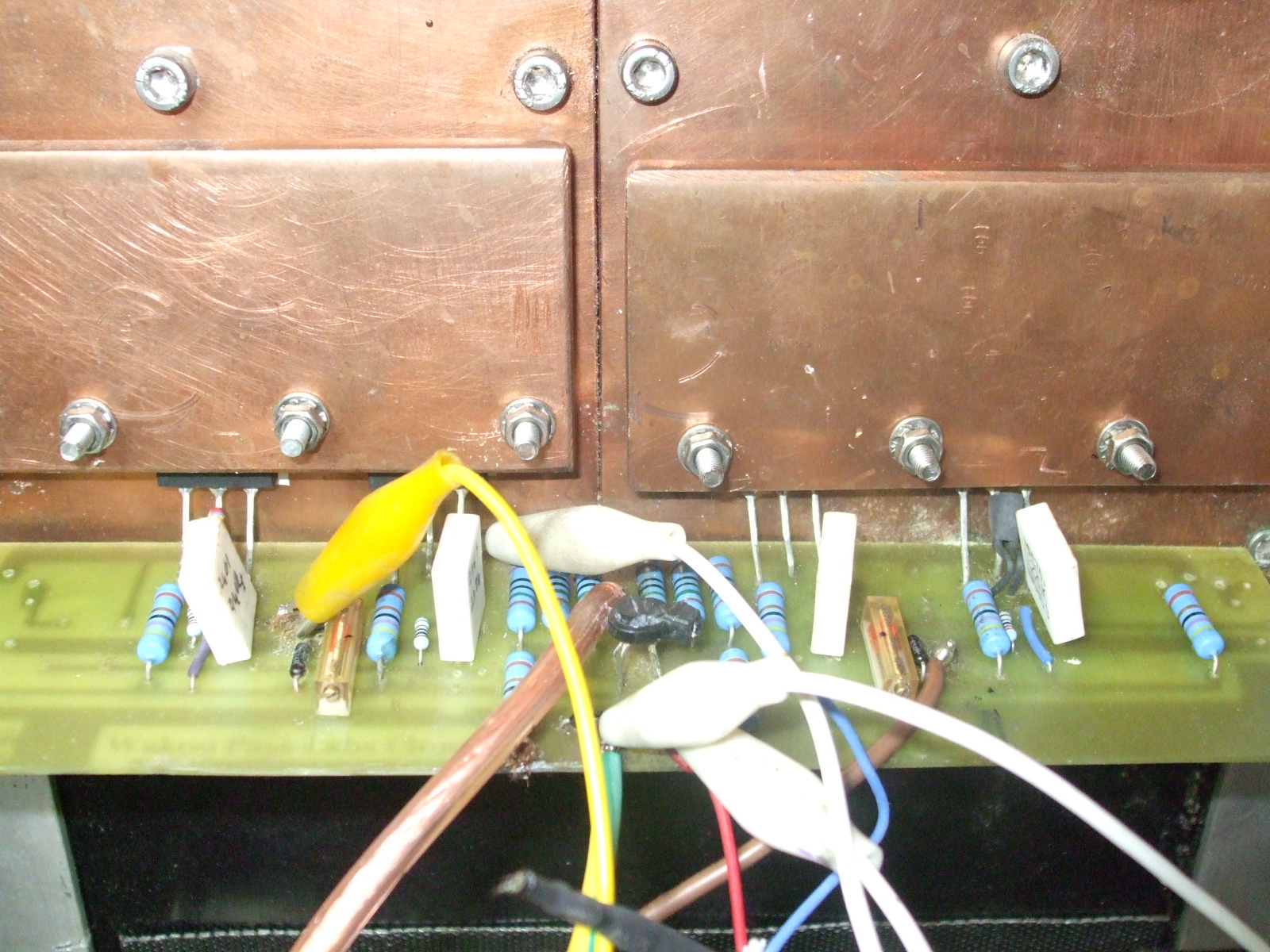

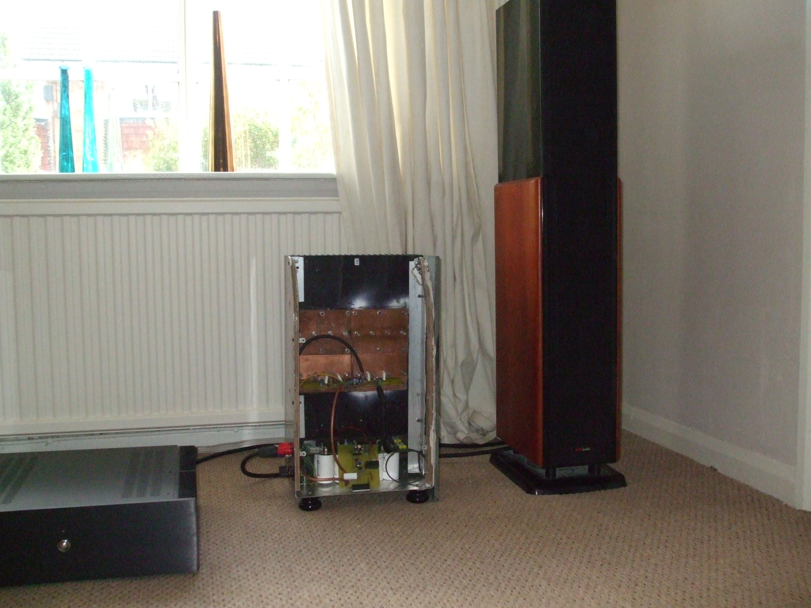

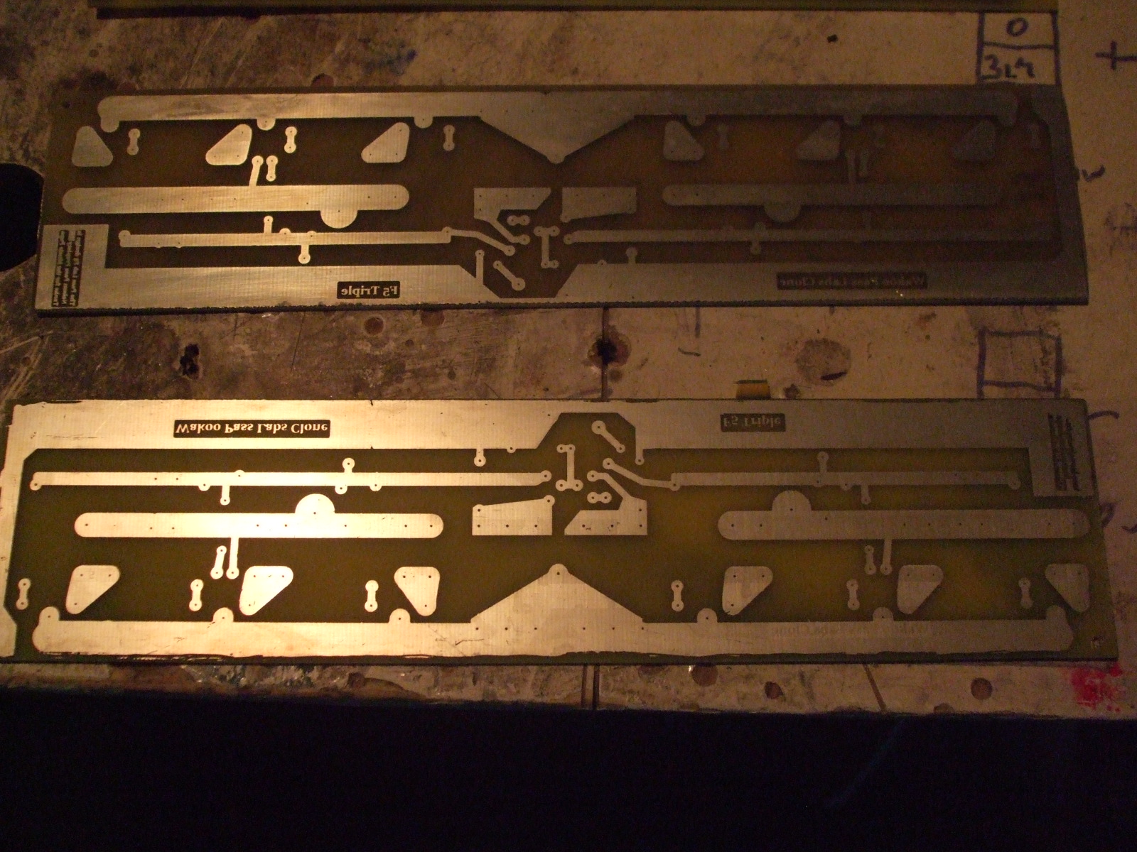

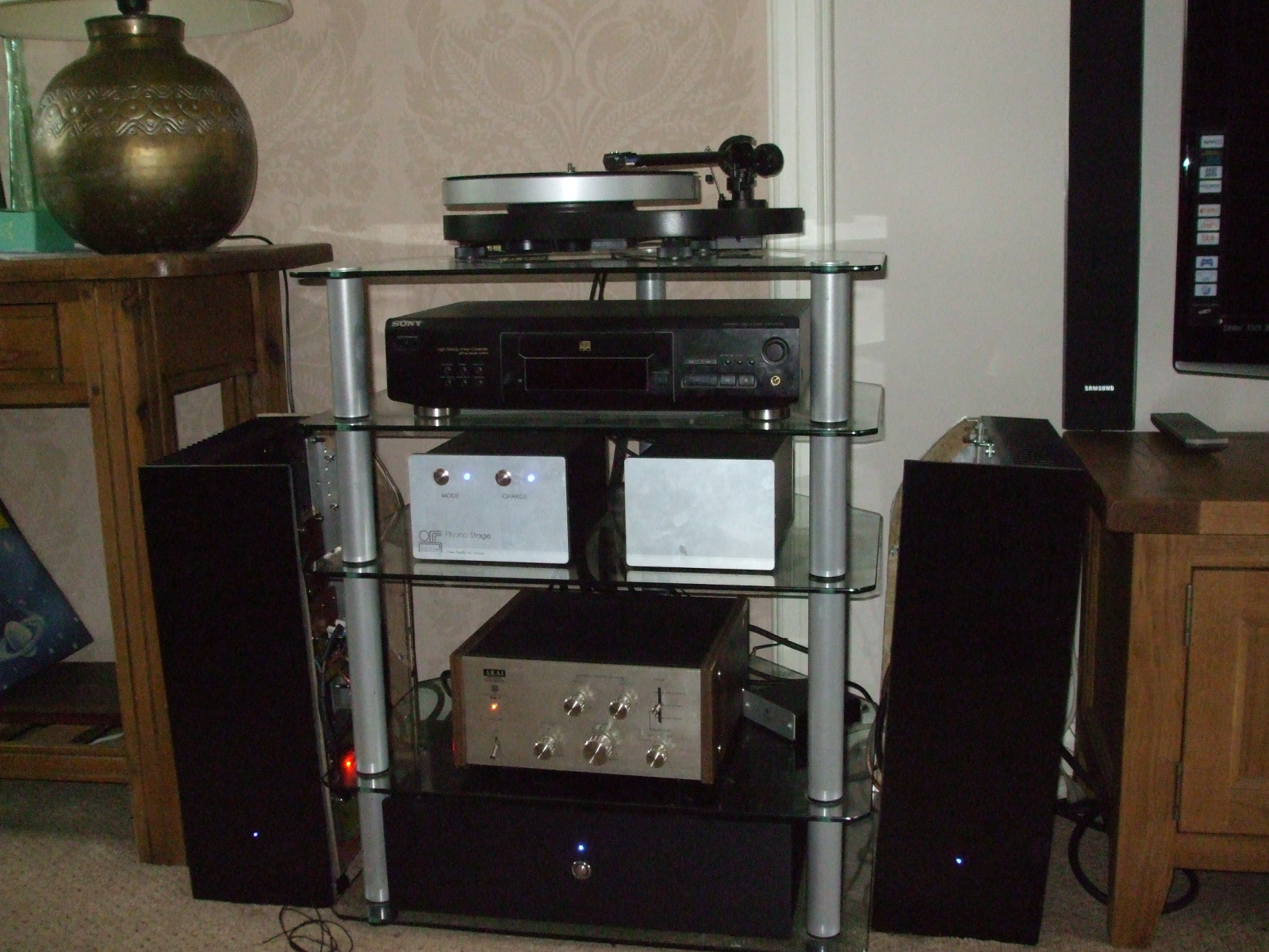

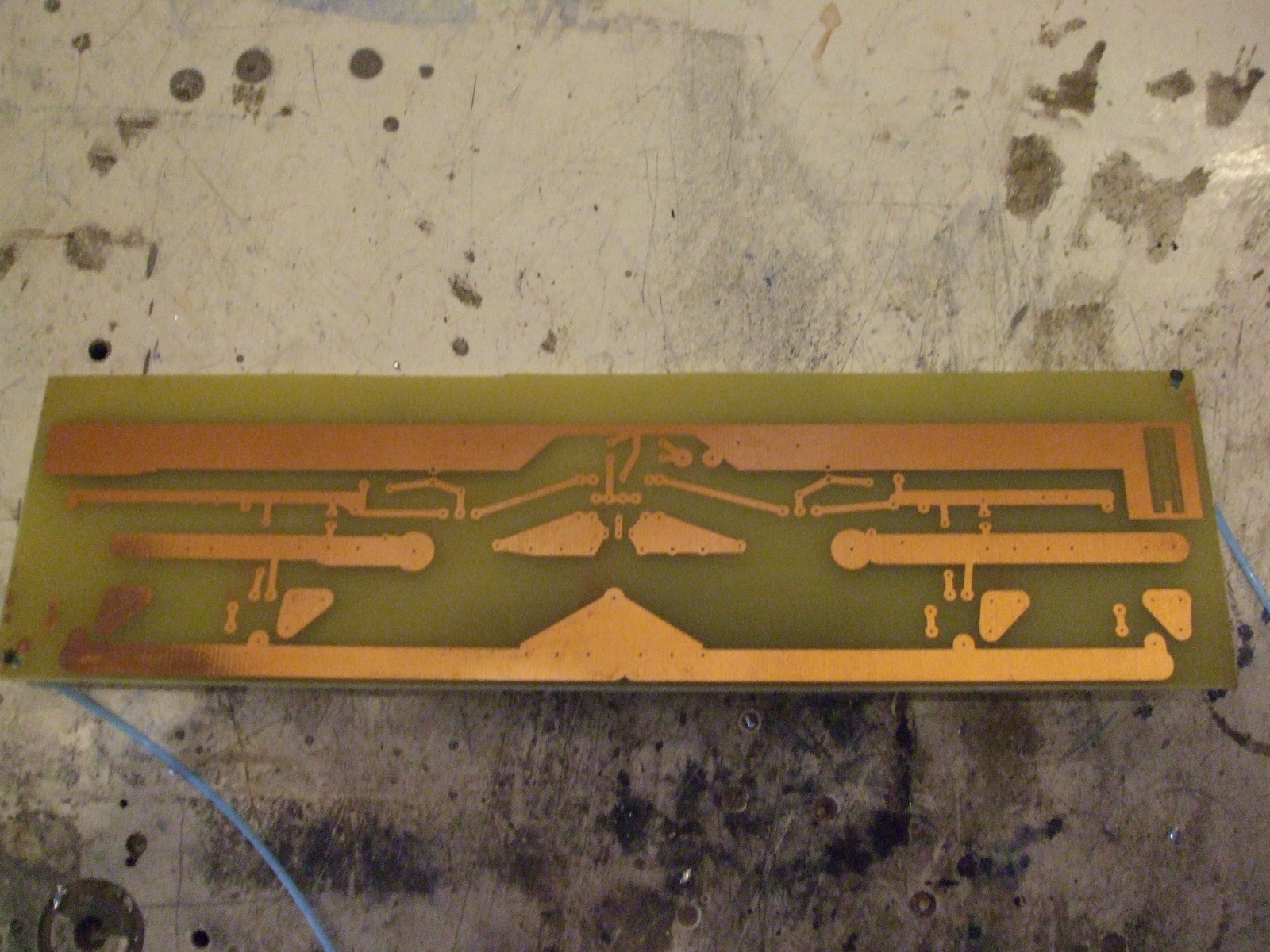

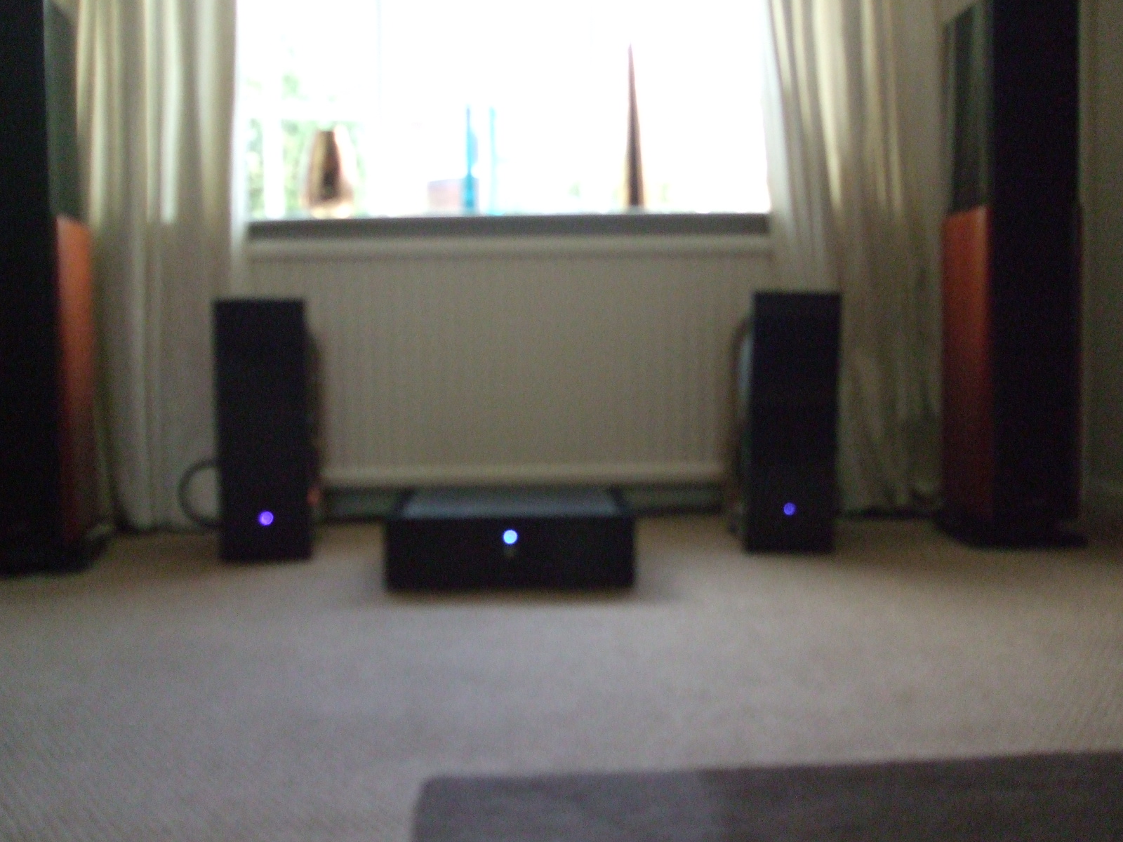

1 2 and 3 Pictures beter than million words The F5 mono block up and running picture 2 yes parallels no current limiter nothing fussy just bliss to the ears

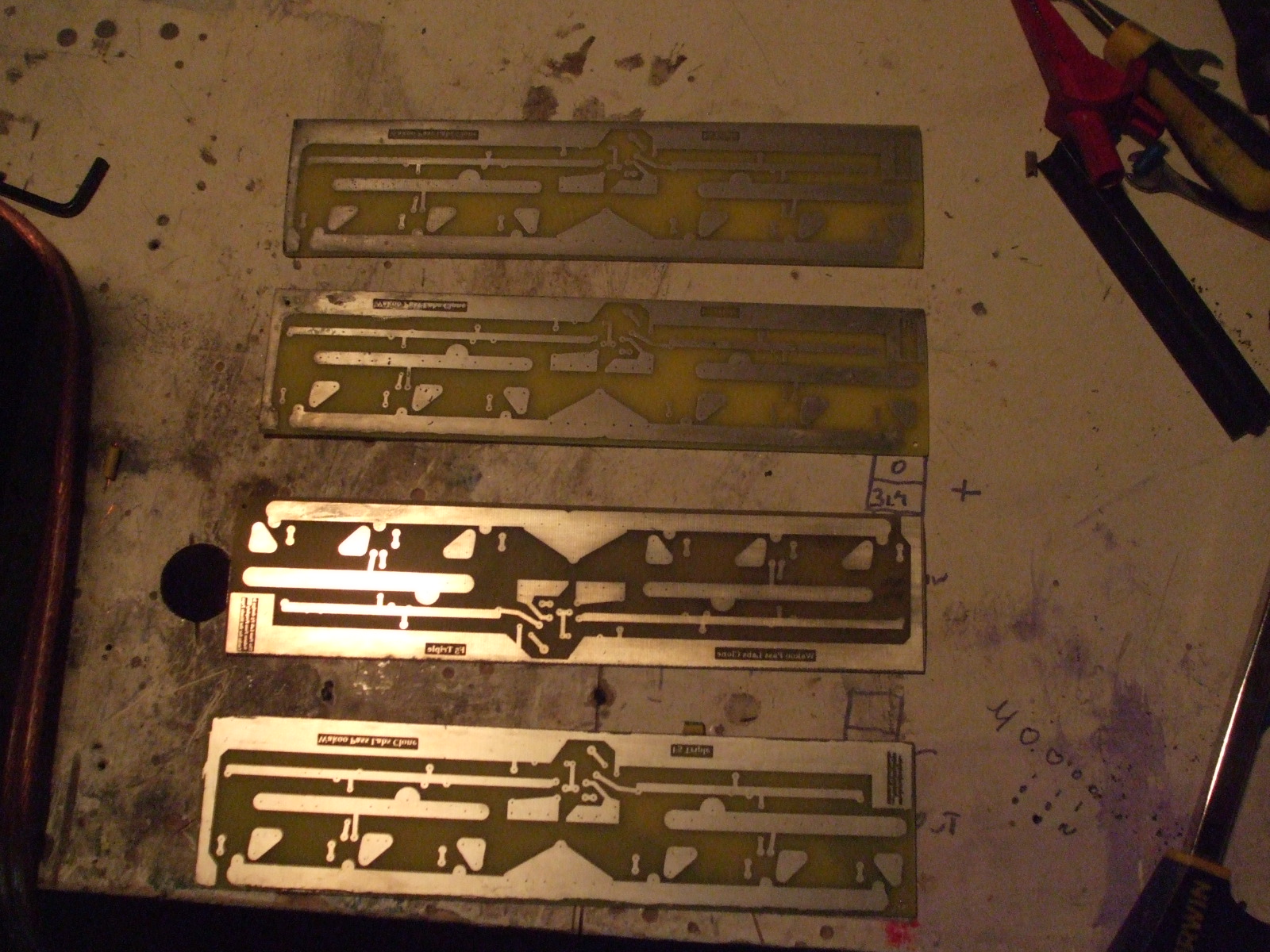

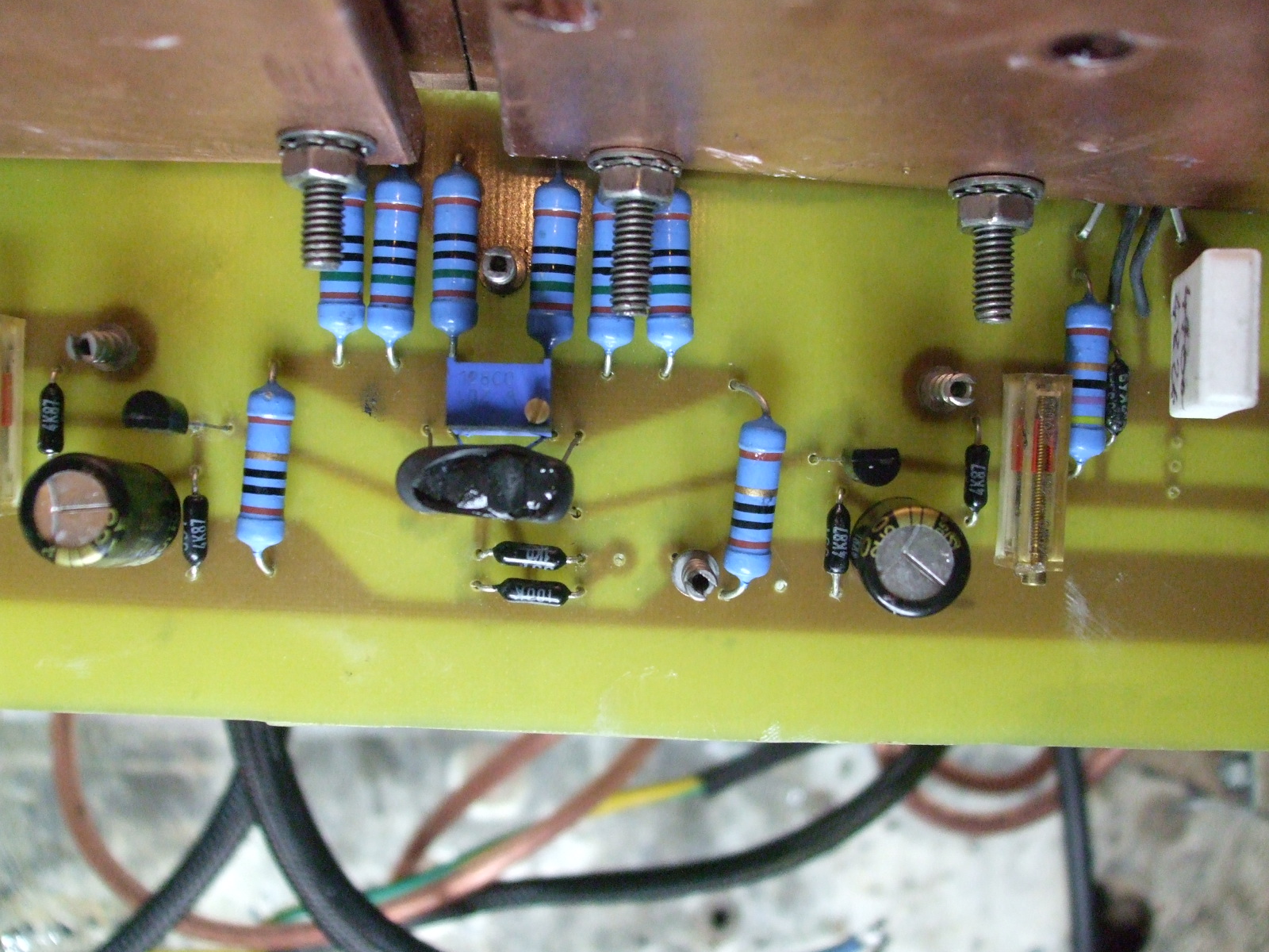

4 new batch of PCB for Fairchild trials.
Close up of same let me know if you need the proper drawing it’s free.
And yes-got room for triplets.
Protection NTE7100 board

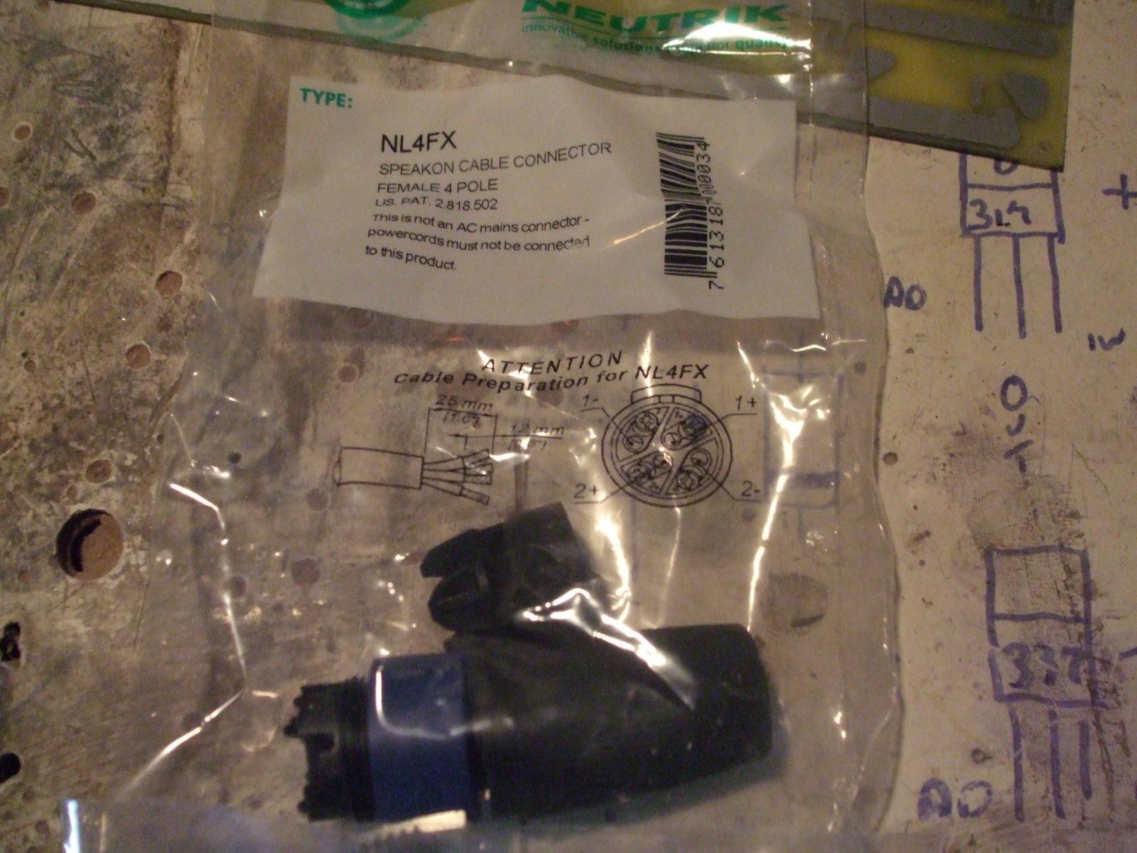

I got same 4 pole 30A connectors for the 15-foot cables from PSU
Did not feel like running same Ac on same cables to the NTE pin for power down speaker disconnect so a 100 K pot just to get the right voltage and relay open if Rail get below 22 V
No speaker thump (F5 got very little of it so do not worry)
And the connectors 30 A rated and £3 maybe 4 yes I know I can get lemos at 10 time the price but why bother after all for best un-compromised performance the cables soldered straight on the PCB with no breaks would perform better but be a bit less practical

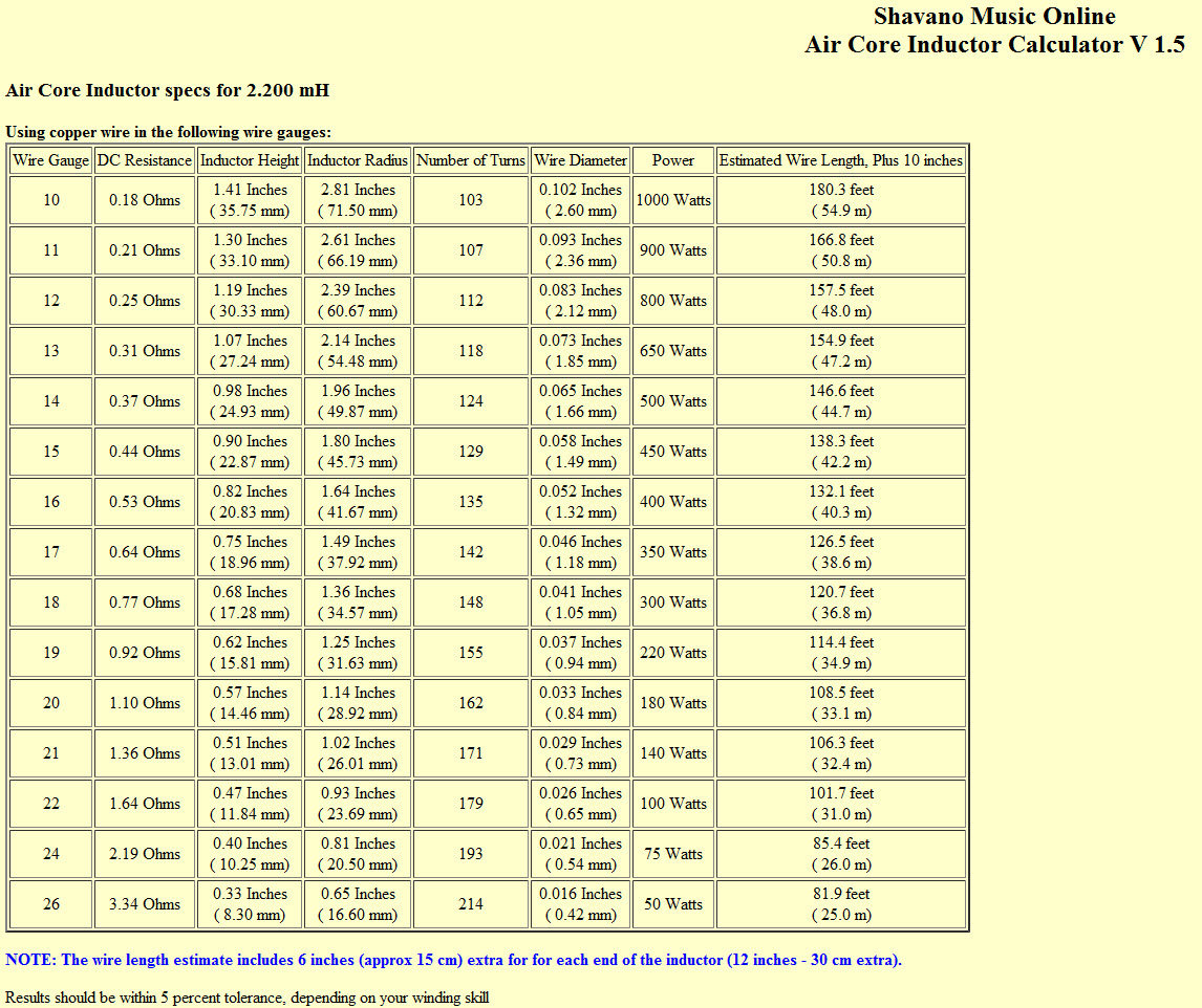

A bit about the inductors
I got the wrong wire and 1 a real pain to make pretty 2 it should have been about 150 foot long (2.2 target)
But I also have 2.5 mV of ripple and I am quite happy with that same of it from doggy pre and 15 foot cables.
No thermistors on the ground the signal in cable is connected to ground on the preamplifier and that is that
Inductor Designer / Calculator
Courtesy of Zen Mod post 773 Papa amp pictures tread
wires.co.uk : Enamelled Copper Wire
They sell wire by the Kilo at about £14 for the posh stuff
And nice handy table posted by CeeVee on post 774 Papa amps tread

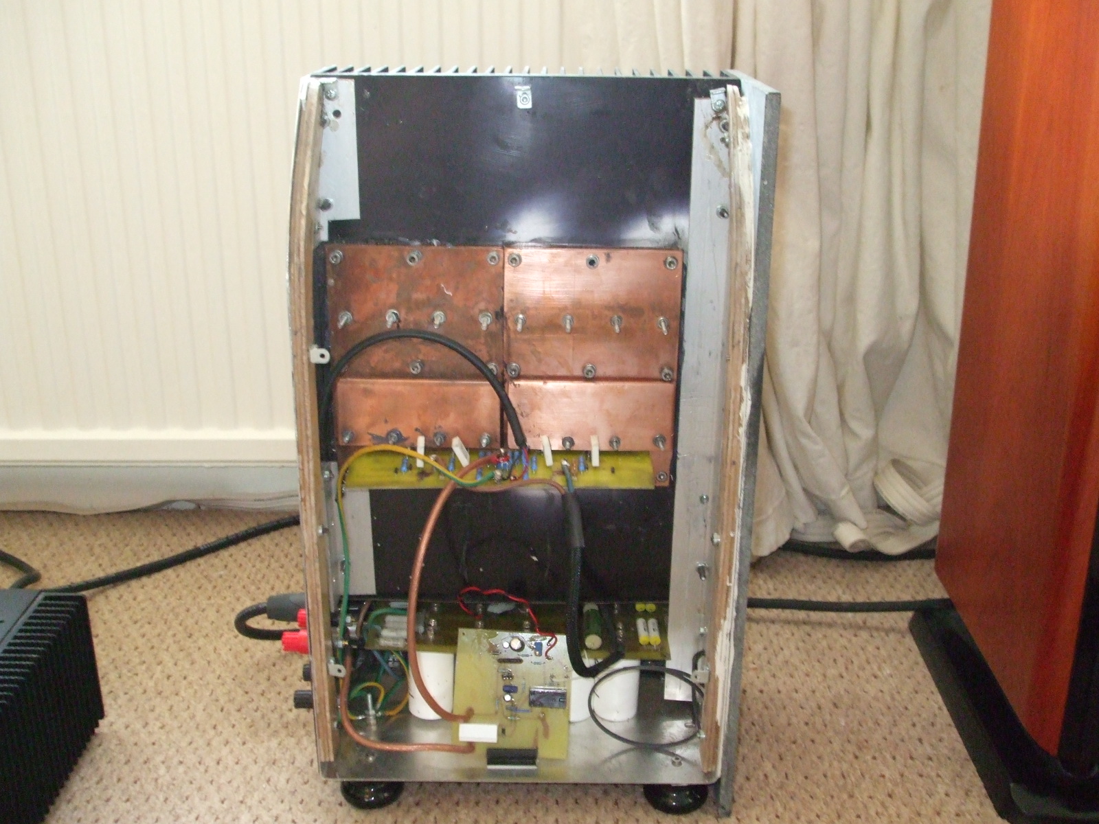

are you talking about chokes ?
I thought they could only be used with tube amps, and no good for higher current
or maybe it works because of the lower voltage
another thing with chokes, they seem to be exstremely sensitive to bigger supply caps
or maybe its like above, and I have misunderstood something
You may call them the right name I don't know
Just a kilo of copper wound up as in the picture just before the cables get out of the PSU and reach the last bunch of C in the "mono" Blocks
I supose that 2.2 mm diameter can do same preaty enough current
My mistake was to get 2 kilos of it while I probabably should have used 4 Kilos
Remind me of a comic book Flower shoop selling flowers by the kilo so me think is quite funny any way they are there and not doing any arm at least riplevise.
But now that you mention it I may shorth them out and have a listen.

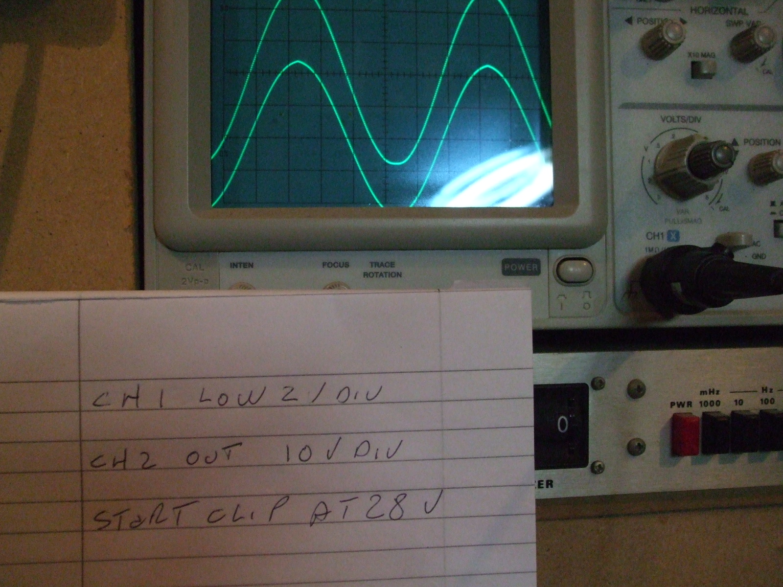

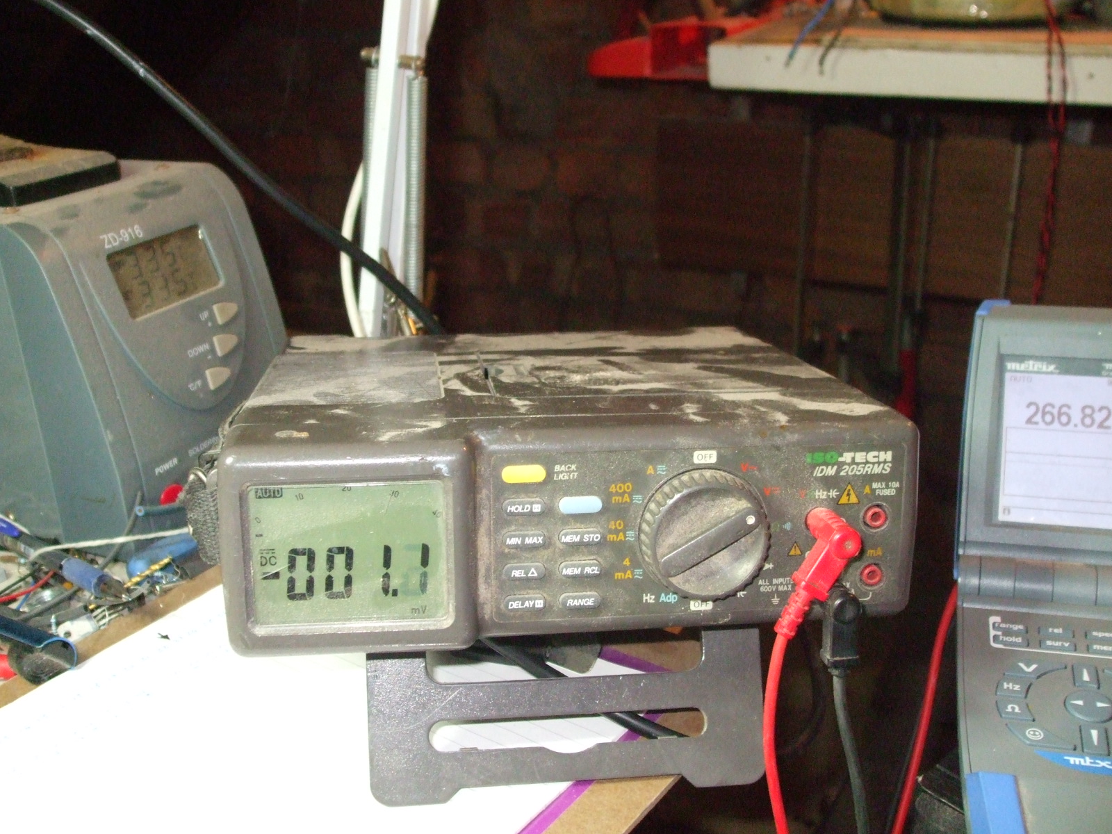

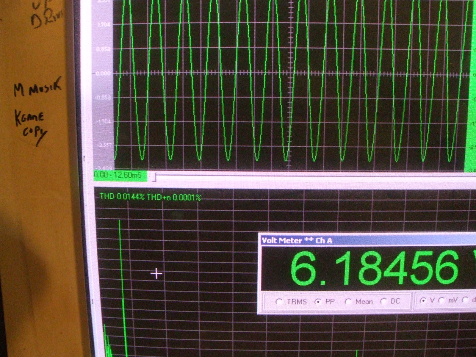

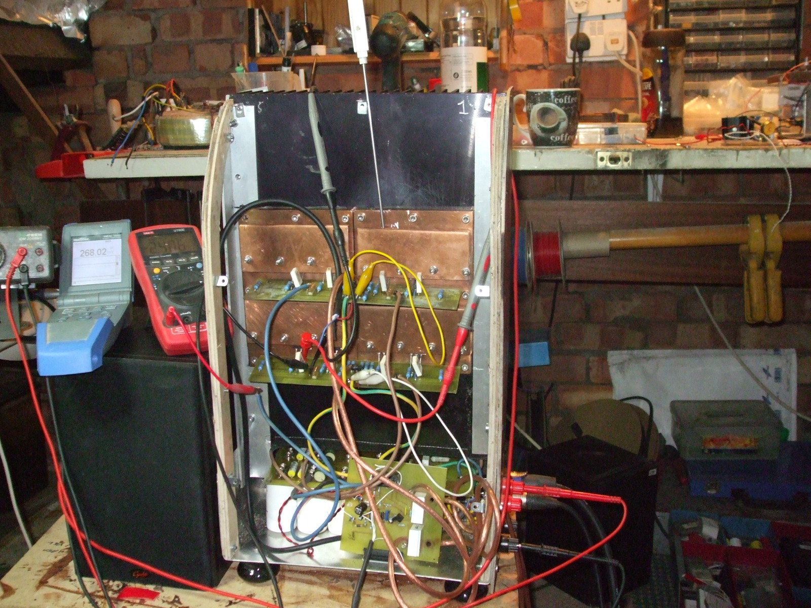

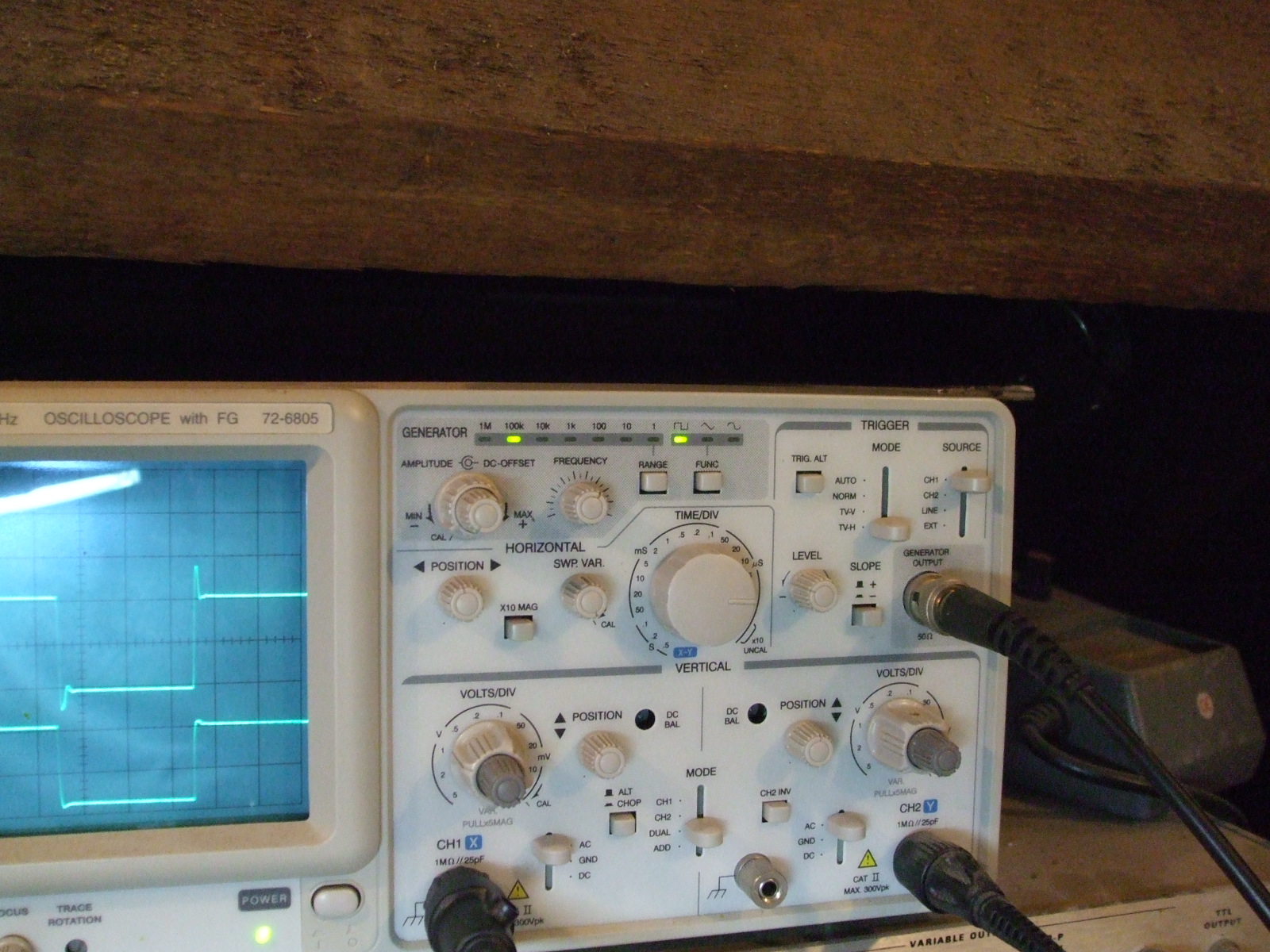

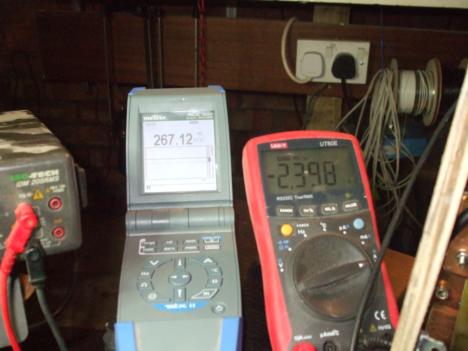

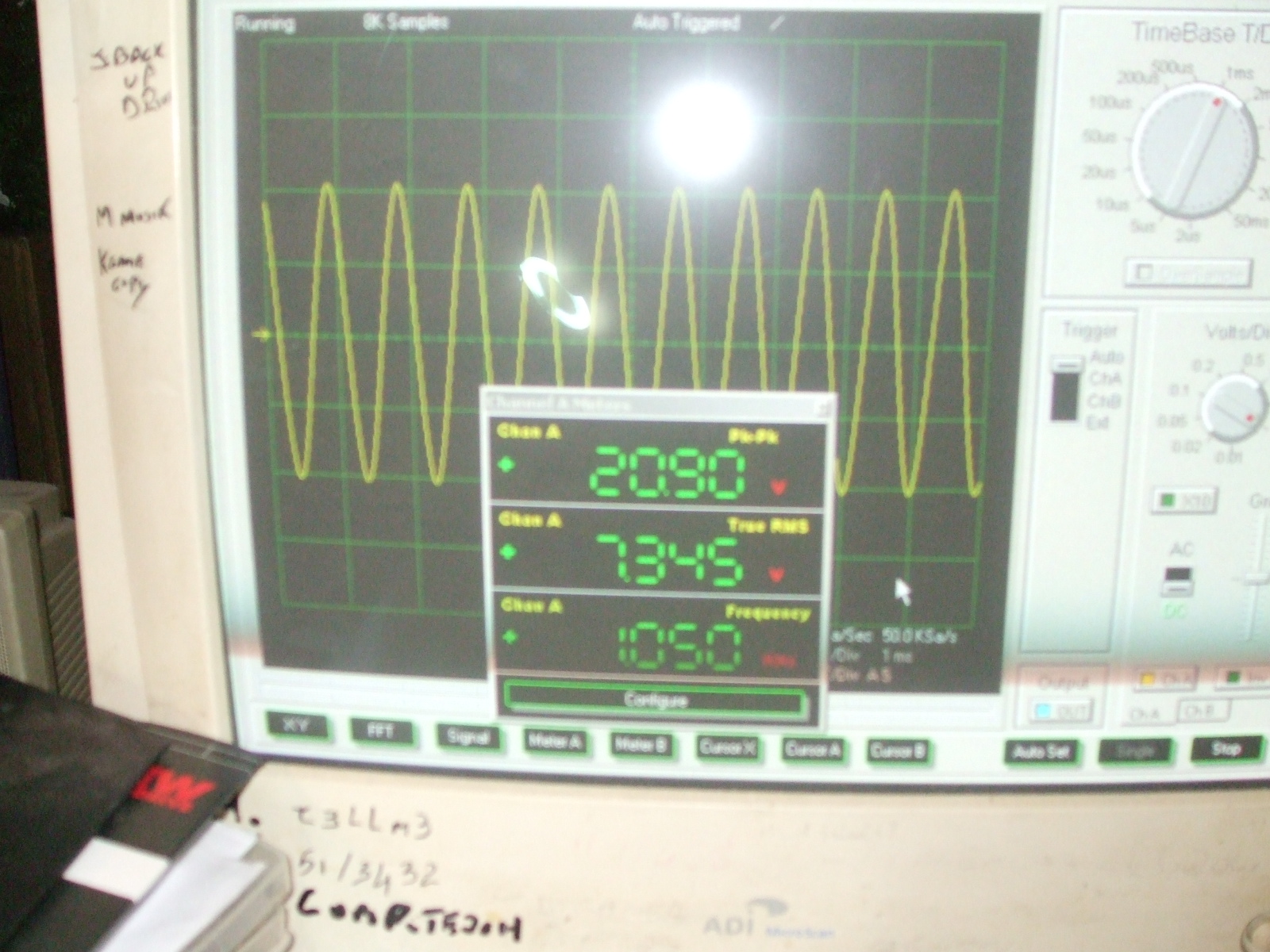

Well it looks like I need a couple of fans after all
The F5 playing along 20V peak 1Khz
Same set up but poor pictures to enclose THD 0.098
Will have to get back to that...
Same temperature measurement in the mean time
Top of the worst mosfet case 71.3 C
Copper heat spreaders 63.3
Heath sink 53.7
Worst possible positions (I will be only cheating myself)
I am quite happy with such a small difference between the 3
The effort invested in to the thermal coupling paid off.
I had a mosfet running a bit hotter but a "couple" more turns on the securing nuts cured that
Offset -1.1 mV
Vdrop across 1 of the 0.22 R 0.267
Current trough one supply rail 2.4 A~
Rails at 24.3 V (48.6 V total)
This is nearly a 2 V drop from the previous 26 V rails
2 factors causing this
1 Cable Run from PSU adding a bit more resistance
2 Capacitor bank (new RIFA) 50mF now supplying more current
Because I forgot to mention 2 channels now working on the same heath sink.
I will have a listen tomorrow to ear the difference that going down on current
1.2 A on each mosfet causes from the 2 A of the previous set up.
The restraining factor is the heath sinks, which are dissipating more or less as before 233 Watts
I may be able to gain same voltage back by increasing the Capacitors banks
So each channel has it own.
And maybe if sound quality is much worst try with single mosfets instead of the 2 parallel ones.

Hi Wayne
In those pictures from the
1 output of the USB Crapyscope (picture of the unclipped output)
2 The puter Audigi Audiophile 192 sound card
On main system
output form Roxan Kandy
or output from Akay SS1

Progress on my build has been slow but is getting there.
An the F5 is growing and evolving just see Papa mention P3.
I have given it a quick try but to quick a try to have much to say.
In the mean time my 2 mono blocks with separate suplly.
Still 2 parallel mosfet but with Fairchild this time all as F5 manual with no current limiters.
Speaker protection is there for a reason.
I am going to listen to them for a few days
Then fit on more "F5 board" and by Amp and then go balanced.
Maybe new PCB for cascoded Parralel Jfets and P3
Loads to do...

Got same mesuraments of one of the F5 monos
Rail at 31V 2.8 A 10 Homs resistor as load.
THD at 6 VPP 0.0144 eventualy I will learn how to use this new program and be able to post a screen shoot
PS is the Virtinis as in the ZRLC tread
4V PP in 36V PP out
First sign of clipping at -28V on negative rail.
Maybe mat is wrong but say no clipping at 26 V 52 VPP
52 X 52 / 10 = 270 W ????
Bias at 2.8 A so 5.6 X 10 shuld leve class A at 56 W
Plenty of room as 6 Volts is all I need In my room to be plenty loud

Newer mind got the new Board ready for drilling
If you need proper drawing let me know
Still 2 mosfets rail + Papa cascode maybe 2 parralel J fet and P3 ready

Power = Volts times Amps = Volts squared divided by Load resistance = Amps squared times Load resistance.
As formulae it looks like this
P = V*I = V^2/R = I^2*R where V and I are the rms values.
Convert your sinewave 52Vpp to Vpk by dividing by 2, gives output voltage = 26Vpk.
Convert the sinewave peak voltage to rms voltage by dividing by sqrt(2) gives output voltage = 18.38Vrms
Output Power = 33.8W, not 270W, nor
If we assume your 28Vpk indicates clip free at 27.9Vpk then maximum output power ~39W

One channel cascoded and 2 pairs of Jfets
tried P3 but couple of mosfets whent pooftsss so desist for now
At first listen between chanels more definition more pleasing Hi frequency bit less harshness even boss said one sound louder the other sound beter bit more melow.
Could not push things as neigbors and her in the house but really really pleased
I will not put numbers on it but on 4 homs speaker.
You can have a good look at my knobs and work it out probably beter than me
crappy scope signal generator square in not that good in chanel 1
Is now in living room plaing Bon Iovy boss likes it and I have penitence to make
PS pre is an old Akay SS1 for now
